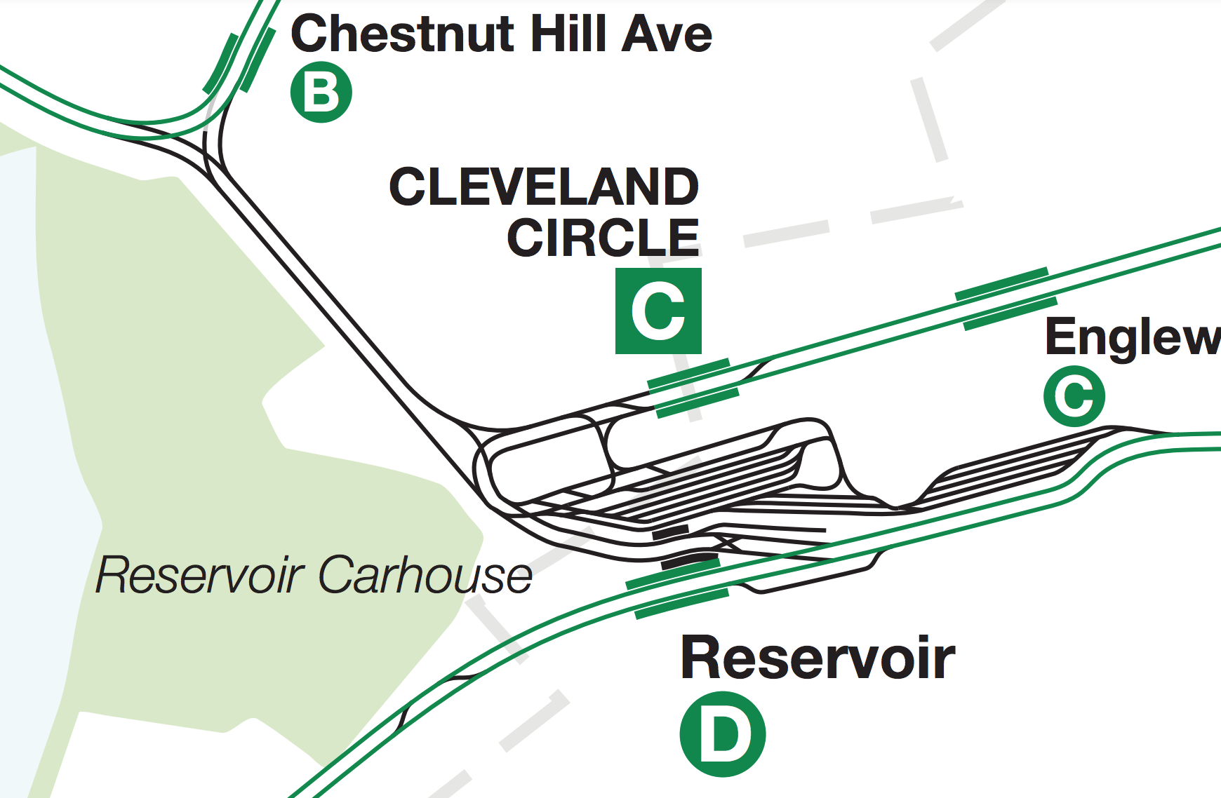

Looking at @vanshnookenraggen's track map, Riverside via Beacon feels like a difficult service to swing.
Traveling inbound, you'd need to pull out from the Reservoir platform, roll forward, and then reverse ends, divert over to the yard tracks and run "backwards" all the way in. Hardly impossible, but not super simple either. I also would not want to be the driver who has to get out in the middle of stormy weather to walk to the other end of the train.
Alternatively, you could run a pair of shuttle services: Riverside-Reservoir, and Reservoir-Beacon-Subway. Have Riverside trains terminate on the outbound platform, and have passengers do a cross-platform transfer to a waiting shuttle train on the southern yard platform (the one in black in the diagram above). That feels a bit more achievable, even if it's not a one-seat ride.
There are two questions that get raised here.
1) Can riders remain onboard while a driver changes ends? If not, then the one-seat reverse-move only works if you have a second driver.
2) (The bigger question) Are the yard tracks cleared for passenger/revenue service? If not, then it still might be worthwhile to short-turn Riverside-Reservoir services, but it'll be an obnoxious rider experience.
The shuttle service you've described is exactly the setup I'd imagined. Definitely the biggest obstacle are those couple dozen feet of yard trackage that might not be cleared for revenue use.
