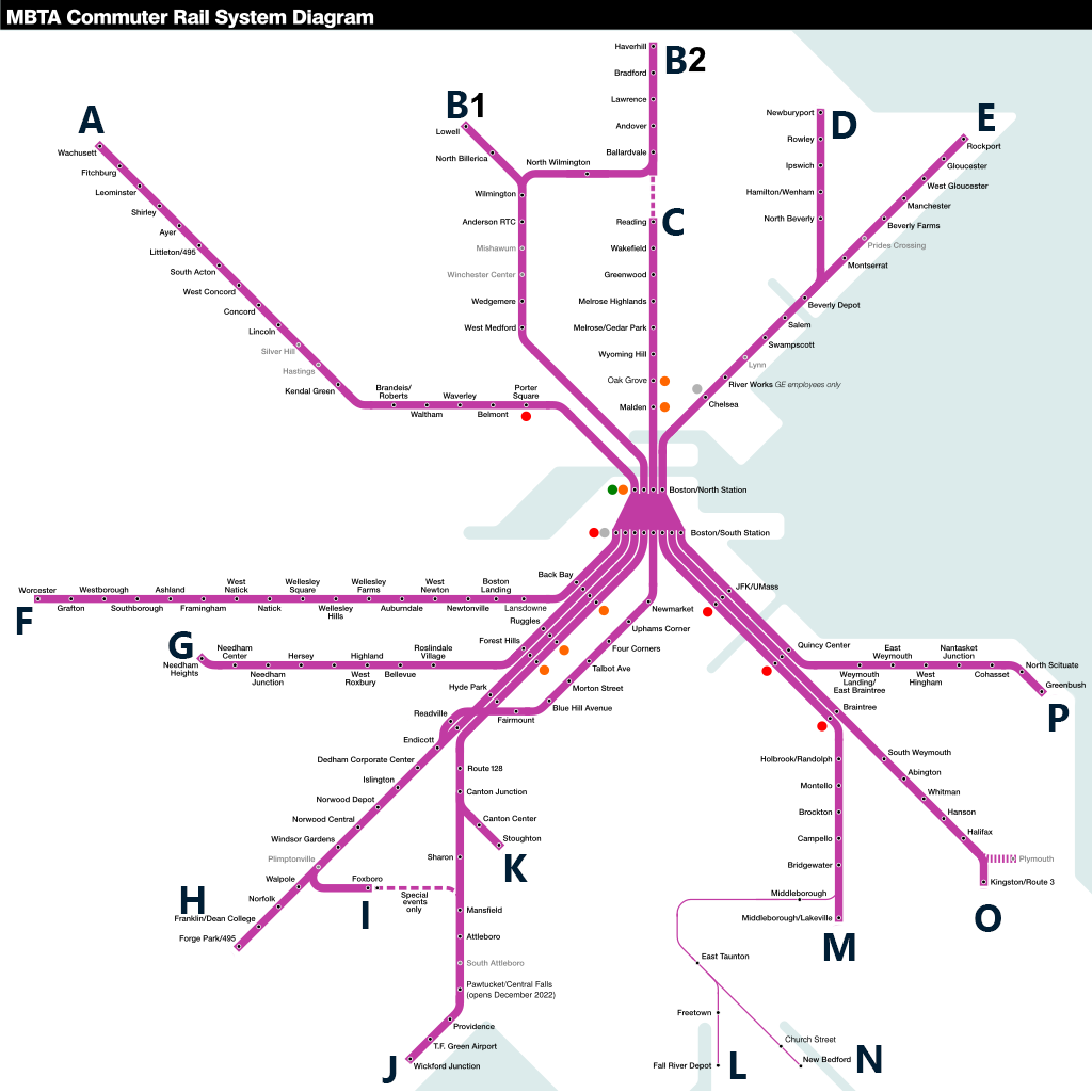

Reasonable Transit Pitches
Assuming the Needham Line still exists:
  • A-K, Wachusett/Littleton <—> Stoughton
  • B2-K, Haverhill <—> Stoughton
  • B1-J, Lowell <—> Providence/Wickford Junction
  • C-J, Reading <—> Providence/Wickford Junction
  • D-F, Newburyport/Beverly <—> Framingham/Worcester
  • E-F, Rockport/Beverly <—> Framingham/Worcester
  • G short turn, Beverly <—> Needham
  • H/I short turn, Salem <—> Foxboro/Franklin
  • L/M/N short turn, Woburn <—> Middleborough/Fall River/New Bedford
  • O/P short turn, Waltham (Route 128)/Porter <—> Kingston/Greenbush

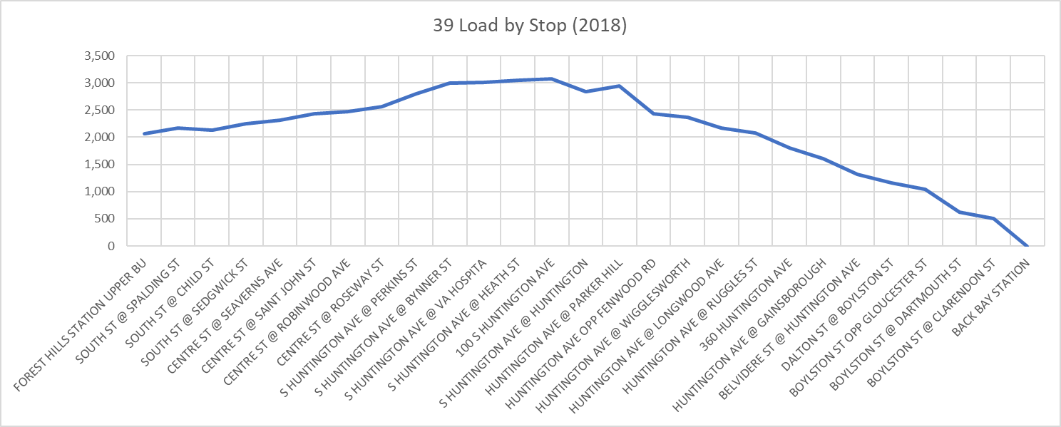

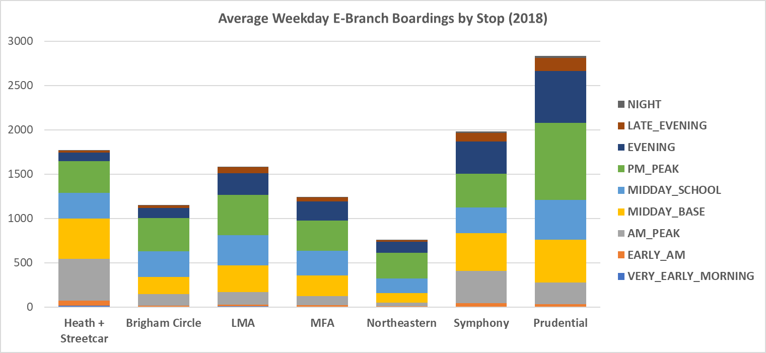

I pulled the 2018 data because I don't trust the 2019 numbers
The 39's ridership looks much more like a traditional radial bus, so if it was cut back, those passengers would mostly get on at (relatively) low ridership time. The real problem is that the PM Peak on the E is the highest point on the entire Green branch system:
One thing the Profile diagram doesn't illustrate that well is how the vast majority of passengers on the 39 have exited by the time it leaves Prudential. A huge number get off in the shared section of the E.
To be clear, I don't think the 39 should be truncated today. However, I think the main reason not to cut it back (or send it somewhere other than Back Bay/Copley) is that it fulfills too many OSRs, rather than being a significant capacity drag on the E.
As @Teban54 notes, big changes to the Huntington branch are needed to change the 39. I think the T39 -- sending the 39 somewhere other than Back Bay -- was a great idea but decades ahead of its time.
I would have never guessed Prudential and Symphony (especially the latter) would have more boardings than the LMA stops. Same for the streetcar section combined. Is ridership to LMA lower than I thought?
With the E's ridership profile diagrams in mind, that may not be too big of a problem. The E's PM peak ridership is more geared towards entering the Central Subway, whereas passengers riding the 39 back home would probably transfer from the E leaving the Central Subway.
Gotta admit, I had no idea Forest Hills would have this many boardings. 1/3 of all boardings, and 2/3 of peak number of passengers onboard. Although it does appear that this combines both AM peak and PM peak inbound trips (and all other times), so the 2180 boardings at Forest Hills also includes up to 900 that will alight in Jamaica Plain: these are probably PM riders transferring from OL.

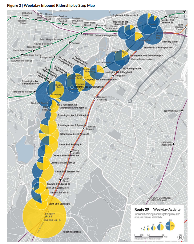

Here's the excerpt from the Better Bus Profile. I tried to analyze this (e.g. how many passengers alighting at LMA are from Forest Hills), but the combined data is too messy to be useful.
• Just over one third of all Route 39 inbound riders (2,180) board at Forest Hills Station. This is by far the highest boarding stop on the route (no other stop reaches 400 daily boardings).
• Both boardings and alightings are very high along South Street and Centre Street, with a total of 1,440 boardings and 900 alightings.
• A total of 870 passengers board and 360 alight along South Huntington Avenue. The VA Hospital stop along this section is one of Route 39’s lowest ridership stops.
• Ridership activity increases along Huntington Avenue. The two stops before the Longwood Medical area serve 510 boardings and 670 alightings.
• The three stops that serve the Longwood Medical Area serve a total of 620 boardings and 1,420 alightings. The highest ridership stop is Huntington Avenue at Fenwood Avenue, which is the stop closest to the Brigham and Women’s Hospital complex off of Francis Street (190 boardings and 730 alightings).
• A total of 210 passengers board and 760 alight at the remaining three stops on Huntington Avenue, two of which serve Northeastern University.
• A total of 70 passengers board and 350 alight on the jog over to Boylston Street via Belvidere Street and Dalton Street.
• A total of 52 passengers board and 310 alight at the two stops on Boylston Street before Copley Station.
• 30 passengers board and 480 alight at Boylston Street at Dartmouth Street, which is the stop closest to Copley Station.
• 510 passengers alight at the final stop at Back Bay Station.
@737900er Great data, thanks!
A lot of transit commuters to LMA use the MASCO shuttle, so would not show up on the LMA area E boardings.
