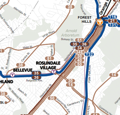

I'd also add OLX to Roslindale to the list. The Roslindale Village-Forest Hills segment is overserved, and not having to run all the bus routes on the southwest side to Forest Hills could provide room for network rationalization.
One of the biggest bang-for-buck projects in terms of concrete has to be Newton Corner and a second West Newton platform. Just building the stations and running diesel trains every 15 minutes at peak could kill the 501/504 (which pretty much overlap the 57, although the 501 works in a strange way) and cut back the 505 to West Newton. Even under BNRD 501, 504, and 505 are planned to be operated every 15 minutes at peak.
I'd also add OLX to Roslindale to the list. The Roslindale Village-Forest Hills segment is overserved, and not having to run all the bus routes on the southwest side could provide room for network rationalization.
