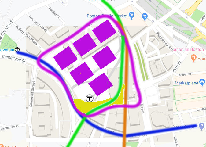

Very interesting massing. However, there's lots of shallow tunnels under the plaza, not just the main green line extending on towards Haymarket, but the Brattle Loop too. Putting towers there would be nearly as daunting as over the Pike.
Whenever I play the mental game of "fill in the plaza with buildings" I think it's worth trying to skirt the tunnels. The resultant new streetscape would reveal the Brattle Loop and main Green Line branch for all to see, and would avoid some serious unnecessary foundation costs.
^^Fantastic posts. No one wanted to steal his thunder and start talking about trusses, but maybe arches would support a great public space below something very tall.... if you incorporate 1-3 Center Plaza, there's a great opportunity to build a significant modernistic/deco to match the area, and step up for a couple of skyscrapers rising above a new Scollay Square.

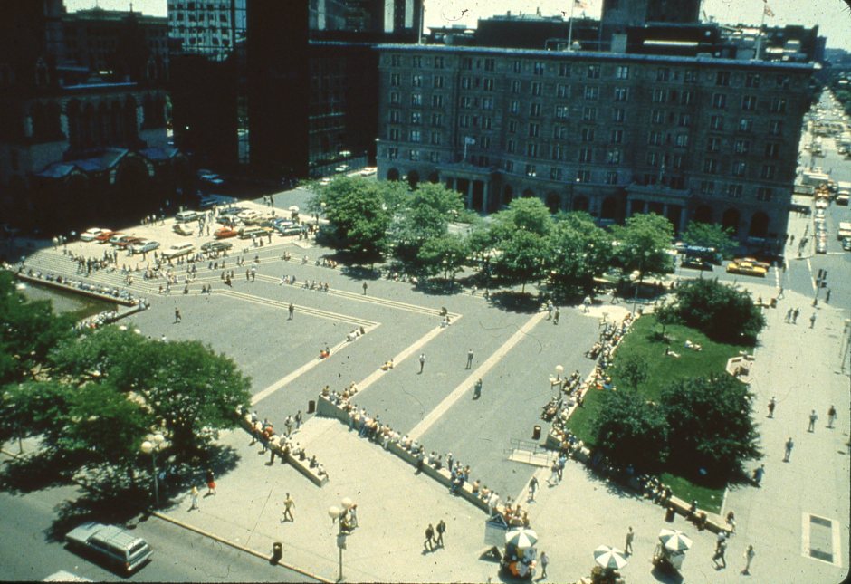

I can't believe that I only recently learned about the Copley Square of the 1960s - converted into a hideous concrete plaza of levels, and a mistake thankfully undone:
View attachment 8914View attachment 8915
I see a lot of parallels to City Hall Plaza. I'm sure the designers of this lovely centerpiece of urban life were well-educated architects too.

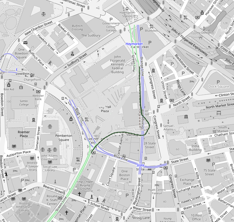

But looking at OpenRailwayMap, I wanted to go one step further. This is partially Crazy Transit, but I think fits well into a discussion of how to redevelop Gov't Center. Here are the Plaza tunnels as they currently exist, and then with demolition of the active GL tunnels:
View attachment 8916->View attachment 8917

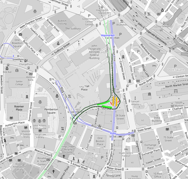

Tie the Green Line Northbound into the abandoned tunnel where it forks South of the Sears Crescent, and then build a new southbound tunnel parallel to the existing ones, running back up "Cornhill". This keeps the rail ROW on the pedestrian throughway and parallel to the OL, minimizing the footprint:
View attachment 8918->View attachment 8920

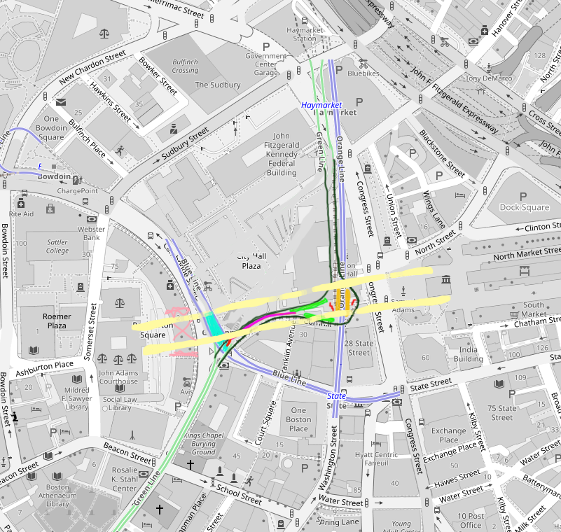

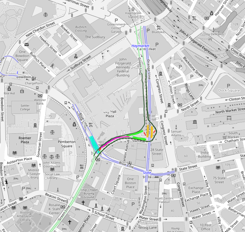

As the GL and OL are on two different levels, you can construct a new station closer to Congress Street within the "bulb" of the new GL loop, with platforms oriented as outlined here (red lines indicate stairs/elevators from the upper GL level to the lower OL level):
To tie into the existing BL platforms, you could construct a pedestrian walkway as part of the new Southbound GL tunnel that descends to the BL grade. Conceptually, I also really love the idea of opening up a sightline from the courthouse to Faneuil Hall via this corridor, which means opening up a part of Center Plaza as outlined. You could design the headhouse for this realigned station to have stunning sightlines of emerging from the ground to see one to the West and the other to the East:
View attachment 8922->View attachment 8923
This was a proposal that never actually happened. Nothing to undo.
