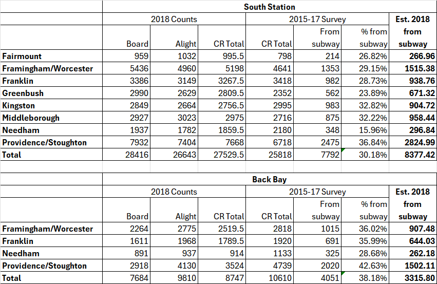

That's a great point! There are two ways of accounting for CR transfers:
  1. Use the 2015-17 Passenger Survey to get the number of subway riders at Back Bay, Copley and South Station who came from commuter rail.
  2. Use the 2018 Commuter Rail ridership counts to get total commuter rail ridership at these stations, then use the 2015-17 Passenger Survey to estimate the percentage of CR riders that transferred from rapid transit.
Granted, both are pre-Covid data which differ significantly from today's commuter rail ridership patterns, and neither account for Amtrak - but that's the best we can do.
StationBack BayCopleySouth Station (RL only)
Fall 2024 weekday ridership *10493995515901
Fall 2019 weekday ridership *167271389927214
(Method 1) Number of riders from CR, 2015-17 **5358, 34.4%1050, 8.4%10170, 34.6%
(Method 1) "Pure rapid transit" riders, Fall 2019
(Simple subtraction)
113691284917044
(Applies 2015-17 percentage to 2019 ridership)
109771273417792
(Method 1) "Pure rapid transit" riders, Fall 2024
(Applies 2015-17 percentage to 2024 ridership)
6886912110396
(Method 2) Total CR ridership, 2018 *8747N/A27530
(Method 2) Number of CR riders from subway, 2018 (see spoiler)3316N/A8377
(Method 2) "Pure rapid transit" riders, Fall 2019
(Simple subtraction of 2018 numbers)
13411N/A (13899)18837
(Method 2) "Pure rapid transit" riders, Fall 2024
(Applies 2019 % of pure riders to 2024 ridership)
8413N/A (9955)11006
* Average between boardings and alightings. South Station figures include transfers from Silver Line SL1/2/3. (Note that Back Bay has much more alightings than boardings in 2024, and South Station has more alightings than boardings in 2019.)
** Percentages are computed as (CR transfers) / (accessing the station as first MBTA mode + bus/SL transfers + rapid transit transfers + CR transfers).

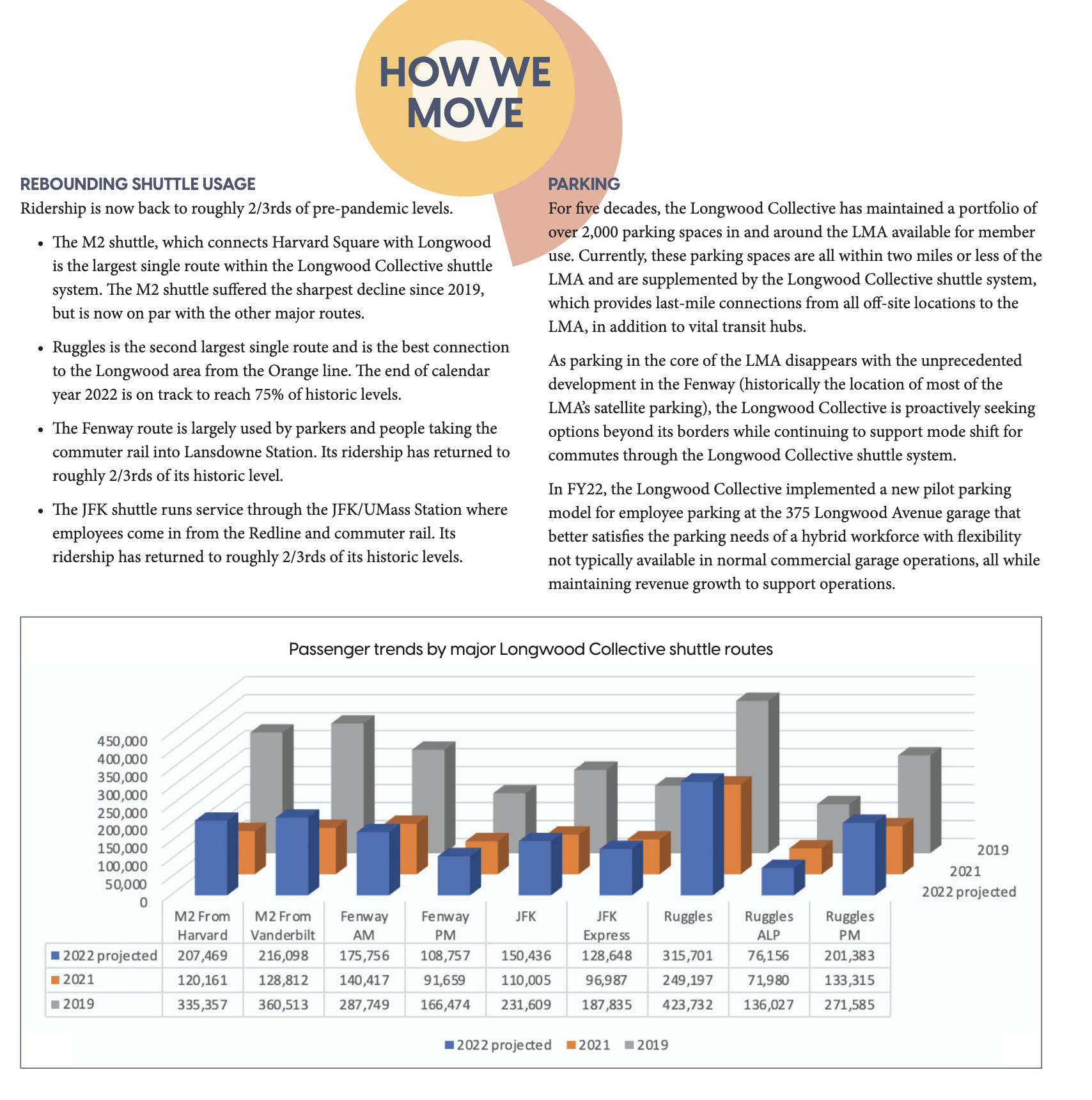

Here's an excerpt of Longwood Collective's data from around 2022 with pre/post pandemic ridership. There's probably better data somewhere else but this is a starting-point. (From "Longwood Collective Annual Report FY22")
It also has a blurb about specific routes, like the Fenway route being used by people who park / come from landsdowne CR stop for example.

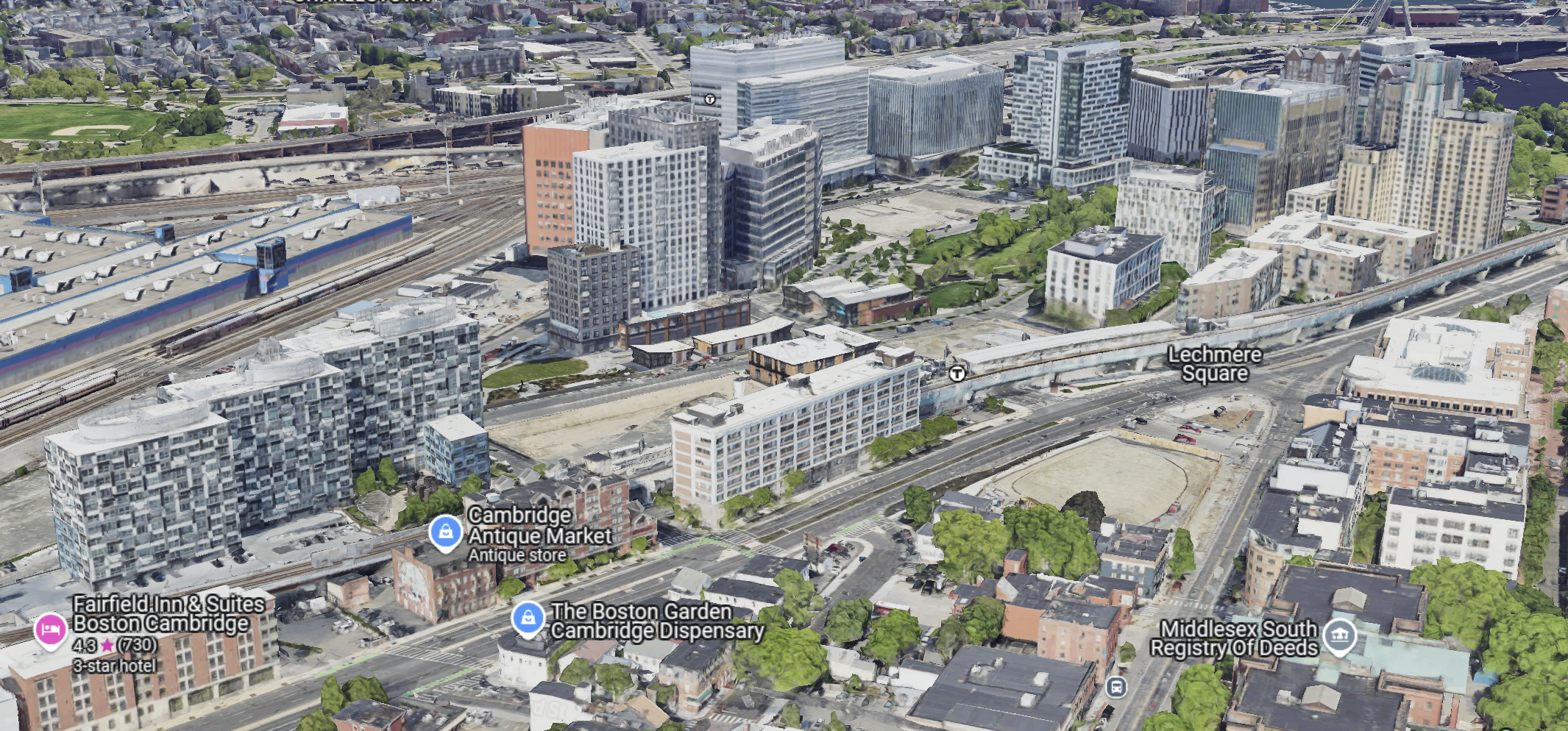

I like brown, but it is dumping more service to Lechmere, which is not dense and has almost no businesses. I almost wonder if it should jog north, but I don't know exactly where it would go. Maybe closer to Inman.
Honestly I think it should just join the Grand Junction.
I strongly disagree. Most of the screenshot below show the Cambridge Crossing developments just northeast of Lechmere station; a few others are apartment buildings to the west.

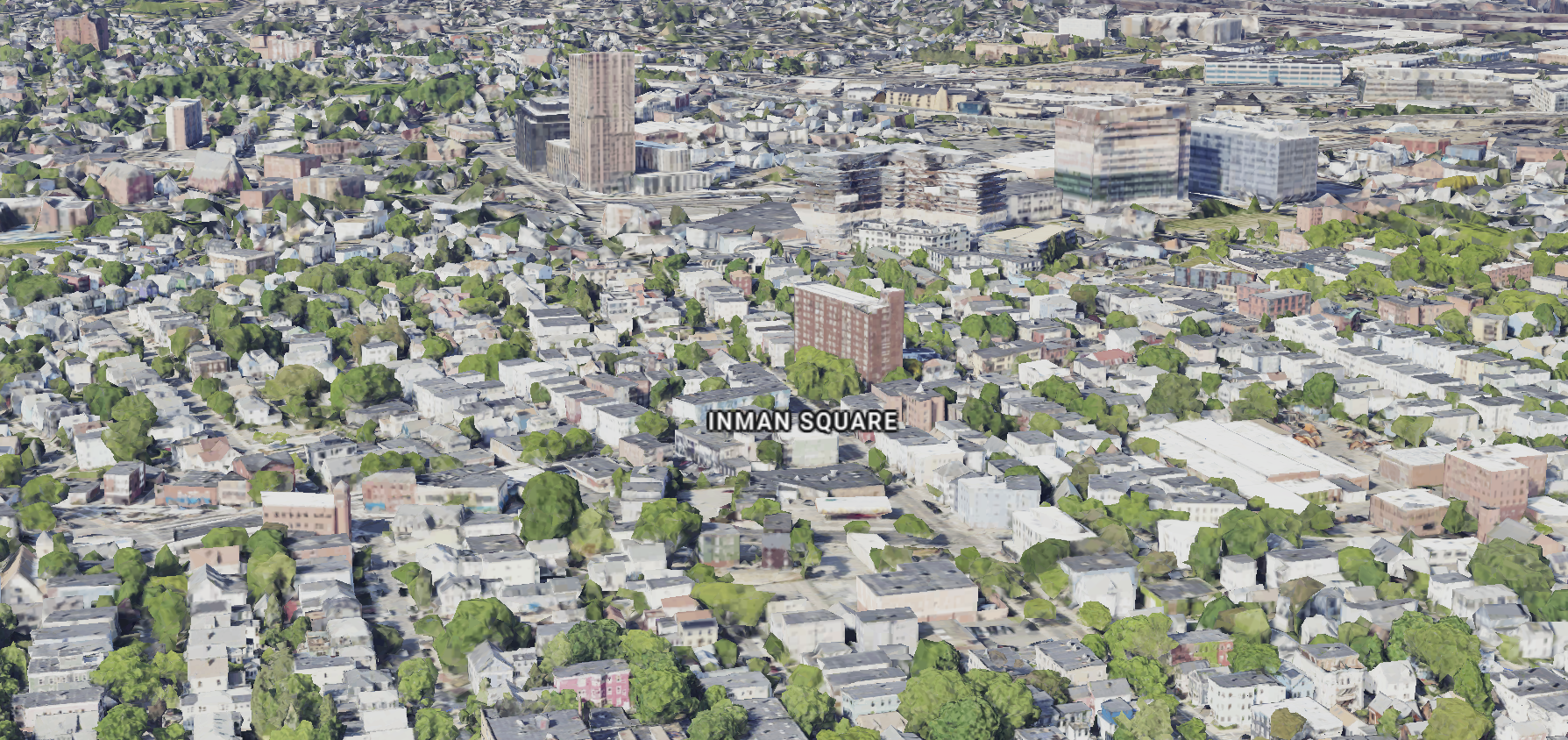

In comparison, here's the entire area from Inman Square (bottom) to Union Square Somerville (top):
The Cambridge Crossing website shows several companies setting up offices there. So while I'm not sure why the area has unimpressive figures in residents and jobs in the 2020 census or the latest LODES data, I still think there's strong potential from the developments there.
Almost all the buildings in that photo of Inman are dense lowrise multifamily, one of the densest housing types we have in Boston. I agree it would be great they built more than one apartment building at CX. The problem is that they built labs and a park... and the labs might not be fully leased. Red X shows parcels within a few blocks that don't have an appreciable number of people living at them. And this is borne out in what businesses see for demand--the only business lechmere ""square"" supports is a citizen's bank.
Yes it's cool that CX has a Tatte. I think that the development is flawed but great for Cambridge. But I don't really think it deserves it the way other neighborhoods do.
There is definitely development around Lechmere. It's just that said development is already very well served by the GL and OL, and would seemingly require 1 mile of extra subway as opposed to .5 miles of elevated if you want to both hit Cambridge Crossing, and have a transfer to the GL at Lechmere.

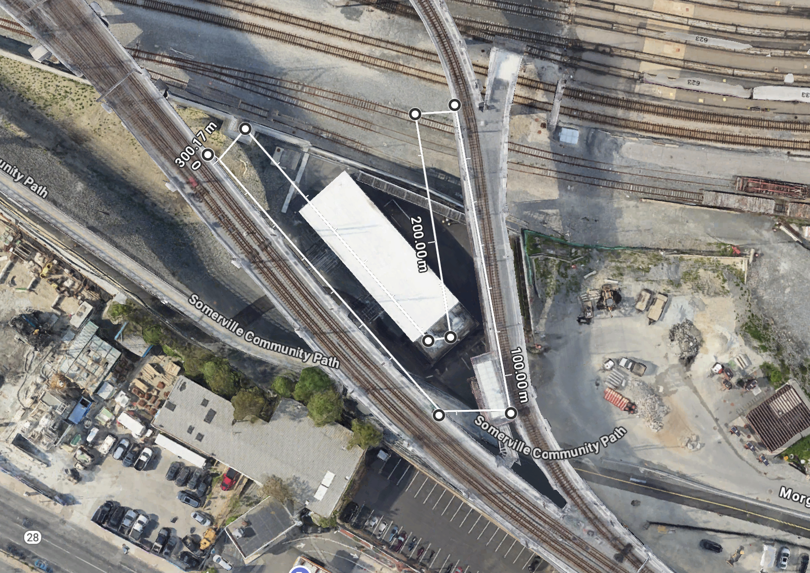

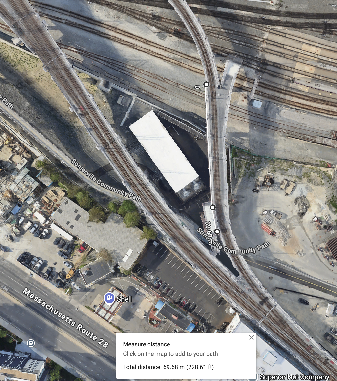

A GLX infill at the flying junction that you labeled is likely infeasible for a few reasons:
  • Any Green Line platform will need 225' of length for two Type 10 cars. The westbound Union Square ramp only has 160', and that includes the unbuilt ramp NE to GLMF.
  • There seems to be a series of elevation changes on both "lines" (the Medford branch main line and the westbound Union Square ramp), although it's hard to see the exact elevation changes from Google Maps.
A much more realistic way to connect to the D/E branches west of Lechmere (with a Lowell Line transfer as a bonus) has already been discussed on this board several times before -- the "East Somerville alignment". This comment from @Riverside, and the chains of comments before/after, illustrate the alignment pretty well:
You need a slightly curved platform but this part is not a problem. I don't see anything in the design standards which would prohibit this.

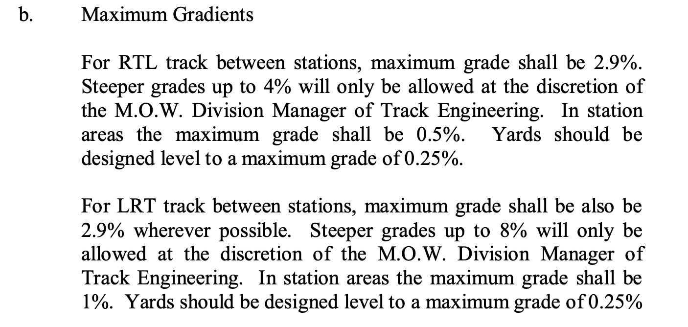

As long as the grade doesn't exceed 1% it's fine. I can't tell if that's the case but it does not look particularly steep.
The Lowell Line station is a nice bonus but if you do a Charlestown/Chelsea branch with a station at Community College, you can also have CR interchange for all the Northside lines there.

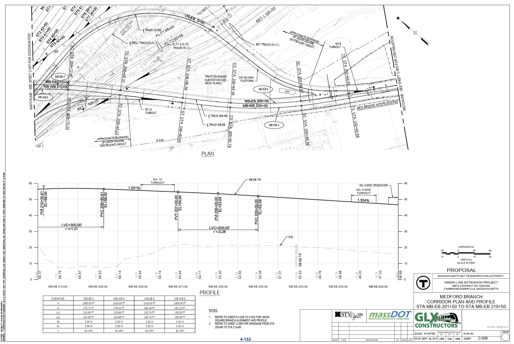

According to the GLX Technical Proposal (document page 4-152, PDF page 12), looks like the grades are:
  • 1.554% at the "No. 6 turnout", where outbound Union Sq branch splits from the Medford/Tufts "mainline"
  • 1.001% at the "No. 10 turnout", where inbound Union Sq branch joins the Medford/Tufts "mainline"
  • The figure doesn't show the precise figures for intermediate sections, but the track looks concave, so the grades are presumably between 1.001% and 1.554%
Given that the entire platform in your idea would lie between the two turnouts, they will likely face grades steeper than 1.001%, thus killing the proposal.
From the same document, the Union Sq platform would be on a section with a gradient of approximately 0.5% so that side is totally fine. But you're right that the Medford side is steeper than 1%.

My three main issues for me with the idea of a Community College mega station are
1. It's not all that far from North Station or enough of a center to warrant a CR stop to me. As you mentioned, it's flanked by a highway, which limits its development potential so it's probably not going to be much of a center. Placing a major transfer point so close to North Station feels redundant to me.
2. There are a lot of tracks through here connecting Fitchburg, Lowell, the Maintenance Facility, and the yard. Presumably, you'd have to simplify some of the track layout. How much flexibility are you giving up by building platforms right at the end (maybe beginning?) of all the interchanges?
3. If we see NSRL as a long term goal, an underground stop here would be incredibly expensive/ impossible, whereas infills at Sullivan and East Somerville (maybe somewhere near Union Sq. too?) fits in perfectly fine with that future reality and allows for transfers.

In an NSRL world, Community College would not only be underground, but also along the northern portals:
The NSRL slides mention a maximum allowable grade of 3%. TL;DR: I played around with the numbers, and the original portal locations above may still work -- even with 800' level platforms, they don't seem to have steeper grades than the Back Bay - South Station grades in the same presentation. But given that the Back Bay portal in the slides has a grade of 3.65%, something seems fishy to begin with. (Perhaps I didn't subtract the depth of the tunnel itself?)
Still, this is already a complex area between the egress, branches, possible flying junctions for the branches, etc. Not only do additional engineering concerns have potential to worsen feasibility, but the added cost -- especially for another underground CR station (even though this one is much more feasible for C&C than the downtown stations) -- raises the question of whether it can win in a cost-benefit analysis against 3 surface CR stations (Twin City Plaza, East Somerville, Sullivan Sq).

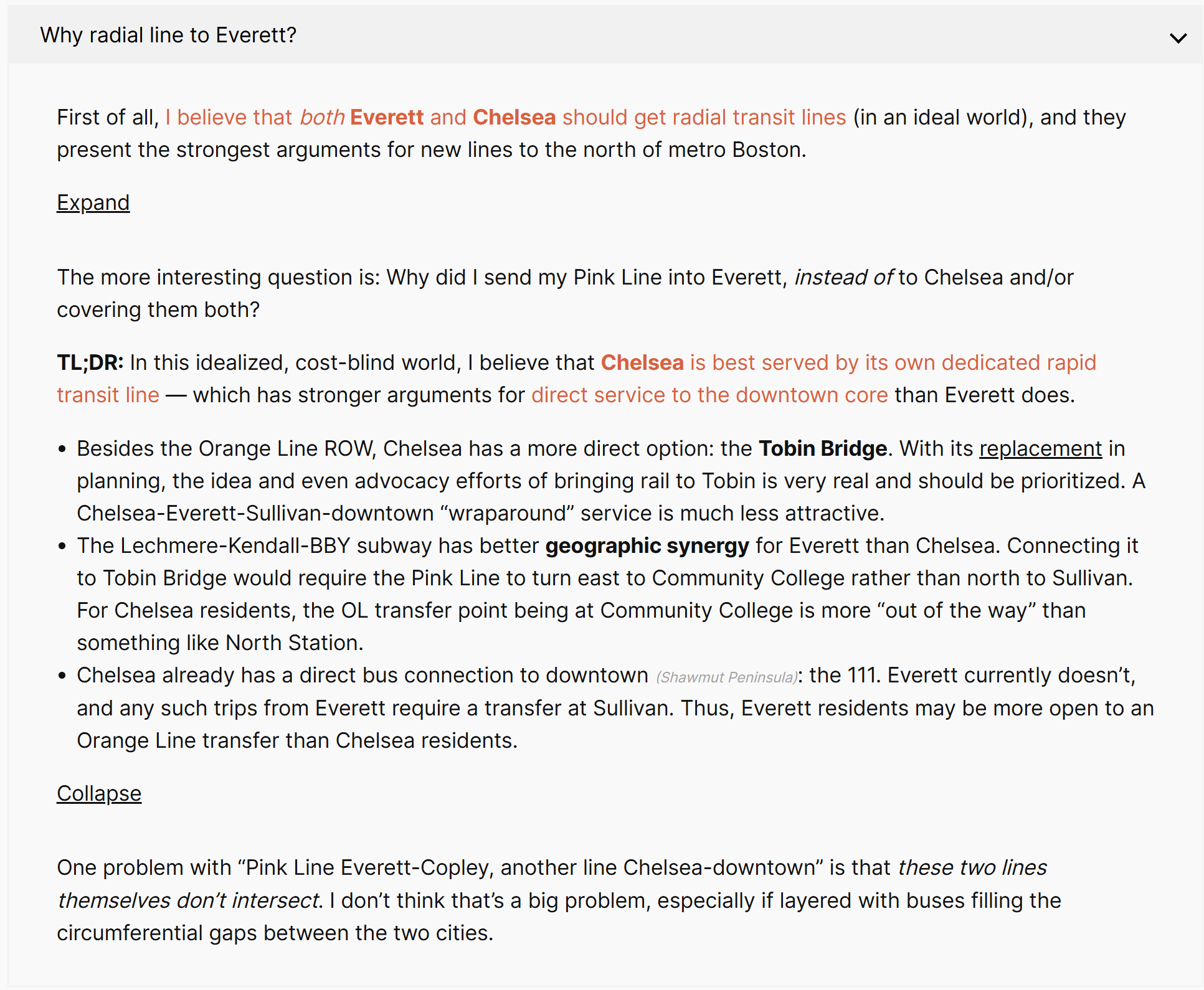

Chelsea vs. Everett: The radial end of a "tangential" Urban Ring line
Most of this had been explained in my Kendall-Back Bay post, specifically the "Why radial line to Everett?" dropdown box:
A few additional points:
  • Don't forget, a Tobin Bridge line can still serve as a radial line to both Everett and Chelsea, just with a more zigzag route.
  • A Chelsea-downtown route doesn't necessarily need a new downtown subway (although it would be nice to have). The most realistic solution IMO is actually a Green Line branch from North Station. (Note that the Tobin Bridge is equally far from North Station vs. Community College.)
