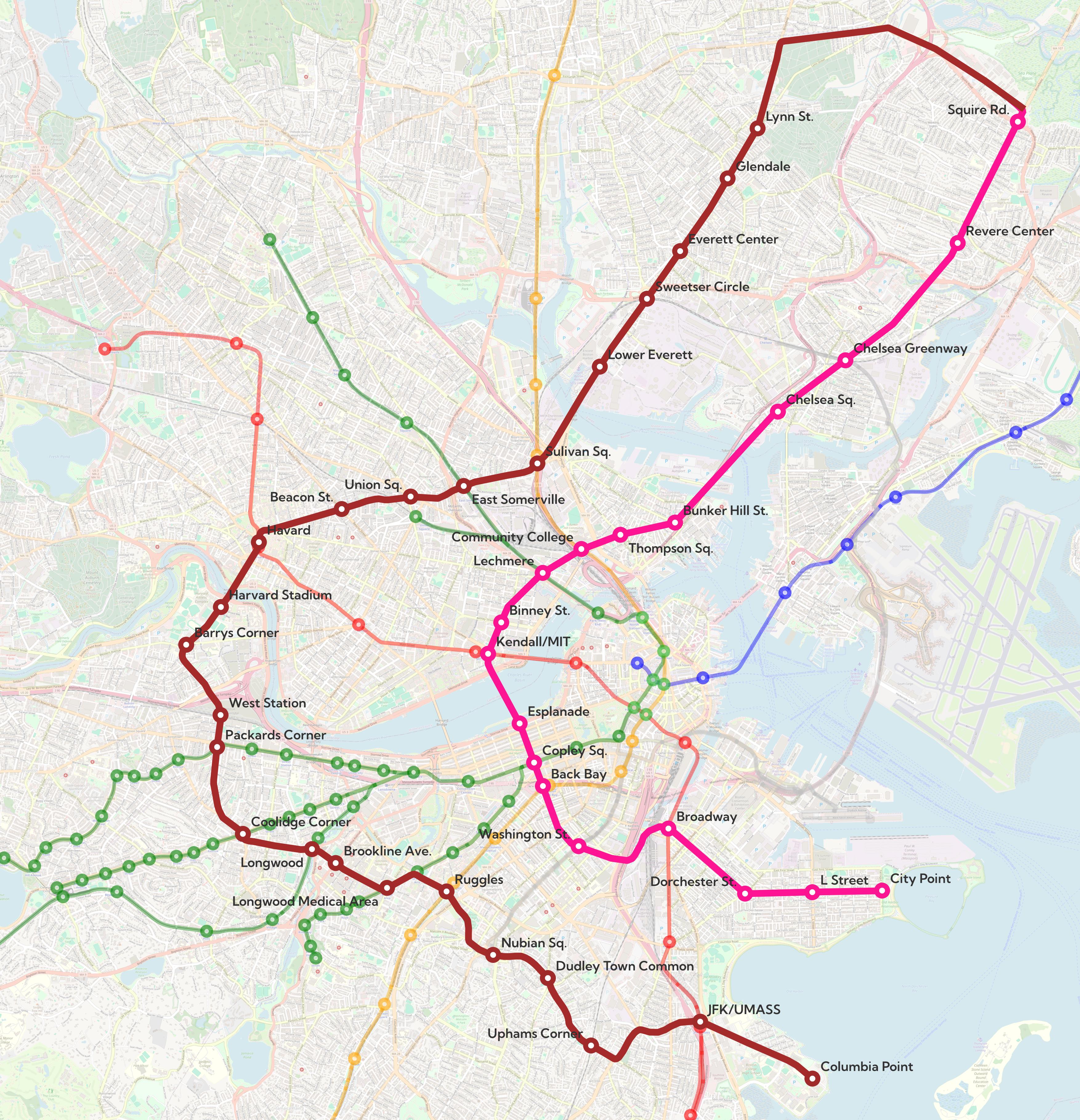

So, with that said, here's my preferred Urban Ring:

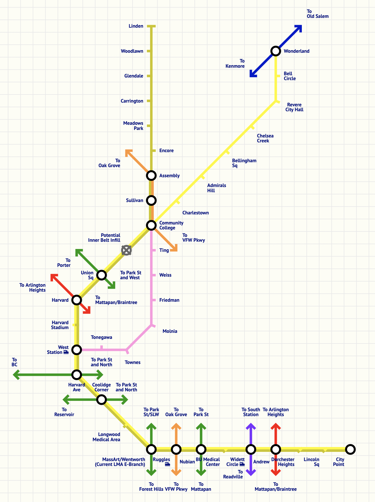

To bring over a few pieces that I contributed in the other thread:
Here is a broader overview of my take on [the question of getting from BU Bridge to Longwood], with the obligatory Pretty Map:
One question I think that would impact this: what kind of service are you running south of Fenway station? Is it surface-running in a dedicated ROW? In transit lanes? Is it grade separated? How far does it run -- LMA, Ruggles, Nubian? I think those would inform what kinds of investments and tradeoffs are reasonable between BU and Fenway.

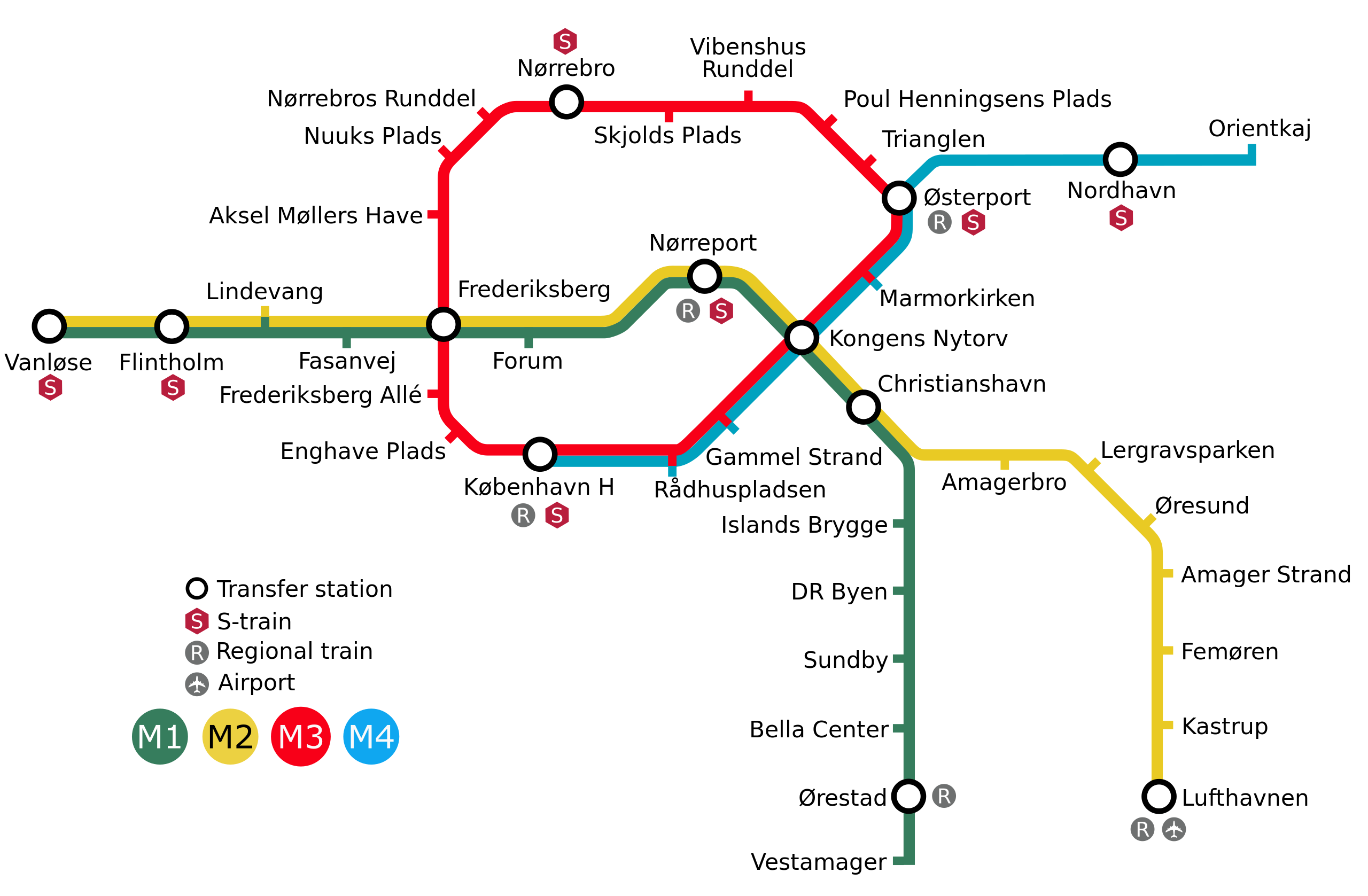

I wanted to come back to this thread with a discussion of the Copenhagen Metro and why I think it's extremely relevant to an urban ring service.
Overview
The Copenhagen Metro is a relatively small system. It has 4 lines, with 2 radial lines, 1 loop line, and 1 radial line that runs along part of the loop. (There is also the S-Train network which is cool but I'm going to skip over that for right now.)
The network features a combination of underground, elevated, and at-grade stations, although the majority of the system is underground.
Overview
The Trains
This is where it starts to get interesting. The Metro uses the Hitachi Rail Italy Driverless Metro system, which means the trains are small, only 128ft long. (For reference, Red Line trains are around 420ft long.) And yet, the M3 of the Copenhagen metro can carry more passengers daily than the Red Line did in 2019. It does this through very high frequencies. M3 and M4 trains come every 2-3 minutes, and so headways on the combined section can be as low as 80-90 seconds during peak times.
The Stations
When you use the metro one of the first things you notice is that all the (underground) stations are very similar. They are (almost) all built in a 20m by 60m box, which makes the construction process fairly straightforward. Anywhere you can dig a 20x60m hole you can build a station, which means that you can easily site a station under just about any moderately wide street. They have no fare gates, operating on a proof-of-payment system, and are about as simple as you could build them.
The Money
The Copenhagen Metro is fundamentally tied to real-estate development. M1 and M2 stimulated huge new developments on the island of Amager, while the dirt excavated from the M3 tunnels was used to make new land in the harbor to be built upon and developed. M4 is designed to connect these new areas in the north as well as more areas currently under redevelopment in the south. Proceeds from land sales and development is how these projects have been funded.
Why is this relevant?
So why is this related to the Urban Ring? The urban ring is a service designed to make connections with other lines, and be used for many short journeys rather than a few end-to-end journeys. This high turnover rate and high number of journeys involve a connection mean that a system with smaller trains is not a problem, since there is not one busy section where the trains fill up and slowly empty out, and the high frequencies make connections shorter by reducing the amount of time spent waiting. The small stations in a 20x60m hole design makes stations easier as they can be sited under small, relatively narrow strips of land like on the SW corridor next to Ruggles, at Bellingham Sq in Chelsea, or under the Oscar Tugo Circle at LMA. and the funding model is also extremely relevant, as a design like the one I sketched up previously links a huge number of areas with massive sites awaiting development. Wonderland, Bell Circle, the Everett Hellscape™, Sullivan, Community College, the Inner Belt, Lower Allston/West Station, Widett Circle, and Andrew are all stations adjacent to huge sites that are either actively being redeveloped or are open to redevelopment that could be used to (At least partially) fund the project.
So how much complexity could the "Small station box" eliminate? Of the stations on my fantasy diagram, only the following could likely not be built using the station box method:

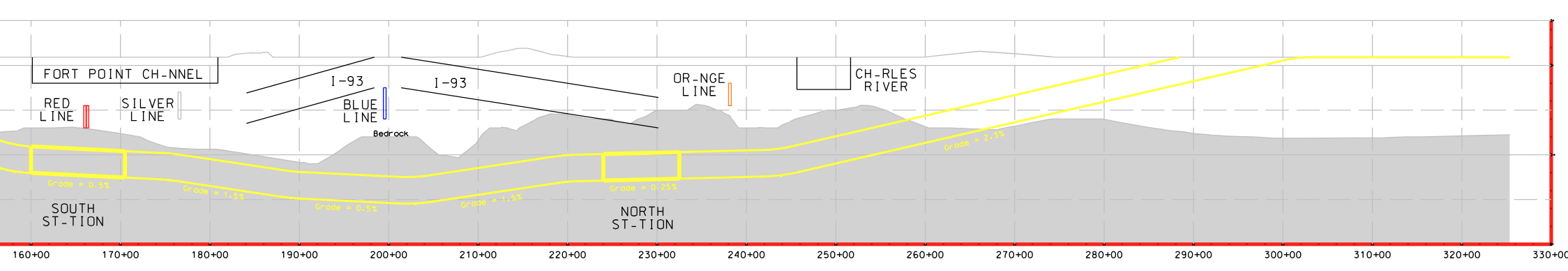

  • Seaport could get difficult with all the tunnels already there, but you might be able to find a big enough space.
  • The Chelsea Greenway/SL3 busway is generally wide enough, although the location isn't optimal.
  • The only place you could make this method work at Logan appears to be where the Terminal E parking is currently, but that's not very central. Better than the current BL stop though.
  • There is no shortage of space at Newmarket
  • Maybe you could get something under 93 at JFK/UMass? Failing that you could dig up part of the busway

Hey everyone,
I’ve been following your conversations for the past few months and got super excited about a bunch of the ideas shared on the forum. I went ahead and tried to map out a somewhat realistic route for a continuous urban ring with the lowest barrier to entry.
The route is inspired by bus priority expansions in the city such as the Columbus Ave bus lanes, dedicated busway for the SL3 through Chelsea, upcoming BHA bus lanes, and upcoming SL6 for Everett and onto Sullivan Square. It seems like there is more of an appetite for the more affordable bus infrastructure upgrades rather than undertaking large metro/subway expansions or major tunneling in the near future.
My thinking is that by creating these (mostly) center running bus corridors that we could expand incrementally in the future with dedicated transitways (https://www.google.com/maps/d/u/0/edit?mid=1_yyYlVQgwanvpk79VS0kCkcaYyuVcgo&usp=sharing) that would run trolleys/LRT (maybe type 10’s? Not sure) as well as buses. Priority would be for LRT but would also ensure a separated route for several high ridership bus lines that may remain necessary. There are similar corridors in Melbourne, San Francisco, Hong Kong, Portland, Utrecht.
kwMxFC53-zNcWdQW5757vsVxZ7viRNXewx76A3tKjX_wU0TsisPdJ01MSBcy3EvacIbCdh4DqxL1MV66ueiCQN7_p0-pKg56xmtr-HDrMQF-h63ip4XEwvEsbCyuoPVdKGTV9Zp4xXis3bhXyacqY8U
egyJv2QYO9ntWRnwFmL7Qp2yA9g4uz50N1gR8BmeqFRE6y9ZIw7K3UdsFPX112GiUJH9L_NE9BZChdAHmf9j_W6iZxcZ5YhXIu4qqJlmLV3tOWFXCmawLuodYpEdXROBfn6u1tH9Wjzkj3GUlJs-3R0
Ytb_FZYgTCaO927ok1BZLjw3elUz6soGOCWiC9N28_qYS0ebmqhnDimTITROzLWi4C34HEiOJ7bQVxlpYprr8RUfLYT40ZIRTHStbEQvMskSfVmJ-VRYWE2rR1BGPRU4SJHqphU5cgEnvxjqA4R-8xg
A couple of informing opinions:
  1. Southie - This would provide the whole of southie with access to faster transit. I’m not all that familiar with South Boston, but this route pretty much follows the 10 bus.
-WyDHHMYzs8p2U-3wuHW3fVm00FBgZZwQm5ia_Pf_DPK-Db-K0lJiAujRL-kIikwxZEJdCZvaiOq8EesEALZ9A5PDE-Z4lbES2DEbnAJaOm8UnrzHcQzE-pV0EOgOGx-MfyWxRO9LcxhrbfpcBAavvY
  1. Southie to Ruggles - Bus lanes on Melnea Cass have been part of the discussions on its upcoming reconstruction, but it’s hard for me to find info on what’s going on with that since previous plans were canceled.It seems like a great opportunity to connect Southie to Roxbury and Ruggles. I have a couple different options here for reaching Nubian which would be a high priority.
T3PckOC4GBnHKPxCAkD4r2DIcL-OhK_Bq19BLpKHRdvZXp-l6UD0sWHkKzcYNrCyf9GPTS_rMJs2Sjo_Yz3JszTGpgVwAZpD1RECo8XHdf3K7DL4vkqAN_JmN2i4YANLVguXhX1d_ltM-8eB5tB4mD8
  1. Ruggles to Grand Junction - As discussed previously, space is hardest to come by between Ruggles and the Grand Junction. I support the idea of a dedicated transitway from Louis Prang and Fenway all the way to Fenway Station as proposed by @Riverside and @Teban54 above. Park Drive to Mountfort Street/St.Mary’s is a big challenge without mixed traffic. I like the idea of extending Mountfort over the commuter rail before St. Mary’s St. and then over the area in brown. This whole thing is an investment so it’s a bit yikes but seems like it would be more affordable than going to Kenmore or having to build more tunnel
    OZgAmT026QkT44UU7ts0WLFCXIlLYFrrkid-ycKKR04TpPeyWLncGgLCBW8VZtG9IP2vodYDBn2FEN7gG3hZphqjh-RSJA-O8-sv1zBs0zK7qw-HoXJaYnHNxGPqh7IzRSJNbHjsXd95qKF1Y5N41Ec
  1. Crossing the Charles - The most recent plans from the will cross over the turnpike and then under the bu bridge. A significant amount of landwork will be down here, doesn’t seem like a commuter would be helpful here being so close to west station but would this make sense as a stop to connect to GL B Branch? It’s on a curve but there’s some space and work being planned.The bridge crossing would have to be expanded. A connection to West Station (potentially through to Harvard?) would be great but it’s really difficult to see with how squished it will all get after grounding the pike.
bqqd1VqaPVcAGDexqf6g6Jc54Rzieexqk8iHFAjGc0HRiVk6s7Rekx6wtcBFXZkeSYgM-RUor4c372Zvb_Yh5SOrNKqV-l71LQocwlIokkYA2yCy0QxwuvGApwAQdVYBHFqPguy4BfxvjVgmuafrGTM
  1. Grand Junction - This ROW would do the majority of heavy lifting through Cambridge as in the Is there space on the Grand Junction ROW for both a commuter rail line and 2 bus lanes throughout? Assuming West Station revives rail use here like the plans say, how much space would we have to use this corridor for anything other than heavy rail? It seems especially tight in East Cambridge
MfdFNyjZrUh5gjt2hUuDLxTYUUKdML5bkSg693boee3uCm4VGtKs8SwynfrlTwZ8CQ2WkeLtf7osMHVnitXowJdZ-6RgaqiyMMvJ9aE62r4ycoQ0JCo_ROYKo8nshy4EGASMKaWbUoIQfwz9KVM1y1c
  1. Crossing the Inner Belt - The easier way to go here is via the Inner Belt, someone posted a map on the tracks that would make that connection possible similar to the lighter yellow option I have ( sorry I wasn’t able to find the exact post). However since we’re thinking BRT first, this seems pretty impossible to run through the inner belt. My alternative would be to go under or over the Fitchburg and GL tracks and connect into Mcgrath Highway which is going to be grounded. While a busway is unlikely at this point in time due to low transit demand, this project would certainly change that assumption and the design of the project is ongoing.This route also gives us an easier connection to the green line in this area at East Somerville Station on the Green Line.
qO1R_BY6vgaJIVOoLTEaJhgcec4XsX4gZAzS-VeRM-hZ7Wt7T58tDcPYJwF4_YwGd7LnyJN6QKi3OCRTbu7-TJSJlVXoWqtzfQgNpjpSlsmV_3y1IAfmMj_PUYOIBxqr_VoYFs4Y_cD5XX2_yv9xqnk
  1. Sullivan to Chelsea - This section pretty much just follows the SL6 preferred route with side running bidirectional bus lanes through the Encore and Soccer Stadium (fingers-crossed) sites then into Everett with bus lanes where space becomes tight again. I have a potential bridge over Sweester circle in case of light rail. Crossing the rail tracks from 2nd street are another challenge in the future for LRT. We’re onto the Chelsea busway from here and relatively smooth sailing.
    Pk5Z-o-MgRAoOPHyhlew1K9FhlpmRUI63TnZiq0gUYlr7CQhDBsA_oRI0dH0k5v1X093L-jlUFYqk3VZ9WIAodYk5hngxLxmCOS5nG-mo4ausSQQZdqeYsj_9FezXnsovzwwhSaRMStlbPOL-wVLZfc
  2. Chelsea to Airport or Wonderland - Here we run into the Chelsea Creek issue like @TheRatmeister mentioned to support their routing up to Wonderland. While I like this connection for Revere stop and avoiding the costs of crossing, I feel like it doesn’t really make for a helpful connection compared to Airport. BLX to Lynn brings in new riders but unless riders want to go Lynn -> Everett or Chelsea it doesn’t beat a downtown transfer. My more pricey crazy fantasy solution to crossing the river is a tunnel under the creek into the ROW connecting to Martin A. Coughlin Bypass Rd which would be a dedicated transit way connecting to Airport station on the west side of the East Boston greenway.
8D2wKEmGVlE_zoirkKhmDRVFbEkdF87PhQUN69R243z6daUiw1603HRupACx3_PXBYIOmUnUM-d3r_WYVDedeBpO47LG30tdGqrMiBZczMsl__rT5sARxFli7vXNMguwzgIgnF-WYyz3ymIbNWsldS4
What the line is good at -
  1. Reducing downtown transfers for movements between Cambridgeport, Kendall, MIT <-> BU, LMA, Northeastern, Roxbury
  2. Greatly expanding transit access and connections for South Boston, Roxbury, Everett, Chelsea, Revere
  3. Building on current infrastructure projects in planning over the next few years
What this line is bad at -
  1. Being Fast - Many Many Grade Crossings, could be greatly improved with signal priority. But mixing different bus routes on the same transitway also brings challenges.
  2. Misses some big nodes like Harvard, Kenmore
Anyways, I wanted to share these ideas I have been picking up from browsing through the forum and wanted to get your informed opinions on why this is or isn’t a good idea.
