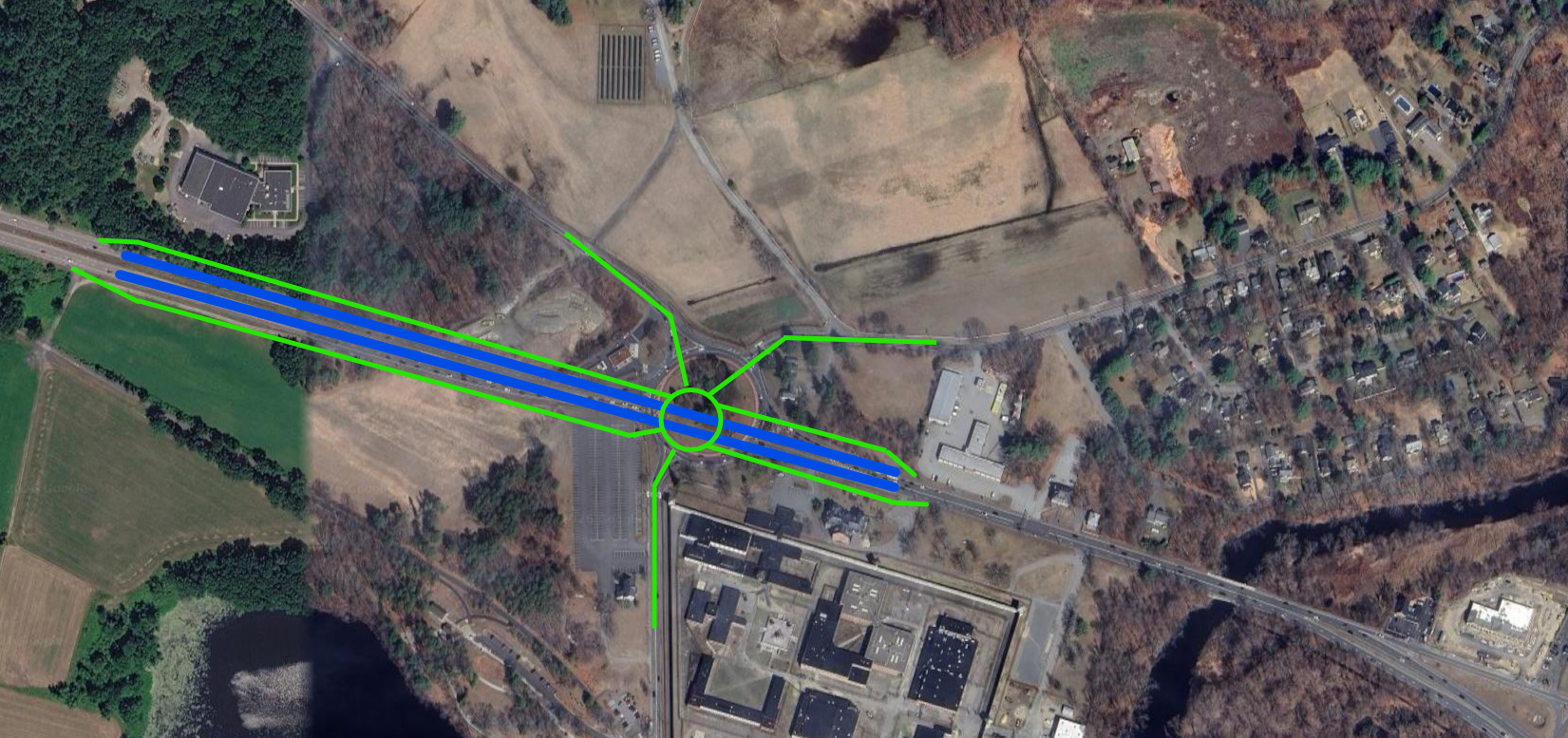

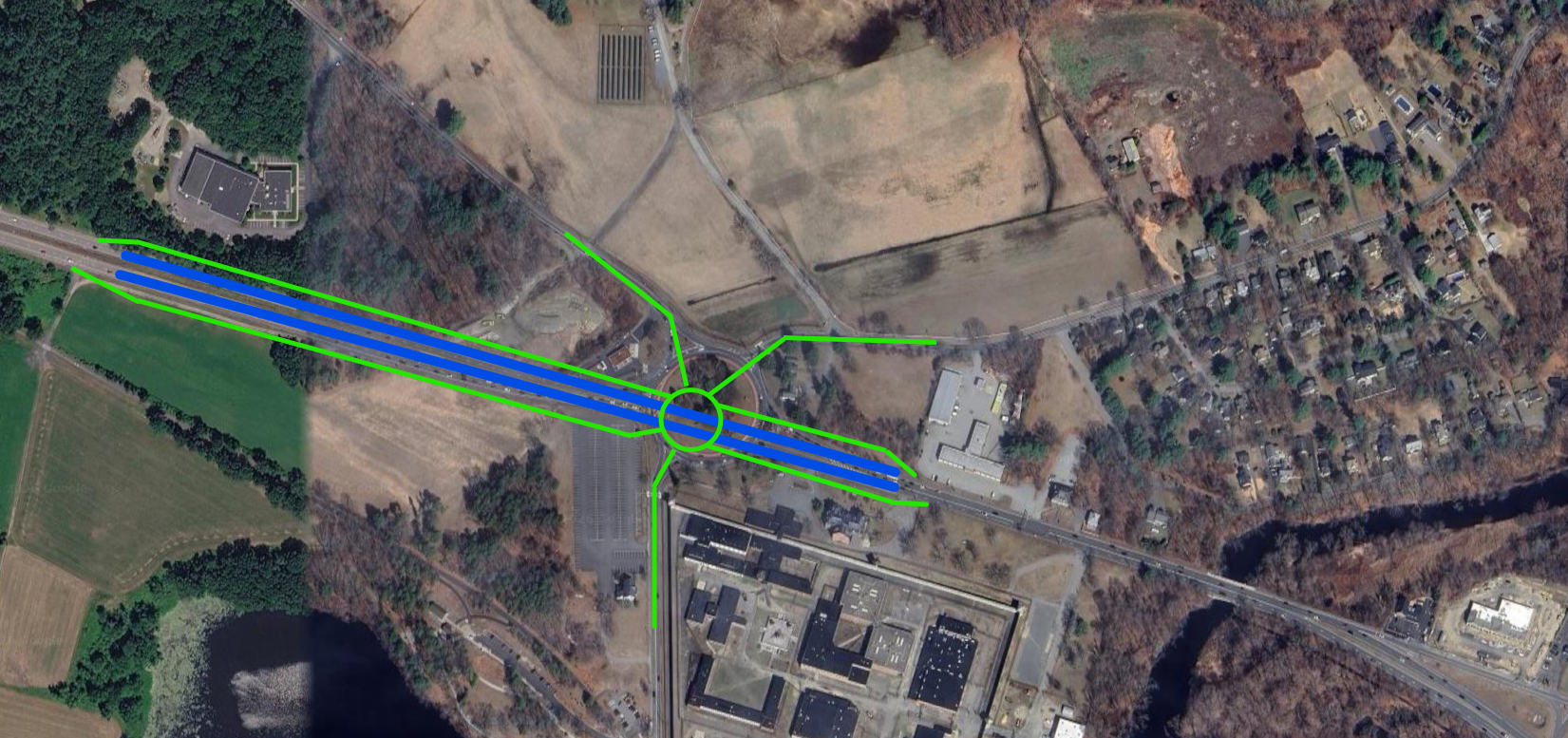

This may belong more in the "Crazy" thread than anything, but why not consider a subterranean option? Provide eastern portals just west of the State Police barracks and western portal just east of the Rail Trail access road. Provide collector/distributor roads (to avoid tunnel on/off ramps) that tie into a double rotary configuration. This would mean no traffic signals, easy pass-through traffic flow and realistically take up less land than what is currently being proposed.
It would ±2,500 foot long tunnel, which I know doesn't make the best financial sense in this part of the state, but with the redevelopment plans of MCI Concord coming along, I feel like going up, vertically, is the least desirable option. Not to mention every plan the state is proposing renders the land directly west of Commonwealth (old MCI Parking area) undevelopable for something like a trail-oriented development down the road. All those options feel very uninspired.

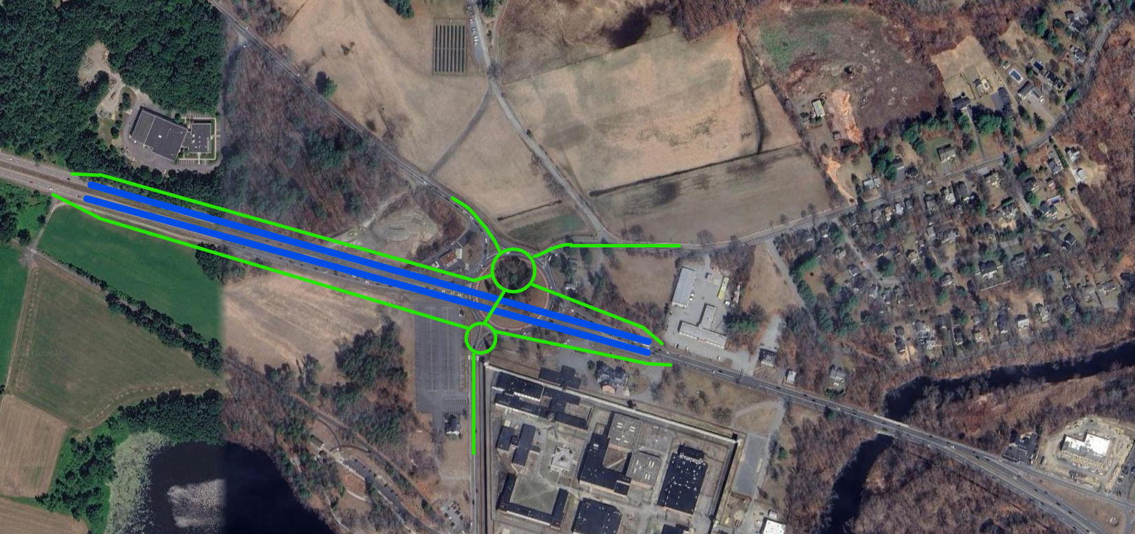

If we wanted to make a really chaotic rotary configuration, do another single rotary setup but for surface streets only 😅. That gives me anxiety just looking at haha.
I think the main point is to get away from rotaries, not add more.
I do like the tunnel idea but would be much messier than the other options.
That’s not too far from the crayon ideas I had years ago. I think I settled on a roundabout for surface streets only. One idea had no access to or from 2. The other had westbound 2 accessible from 2A by the DPW and eastbound 2 accessible from Comm Ave by the prison lot.

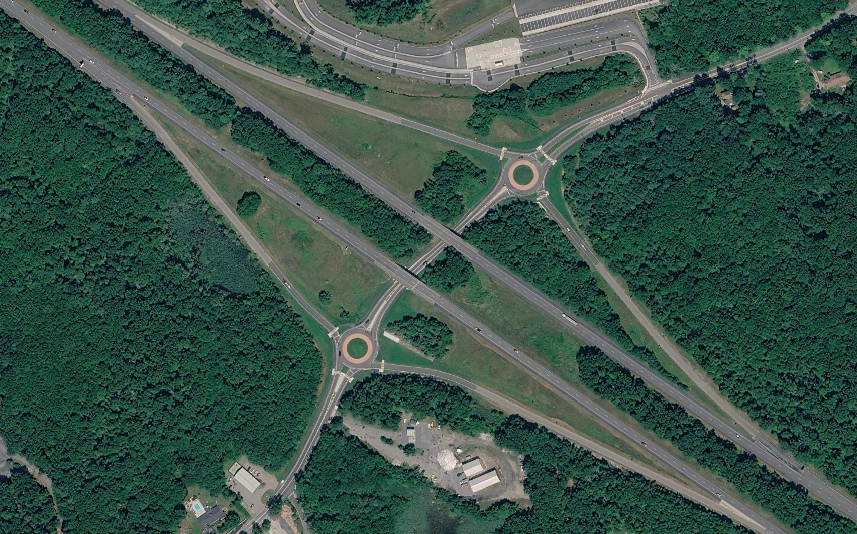

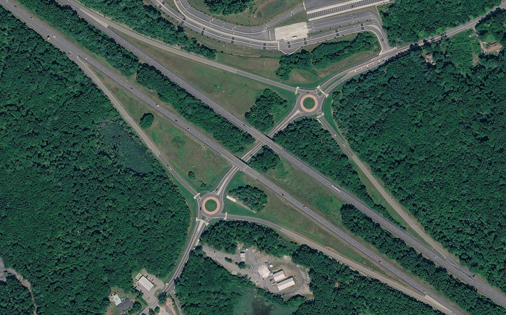

For reference, here's the Rt. 16/Rt. 146 interchange I helped design and oversaw construction of in Uxbridge three years ago.
Not saying this is a definitive solution, but shows that you can construct back to back roundabouts as a potential means of addressing the intersections.
This is a really intriguing implementation. Is there a traffic volume where this ceases to work well?
