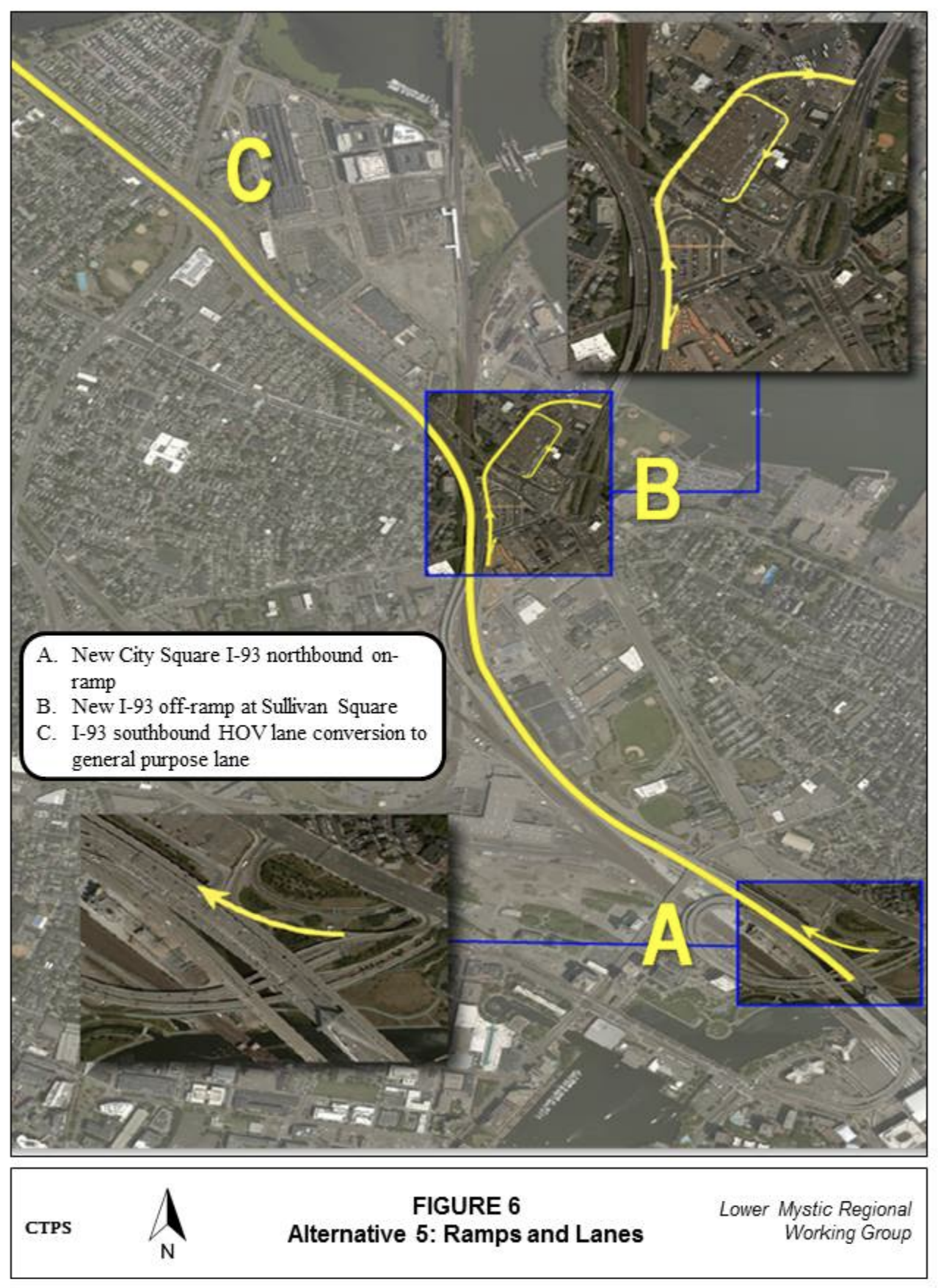

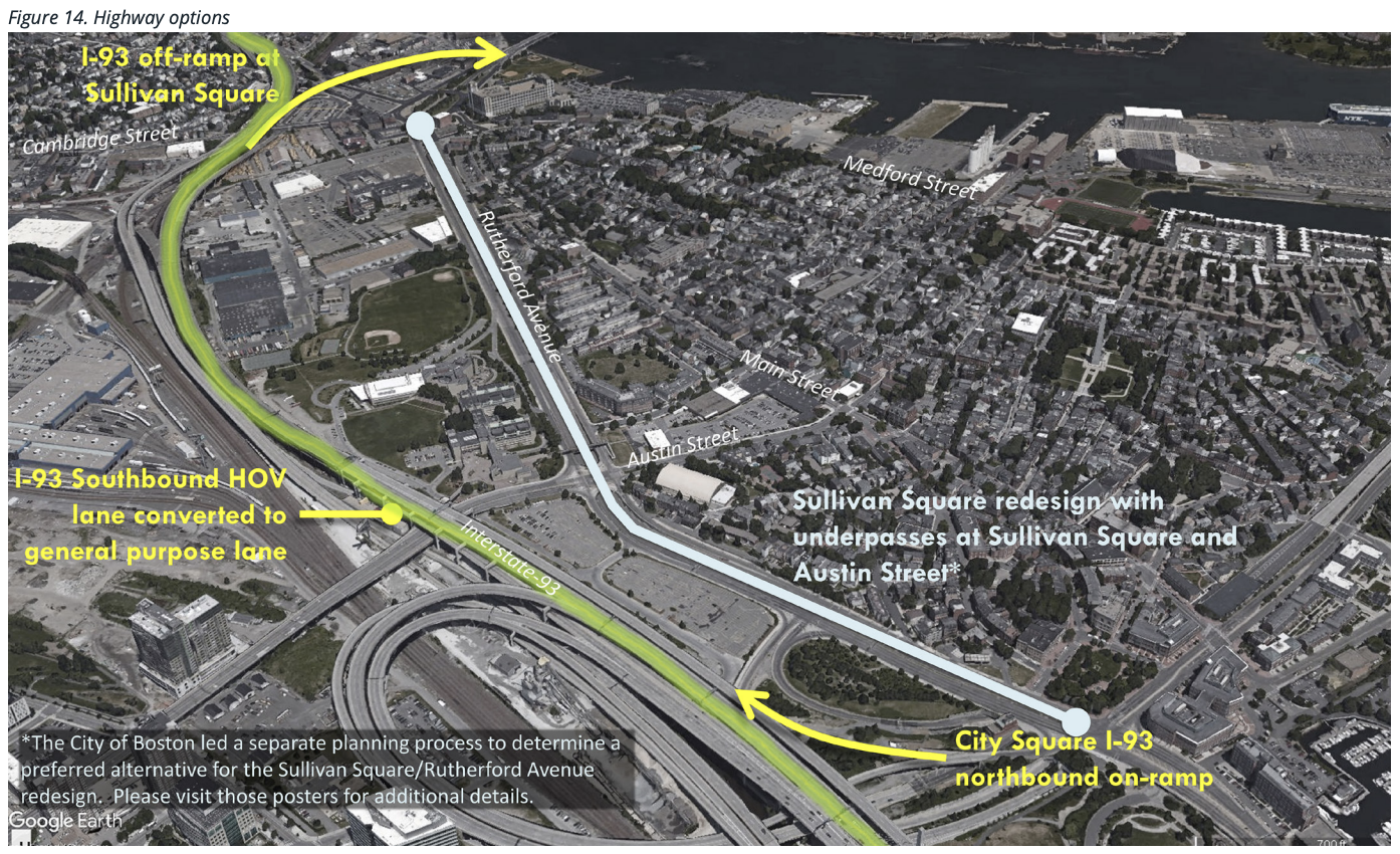

Came across this in the Lower Mystic Regional Working Group "Spring 19" report while searching for info on Rutherford:
This alternative examines three highway infrastructure improvements that are shown in Figure 6; a new I-93 northbound on-ramp from City Square in Charlestown, a new I-93 off-ramp at Sullivan Square, and converting the I-93 southbound high-occupancy vehicle (HOV) lane to a general purpose lane. In Alternative 5, all three will be modeled together to determine their benefits/impacts. (See Appendix E for a cost estimate and additional figures prepared by MassDOT.)
The new City Square on-ramp to I-93 northbound would provide motorists from the City Square area of Charlestown and the North End of Boston an opportunity to directly get onto I-93 north instead of having to travel through Sullivan Square for I-93 northbound access. The estimated cost for this on-ramp is $48,400,0003 The I-93 northbound off-ramp at Sullivan Square would provide a direct connection from I-93 to Route 99 and the Alford Street Bridge; eliminating the need for motorists to travel through Sullivan Square. There are number of issues related to this alternative including potential impacts to the transit station, compatibility with ongoing redevelopment of the area, and the requirement of a tunnel or viaduct to carry traffic directly to Route 99. The estimated cost for this on-ramp is $64,700,0003.
The last modification to the highway system converts the existing I-93 southbound HOV lane to a general-purpose lane. Currently the HOV lane is under-utilized and converting this to a general purpose lane would provide an increase to I-93 southbound capacity. This is estimated to cost between$1,000,000 and $2,000,000.Alternative 5.1 removes the proposed I-93 northbound off-ramp at SullivanSquare. The off-ramp is being removed to examine the effects on traffic volumes along Rutherford Avenue and also because of the numerous impacts to Sullivan Square and its’ potential redevelopment.

That looks like a very car-centric proposal, calling for retention of the underpasses on Rutherford Ave at Sullivan Sq and Austin St, PLUS a new lengthy off ramp around the north side of Sullivan Square. We don't need new ramps, nor any underpasses. This is just enabling car commuting, plus keeping Rutherford Ave as an expressway.
