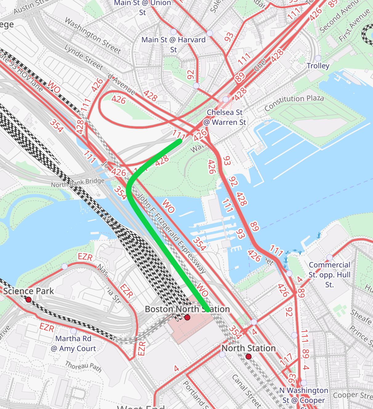

In the medium term, there's another option: What if we make it a branch of the Green Line from North Station?

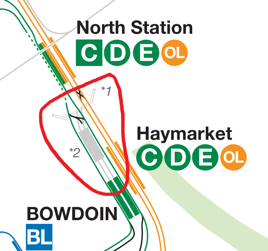

The tunnel that leads to Tobin Bridge is already very close to North Station. Build a tunnel that takes a turn and go under the Charles, build a flying junction at GL North Station (which will hopefully be easier than otherwise would, given that the two GL tracks are on different levels there), and you're there. Northside Green Line has much more spare capacity than southside today (and remains so under most GL Reconfiguration proposals), so you can easily extend, say, the C trains to take on this branch to Chelsea.
If the GL flyover at North Station is infeasible, another potential idea is to use the old center tracks at Haymarket (with a crossover north of the present-day station to get to the center tracks), though I'm not sure how much of those structures remain intact today. For a cheap build, you can either use the portal to get to street level, and follow the route of the 111 bus today. For a more expensive build, use the center tracks to separate from the main GL tracks, but stay underground with separate North Station platforms somewhere.
@vanshnookenraggen , you need to update your track map to make the C terminate at Government Center.)
