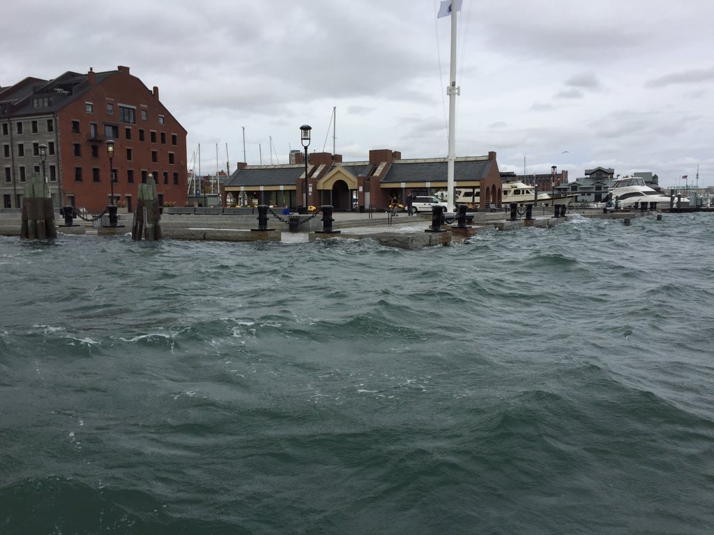

CSTH -- if that is a recent shot at high tide it is one of the Astronomically Highest Tides associated with the Super Full Moon -- aka the King Tide [perhaps of King Canute Tide?] :cool:
Yeah I totally recognize that the tide was super high.
Keep in mind, though, that the pavilion in the long wharf shot is an emergency exit to the blue line. There's another blue line entrance at the other end of the wharf, which is tied into the Artery tunnel.
Does anyone think the MBTA was keeping a close eye on the weather this week, and was ready to implement a response and mitigation action plan if the wind hit specific intensity and duration thresholds? I don't think so.
The issue is not whether the carpets at Strega in 1MPD get wet and salty - its whether all our very expensive, very fragile, and very critical underground infrastructure gets put out of commission for a very long time, all of a sudden.
I know the chance of any given big storm coming exactly at high tide is low, and the chance of one coming at a super high tide is even lower. But over 10 years? or 20 years? or 50? As a complete SWAG, I'm willing to put the probability of at least 2 major pieces of infrastructure being badly damaged by a storm flood during my lifetime at >50%. And it will be a lucky thing if no one dies when it happens.
That shouldn't be an acceptable risk, and it continues to amaze me that no one in a position of power or influence is talking about it. A barrier would pay for itself in reduced insurance premiums alone.
(And yes, i recognize wrong thread, apologies)

Jeff, Csth -- When was the last time that anything other than the Charles and its tributaries flooded critical infrastructure? [i.e. the Green Line] -- excepting of course the Molasses Flood [aka Dark Tide]
If someone is really concerned -- a few cubic yards of concrete around the top of the exit stair is all you need to prevent major flooding -- just as a foot or two of sandbags placed around the entry stairs would have kept the NYC MTA from flooding
While I don't think that the sea level in Boston will be significantly higher during the rest of the 21st C -- if you do -- then rather than Wail -- do some "Plan B"
