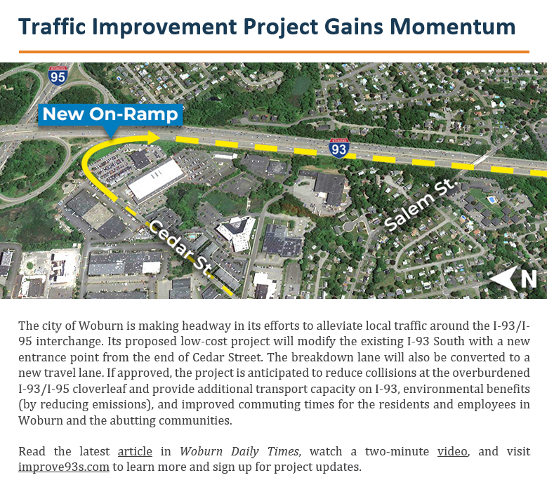

Nope, Nope, Nope. Splicing a new ramp on to an existing one at an entrance gore is about the worst thing you could propose, not even considering the speed differential from the tight curve up the embankment. Also the 93 S breakdown lane is already stripped as a travel lane. Don’t know how serious this could be if the proponent hasn’t even looked at google maps yet.
Edit:
Found the town’s feasibility study here
Wayyy less crazy than what the infographic above implied. The Cedar St ramp would be fully separated from the 128 NB off ramp and the 93 mainline until past the extended acceleration lane, about to the Salem St overpass, 1/2 a mile downstream from the cloverleaf. From there it would eat the breakdown lane till Montvale. Unclear if only the added lane would exit or if there would be an additional option lane.
Still not crazy about the weaving this would induce for exiting traffic to Montvale, and Im not sure how “low cost” this would be since this calls for widening the cross section of 93 by 30’ on an embankment. That said, from a traffic engineering perspective, seems like this could actually check out (feasibility hasn’t progressed to modeling yet; the concept was only evaluated on FHWA controlling criteria) instead of being absolute insanity like l first thought.
I don’t see what problem that ramp is solving. What trips is it diverting from the “problematic” movements on I-95/93? Who is the intended user of this “go north to go southbound” ramp?
Like can we tell which daily rush hour (AM or PM) it purports to improve?
That information does seem to be absent, at least from the linked documentation. As it stands now the "best" way to get to 93 South from that area requires going onto 95/129 by the Toyota dealership and then through part of the existing cloverleaf's ramps over to 93. I suppose this ramp would at least have the advantage of not having to engage the 95/128 portion of the cloverleaf at all (which isn't a bad thing, that interchange is awful). Still doesn't make ton of sense to me, though (much as I would like anything that lets me avoid that cloverleaf...shudders.)
Im assuming primarily local traffic with minimal effect on the 128 or 93 mainlines. The queues on the Washington St on ramp are brutal, in addition to the slog of lights South along Washington, especially the LT movement at the on ramp.
Reading between the lines of the feasibility study, it seems like the town thought they could crayon in the ramp as shown in that infographic for essentially no money and pay for it themselves, but WSP came back and said lol no.
That Washington St ramp and associated weave is one of if not the primary reason that interchange is so hard to solve. The fact that it would divert (some?) traffic off of the that ramp is how the town is trying to sell it to DOT, especially since the only feasible alternative is wayyy out of a municipality’s price range.
However, unless the capacity analysis comes back and really surprises me, l doubt this ends up getting built. For half the money, DOT could add a lane on 128 NB to North Ave, eliminating the kamikaze 3 lane change on the 93 S to 128 N movement due to the lane drop prior to the 93 N off ramp. That job actually would tangibly improve overall interchange operations instead of just saving a few Woburn residents 3 minutes at a light.
