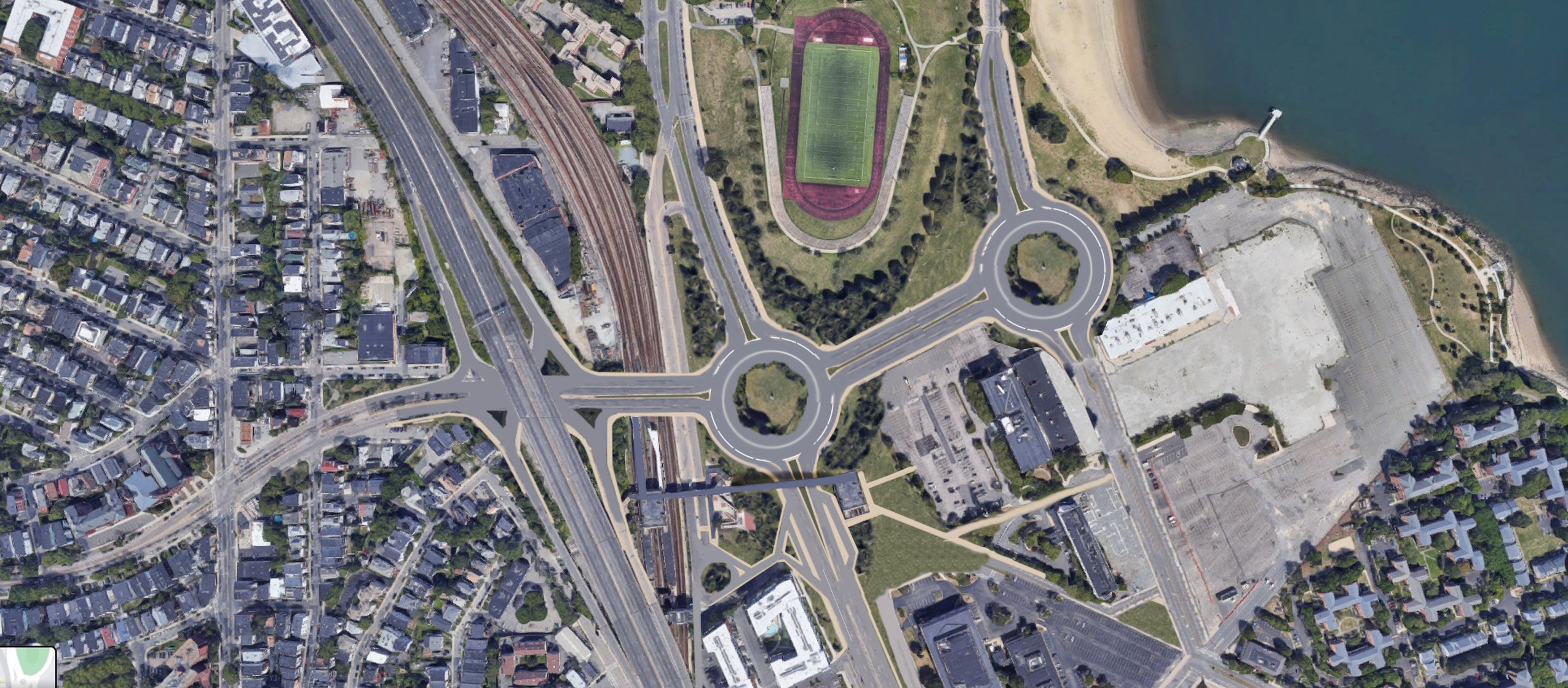

Any massive rotary configuration is going to be horrible for pedestrian access between Bayside - one of the biggest TOD opportunities in the entire region - and JFK/UMass station.
Very suboptimal from a pedestrian perspective due to the circuitous routing. Also God help the guy unlucky enough to have to design the vehicular guide signs.

Isn't pedestrian access already pretty terrible?
Fair enough, though my concern about it being too complicated still stands then. I also wonder how often you'd see back up in one rotary because of enough people waiting to merge into the other rotary. Do any examples exist in the wild of this type of configuration?

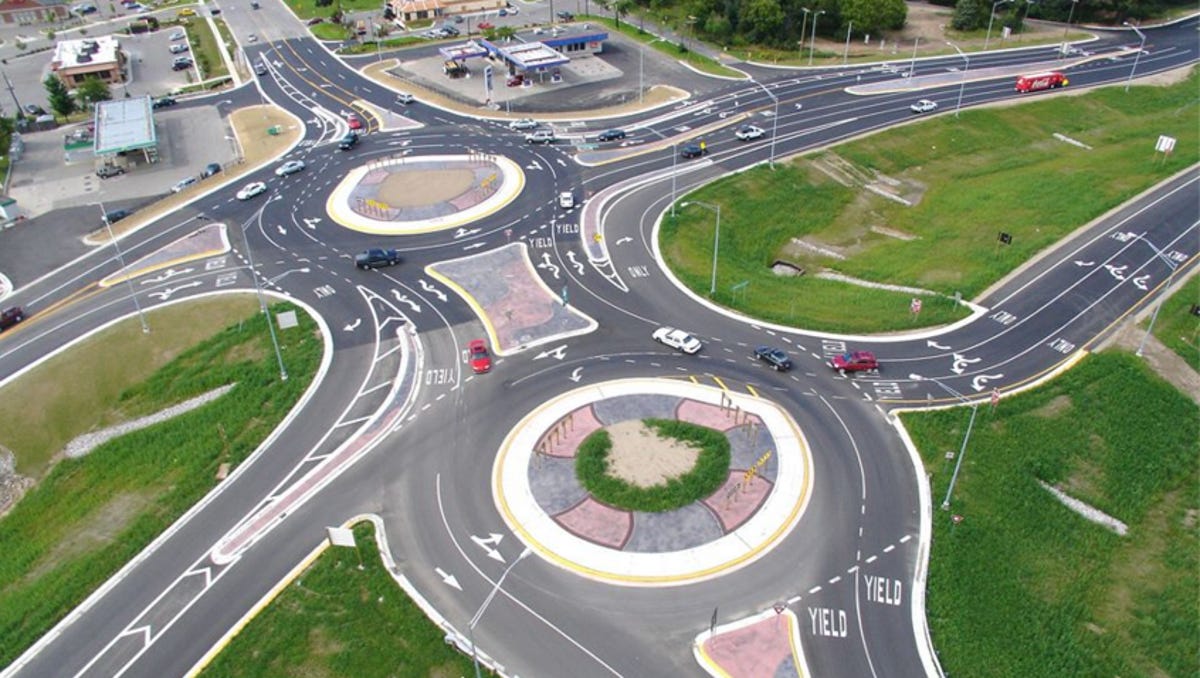

There are a lot out there. I googled "double roundabouts". This is one is in Michigan

Oh, absolutely. But the goal should be to make it better, not worse. This is barely two miles from downtown at a multimodal hub station surrounded by two housing developments, a likely TOD site, a college campus, and a park. It needs to be significantly de-auto-oriented.
This whole area is a cluster. You have a major highway with poor acceleration lanes causing large backups onto Columbia road.
In general, Americans have issues navigating rotaries, throwing in a double rotary could be recipe for disaster.
How? I think Charlie’s suggestion was only ever to help traffic. I don’t see an easy way to make the intersection ped friendly beyond a big tunnel or a big bridge…
For greenfield development in the Midwest, admittedly not terrible. Though in typical MDOT fashion, no accommodation for non-motorized users.
The problem with doing something like this for K circle is that it would be about four times the size, significantly lengthening the pedestrian detour since MA roundabout design guidance strongly discourages crosswalks across the circulating lanes. Plus at that scale it would function more as a rotary than a roundabout, with all of the former’s general unpleasantness. Not ideal if the purpose is to stich two neighborhoods bisected by a tangle of arterials back together. Additionally, the volumes through those existing intersections are so high that the queues would almost always back up into the circulating lanes of the adjacent rotary, creating the potential for literal gridlock.
Appreciate the sketches/ideas though. This area is a crazy hard one to solve even by Boston standards. DOT and the Bay City developers haven’t been able to come up with anything better yet themselves.

Extending BeyondRevenues's plan to the 2 circle alternative by lining up William Day Blvd and Mt Vernon in a second circle to the east connected by an extension of Columbia Rd. Day and Vernon should pair up well because they are both local roads. Moving Mt Vernon like this should also make it much easier to develop the section of the site nearest to JFK station.
I like it, but it wouldn't fit well with the Dorchester Bay City development:
