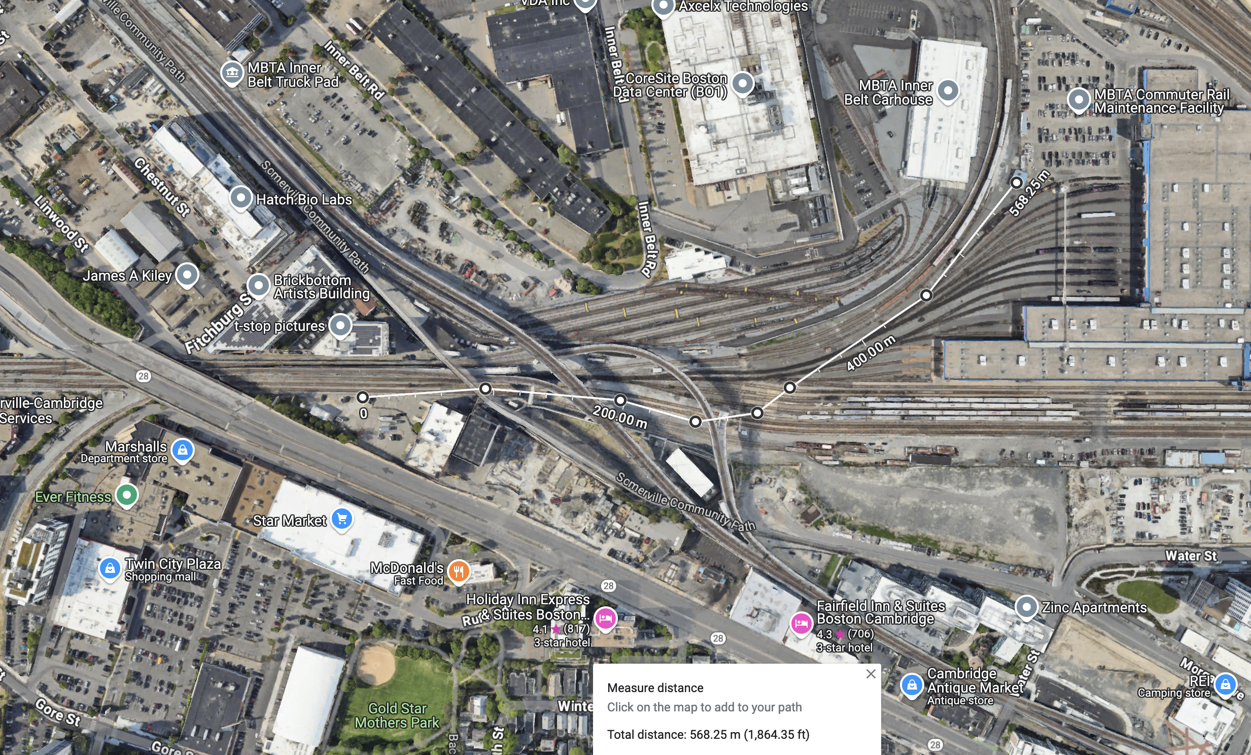

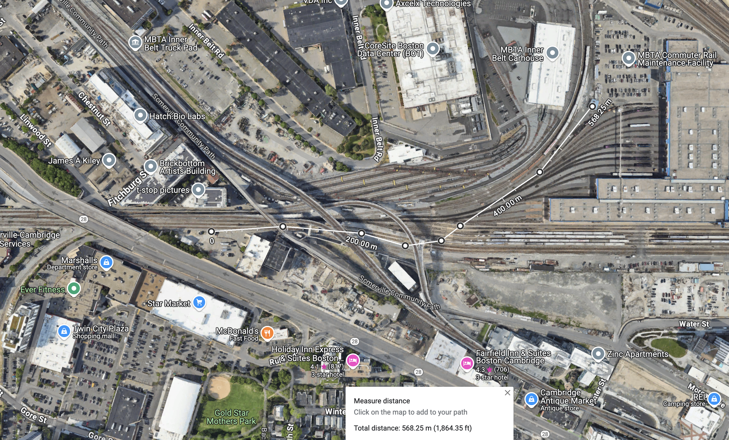

I certainly could be wrong about this, but I went way down a rabbit hole here a couple of years ago, and I think this location also doesn't work. The problem is that the circumferential service (Aqua Line, or Bronze Line below) still needs to cross from the south side of the mainline tracks to the north. (Probably needing to traverse the BET.)
No matter where you do it, the Fitchburg Line needs to be crossed; the advantage of the East Somerville alignment is that it lets you do the crossing at one of the narrowest points:
(I'm a little less confident about my solution for Medford <> GLMF yard access as I've sketched it above, but I think it could still work somehow.)
You could build a cutting like this for the circumferential service. The station would be similar to your proposed McGrath station, built in a shallow cutting and then presumably covered over to deal with all the train yard noise.
