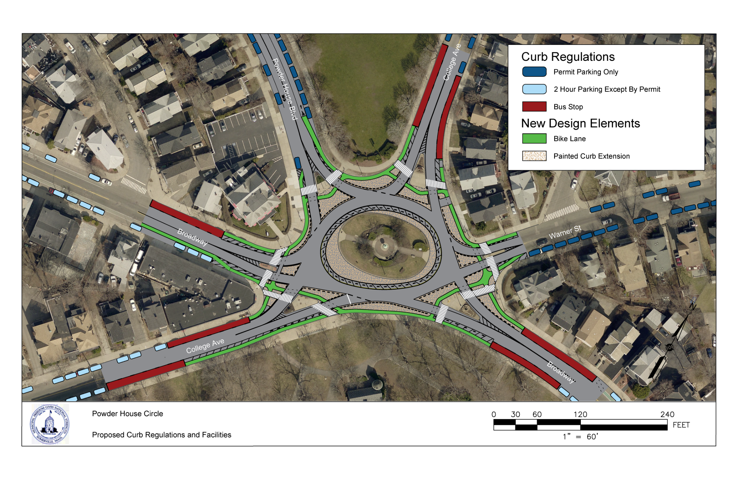

Next, it would be nice to see these protected bike lanes extended in both directions on Broadway, rather than the green door zone lanes that are there now.
"The crosswalks to the island in the center of the Circle will be removed, and pedestrians will be expected to use the crosswalks along the perimeter of the Circle to reach their destination"
This is dumb, especially since theres stuff to look at in the middle
I'm wondering if pedestrian/bicyclist activated traffic lights should be installed at the crosswalks/bike crossings. Seems with only yield signs in the roundabout, cars will be zipping through.
I don't actually think so, given I still live in the area; those crosswalks are basically the only reason the entire works grinds to a halt bc they're signal protected. Their removal results in minimal increases to walking distances, and is compliant with current best practice which generally are to discourage crossing to/through the island.

I’m also tired of Somerville’s love of painted curb extensions, instead of real curb extensions. If the paint isn’t a signal that there will be real curbs ASAP, then drivers will learn to ignore them.

I read this as a short-term solution: they're starting on this in ~2 weeks and will be done at some point in September. If you relocate all those curbs and sidewalks to have a proper structured roundabout, that's going to require a significant amount of drainage re-working, likely over the course of a construction season and possibly more. I imagine the painted curbs could actually assist in some of the required disruption if/when they make permanent changes here. If I'm recalling correctly, College Ave is being redone this summer, Broadway between here and Ball Sq station is due for reconstruction either next year or the year after. The Broadway redesign could align with a more comprehensive reconstruction here.
The existing traffic lights are one of the problems that is being fixed. The lights were always just an afterthought/bandaid for a sloppy, car-centric road design.
With only one narrow lane of traffic to cross at a time, pedestrians will have no trouble crossing in a short time. And the crosswalks are separated from where cars merge into the circle, so drivers only have one thing to focus on at the crosswalk (pedestrians) and one thing at the merge (other cars). This will be 1000x better the current chaos of lights all over the place that are sometimes flashing and sometimes not.
it is very rare that anyone crosses to the middle of the circle. And when they do, it takes ages for the lights to change and traffic to clear. I think it will be faster (or just marginally slower) to walk the long way around with this new design than to wait for lights to cross the center.

I don't/haven't spent much time there, so I'm not sure about the change in pedestrian circulation, but the bike set-up looks exactly how I'd want all of our rotaries to be designed.

I live a few blocks from here and this rotary is a nasty heinous clusterfuck at rush hour; I generally go to some lengths to avoid driving through it. And it's mostly because of the traffic lights. These changes will be a huge improvement and I hope they make them permanent.
Like Kelley square before it, thus falls another road junction that was designed for horse and cart then poorly redesigned for cars. I can understand why some here are lamenting the temporary nature of this fix but these changes are painfully needed.
Also heads up to those who may lament a lost park in the center of the roundabout, as someone who walked through Powderhouse for three years straight to get to work, this one isn’t worth it. There are two large parks adjacent to the square, the roundabout is a clusterfuck of cars trying to one up each other at all costs, cars from Broadway south heading north that think they have the right of way over the roundabout (which I’m not sure this solution fixes mind you), cars ignoring or not understanding the red lights inside the roundabout (let alone the ones around it), and other trash. These changes will be good for everyone and create a safer, more fluid system for all users. Easily one of the worst intersections I’ve seen living around the city over the years given how unintuitive it is for drivers from outside the local area.

Powderhouse Circle in Somerville is undergoing some changes for the better this month/by September. They're quick fixes and by no means perfect, but a lot better than what's there now.
Key takeaways: no more traffic lights, single lane, protected bike lanes, relocated bus stops that meet MBTA standards
Full story link.
Overnight, the changes outlined above were implemented. The painted curb extensions aren't there, and the bike lanes aren't painted yet, but I suspect those will be coming in soon. Also, the traffic lights are still active, but the pedestrian crosswalk signs are (and have been) bagged.
In general, after walking through twice, very few people are following the new lines/rules, or even the new prohibited turns. I suspect if/when they put more paint and hopefully physical barriers, the driving will improve. Right now it's not great.

Fully implemented as of today, I'd say. The remaining flex posts are installed. Seems to be working great/just as expected.
Some 'unrepresent tax payers' are mad cars have to follow the rules here, apparently...

Sorry, the last part could have been in the local politics thread. But, watching the traffic patterns, it is very clear the new layout is much much safer for pedestrians, and follows common sense that the flyer seems to indicate we have lost. Car drivers now instinctively stop for people crossing 12-foot lanes, instead of the 20-30+ feet prior, pass the crosswalk when it is clear, and stop/yield before entering the roundabout. And I'm sure whoever put this up really thought about who their advertising this to - the people walking through the roundabout who greatly benefit from the changes, and not the people in their SOV's.
