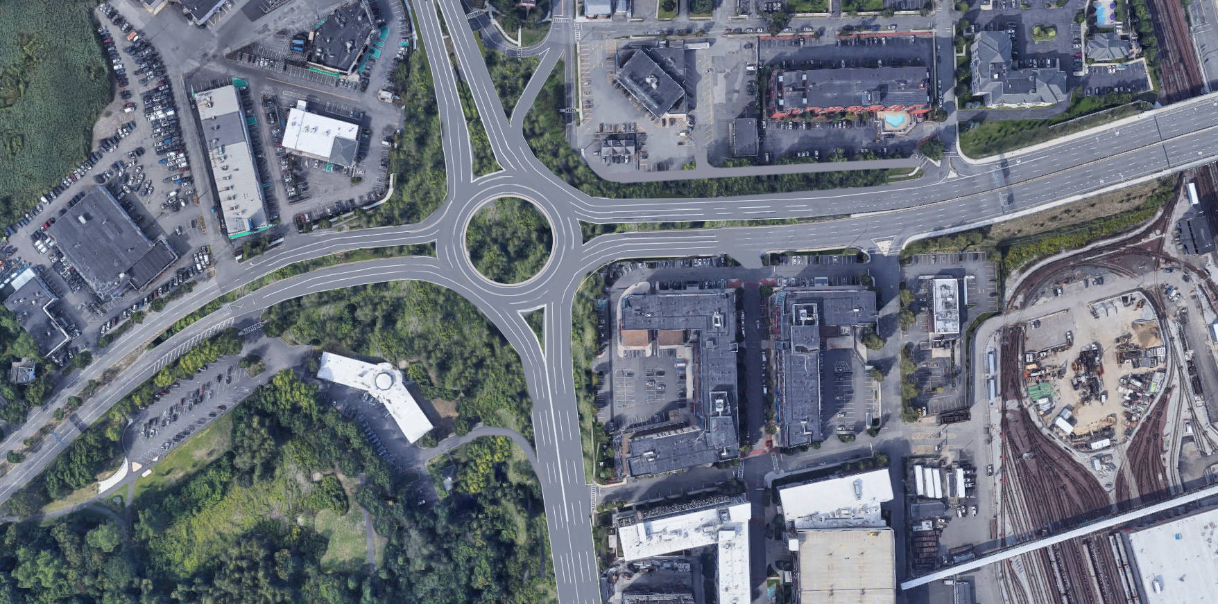

For your consideration...
WIN: Fewer lanes to fight. Traffic keeps moving. Nobody stops moving at all for 20 hours of the day.
LOSS: No more Indy qualifying lap time funzies... it will be slower on approach.
NEED: Some signage to say what lanes to be in... especially the dedicated slip lanes
Key things are limiting stops under 1000 feet away from the center. Sorry Kappy's (although I did give them something of a frontage road). And that whole stupid strip mall at the NW corner? Overshoot and come back.

Forgive me if I’m dreaming sh*t up but wasn’t there a roundabout three years ago?
Anyways, I worry that would just cause more unnecessary confusion. Overpass is fine.
