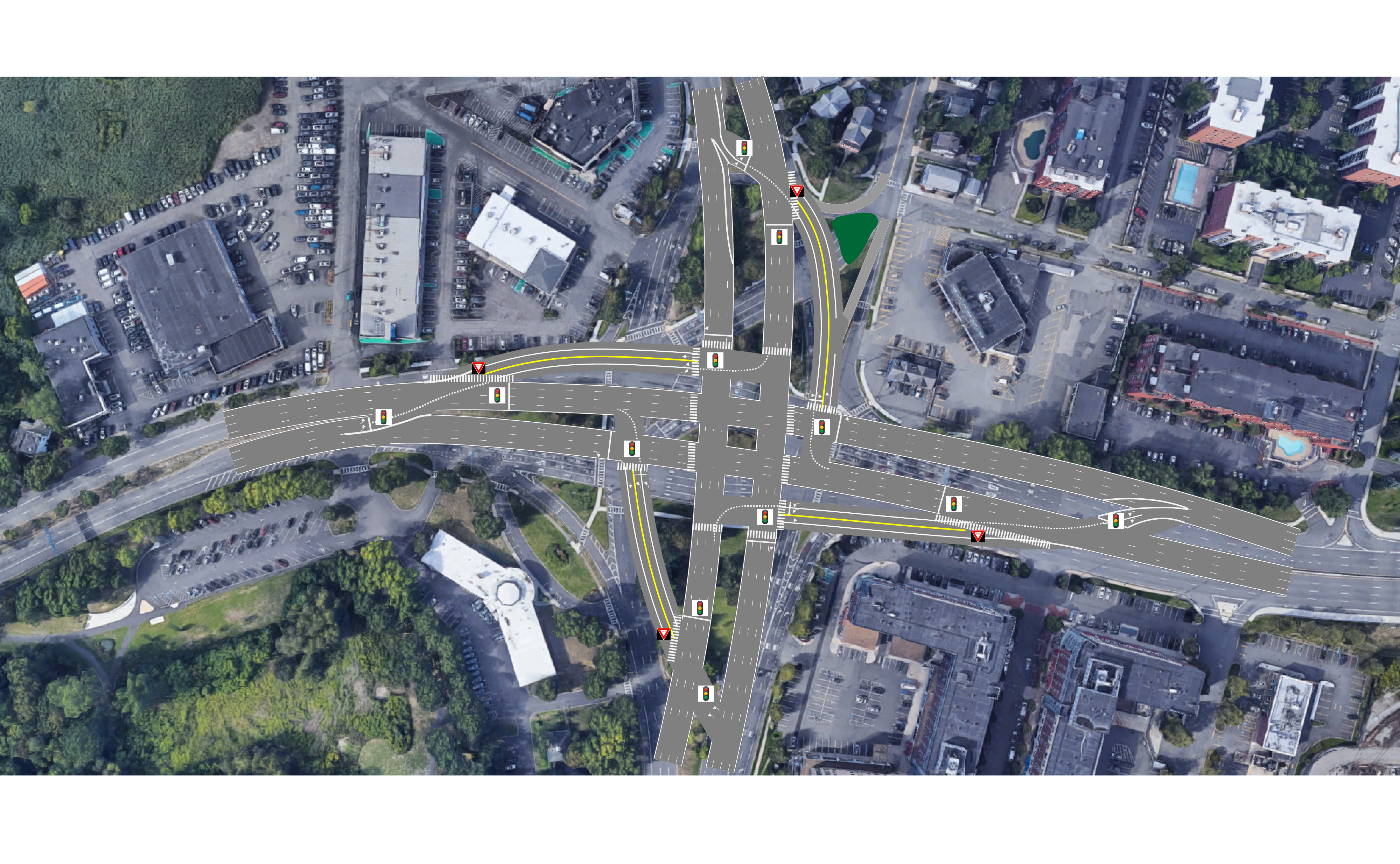

Made a very sloppy render in Illustrator of Wellington Circle overlaid with a Continuous Flow Intersection. A lot of land is opened up on the western side and crossing distances are shortened. There should also be room for bicycle infrastructure, either on road or with a series of paths outside of the roadway. The advantage of this design is that all movements can be accomplished with only two light cycles as opposing directions are able to turn left, straight, and right at the same time. A third light cycle could be added for a long pedestrian scramble phase as well.
Traffic using Middlesex Ave will have to turn onto Fellsway Northbound and do a u-turn further up the road which will then enable it to go west, south, or east. Or it can turn left onto 9th st and then enter the Parkway to head directly west. Alternatively traffic on Middlesex Ave could turn right onto Riverside Ave and then left onto the Fellsway which will enable traffic to travel in all directions.
I like that you've totally reimagined the intersection, and especially that the light cycles could be vastly simplified.
I'm still seeing a LOT of pedestrian issues, and a really dangerous intersection for biking. How do these intersections fare when there is lots of pedestrian traffic, as this space nominally should be as a TOD hub?
While I like it, it just feels like this is better suited for the RT 9 mess than rt 16.
I'm not sure about how they fare when built next to a transit station. My render also isn't as good as it could have been. Looking at it again there doesn't need to be any crosswalks cutting across the displaced left turn roads, the sidewalk can just follow along the outside. Also, all of the roads in general could be only a few feet apart with just some curbing/concrete between the roads, reducing the number of crossings and distances overall, as well as the size of the intersection itself.
Here is an example of a two-legged version of this intersection in Colorado Springs that also has bicycle accommodations. Since 3/5 of the roads going into Wellington Circle now have some form of bike lanes and the western approach of Mystic Valley has lots of mixed use paths running alongside it in the Mystic River Reservation, I think it would make sense to have both on and off road accommodation here. Also for Wellington I would get rid of the channelized right turns to make pedestrian access safer and easier and slow vehicle traffic down. Most of these intersections feature slip lanes but there's no need for them to exist in this case.
I would love to get some usage data on that Colorado intersection.
I honestly think the car problem is too many lanes approaching and people getting very testy about not being in pole position at the light because they had to go through a monkey knife fight to get where they were.
The real present design problem at the East and West sides is 6 lanes of seething tempers (when stopped), Thunderdome (green light pops) or WhiteKnuckle Light Speed if you enter with local traffic. North has same rules but with the 4 on 4 chaos mode enabled South is just 4 crowded lanes.
Too many choices. As Vinjamin Diesel would remind us, it's too fast and too furious.
As for peds and bikes? I would move them out of the intersection altogether. Set crosswalks starting at the 200' out mark. I'd cut width back to two lane parkways each way, berm the sides out, plant a ton of trees and use every traffic calming paint trick I could find. That would drop speeds down to the mid 30s without ever having to put up a speed limit sign. Also part of the grand plan is making other connections so people aren't forced to use these two roads. A two lane bridges connecting Assembly Square to The Gateway Center, beef up Riverside to join Third Street and maybe build a crossing to Rivers Edge and a bridge to River Green in Malden. RiverSideEdgeGreen Street. There are a lot of other smaller solutions adjacent to the WC that could make it all work better and smarter for everybody.
Tough love time: Just because a couple people work in Arlington and live in MetroSaugus, should I have to pay for their crappy life choices and reward them with a fast shortcut. No! Move to Arlington.

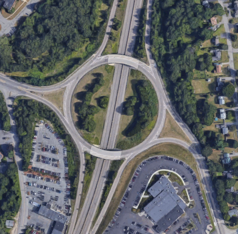

I'm trying hard to keep up with all the great suggestions, so I apologize if this has already been floated. Regarding @Charlie_mta suggestion to change the overpass scheme to an underpass for Rt.16, would it make sense to borrow from Sweetser Circle and simplify the approaches, similar to this example on Rt.1 in Norwood? I find this config works extremely well, although I'm sure the volumes are much higher at Wellington.
The example in Norwood works well for a 100% car only situation. But Wellington needs to work for all types of road users, including not only cars but also pedestrians and bike riders.
