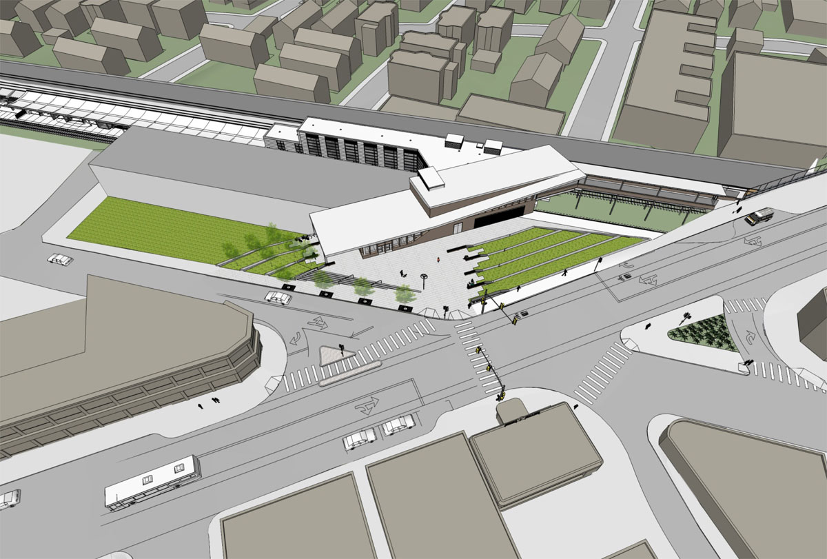

What is it exactly about the new stations that is "gold-plated?" I honestly want to know.
The three stations I mentioned are at grade and only below grade because they chose to build them at the overpass instead of immediately adjacent at grade. And the population density of that area of Brighton and Boston College are very similar to Somerville and Tufts.
Not very accurate to say that Brighton/Somerville and BC/Tufts are similar in population density. Some parts and aspects are comparable to a degree, but from the BC stop perspective they are very different. GLX stops as far as ridership will be more like the Harvard stop on the B. That stop is a nightmare with loading/offloading and people crossing the tracks to catch the T. Also, not many people around the BC stop take the B line(especially inbound). I lived in the area when going to BC for grad school. For local travel, the BC shuttle was much faster for getting between campus and Chestnut hill Ave and if you wanted to go into the city you would walk the extra 5 to 10 minutes to Cleveland Circle/Reservoir because the B line took 45 minutes just to get to Kenmore during the evenings.
Look at what is around the BC stop within a half mile. It is surrounded by cemetery, reservoir, golf course, a bunch open land with connection to the church, the BC campus, and very few residential homes (maybe 10% of the land mass within walking distant). Further they are single family homes, not triples and the lots in that area of Brighton are larger. A lot of the homes around BC are used by students that do not commute into the city every weekday. Almost all stations on the GLX are surrounded by high density residential neighborhoods and will make ideal place for young working professionals who will commute into the city. College Ave stop is probably the closest to BC, but has much more residential homes within walking distant. There is not a lot of open land minus the Tufts campus. No reservoir, cemetery, church, nor golf course. Plus there are more young professionals in that area. Look at the foot traffic clogging up Powderhouse Circle coming from Davis. Those commuters will be diverted to College Ave/Ball Square.
The only time there would be more than a handful of people getting on at BC was the AM rush, but everyone was able to get a seat and since it was the first stop the operator would open the door a few minutes before departure.
The other stations on the GLX are surrounded by high density residential neighborhoods and will make ideal place for young working professionals that commute into the city. For a comparison, look at all the people that walk up and down Broadway to and from Sullivan (only the foot traffic not bus transfers, so just people that live in East Somerville and walk to the station). It is probably 10 to 20 people every train during the commute hours. I run past Sullivan square on my runs to the esplanade and I am always in the street because a group of people are taking up the sidewalk on Broadway coming from Sullivan. Further, Sullivan is 3/4 surrounded by barren waste land that is Sullivan square. Arguably there will be more people walking to the GLX stops than Sullivan. If the GLX stops are front door load/exit they will get crushed during the commute and people heading into the city at night.

Take Ball Square:
You don't need to move it. Just eliminate the station and make it a T stop exactly where they are proposing. Lose most of the structure. Lose the ramp from the overpass. And make the primary access at ground level at the corner of Boston and Broadway.
Or if you want to have a station then incorporate it into a transportation oriented development on that parcel instead of having a standalone station.
This. I have a hunch that if Tufts, Somerville or anyone else is going to put any new equity into this then they're going to ask for some new value in return, and land / air rights have to be near the top of the list.
You'd still need to get up and over the inbound tracks as the MBTA will not build new stations with track crossings. The bridge is the preferred drop-off location for the ride as it removes an elevator from on/off-boarding a handicapped passenger.
As for shifting the station closer to the bridge, NSTAR has a massive transmission line that crosses the tracks under the pedestrian bridge and part of the courtyard.
Lastly, they've provisioned for TOD, but I think the combination of the NSTAR transmission line right under Broadway and the traction substation limit what they can do with the Ball Square site.

Take Ball Square:
You'd still need the substation. And you'd still need an ADA compliant way to reach the outbound platform (walking across the tracks isn't going to cut it, for all the reasons discussed to death on this thread). Given that an elevator structure is required, connecting it to Broadway is absolutely worth it. Taking these constraints and the added costs of redesign into account, there really isn't significant money to be saved by majorly cutting back to an inferior product at this point.
If a TOD partner could be found, that would be fantastic. The space in front of and next to the substation is already designated for future TOD, but getting an air-rights tenant to pay for redesign up front would absolutely be a win.
