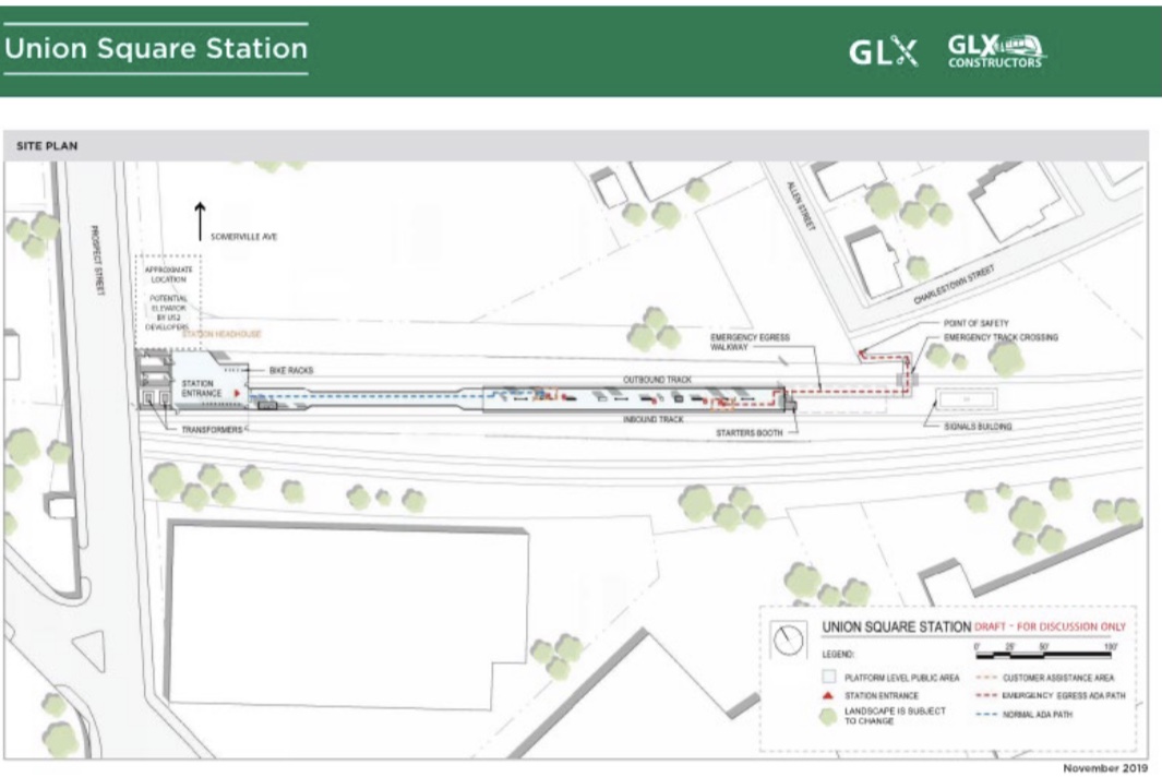

I appreciate the responses, but I wasnt asking about the sub stations or roads being in the way of future glx expansion. What I was asking about is how the tracks for the union glx station straighten out for the station while the CR tracks curve, will there be room to add new tracks to the end of the glx tracks or will they have to be replaced with a curve in the future? In pictures it doesnt look like there is room and not in the documents either.
It seems if you were to extend the tracks past the station towards porter you would immediately run into the curve of the CR tracks. So does this mean union will have to be ripped up and replaced in the future if an extension past union is ever approved? Maybe theres some room to move the CR tracks over some more to allow some room and keep the station? Something would have to give.
Looking at Google Maps, the CR alignment is straight in this location; the curve is simply the CR tracks transitioning to the center of the ROW. If they extend the GL to Porter, the CR tracks will have to be moved to the south side of the ROW and that curve won't be there.
Porter CR station bulbs out a little too much inside of the Somerville Ave. cut to fit both modes side-by-side with platforms, as that ADA/MAAB-spec 12 ft. wide island takes up a wee too much real estate to fit them both together via only manicuring the embankments/retaining walls. Therefore the GLX side would have to dip past Beacon St. overpass into a short tunnel. But the roof of said tunnel would literally form the new Fitchburg trackbed, and would probably be no more than a short ramp or 10 stairs down accessed by the current CR egress from the fare lobby. Say...10 steps down at that door for GLX platforms, 10 steps up at that door for the new re-leveled CR platforms sitting on top of the tunnel roof. The build makes even more sense in that if the tunnel ends up allowing the CR level to drop by 3-6 feet it would future-proof the Mass Ave.-Beacon St. cut for a formal air rights capping. Which would serve up any combination of: linear park, exit driveway straight from Lesley U./Porter Exchange parking lot to Somerville Ave., a long-overdue end to the use of cramped Roseland St. as a connecting thoroughfare if other Square traffic patterns were altered with the Lesley/Exchange lot, and so on.
