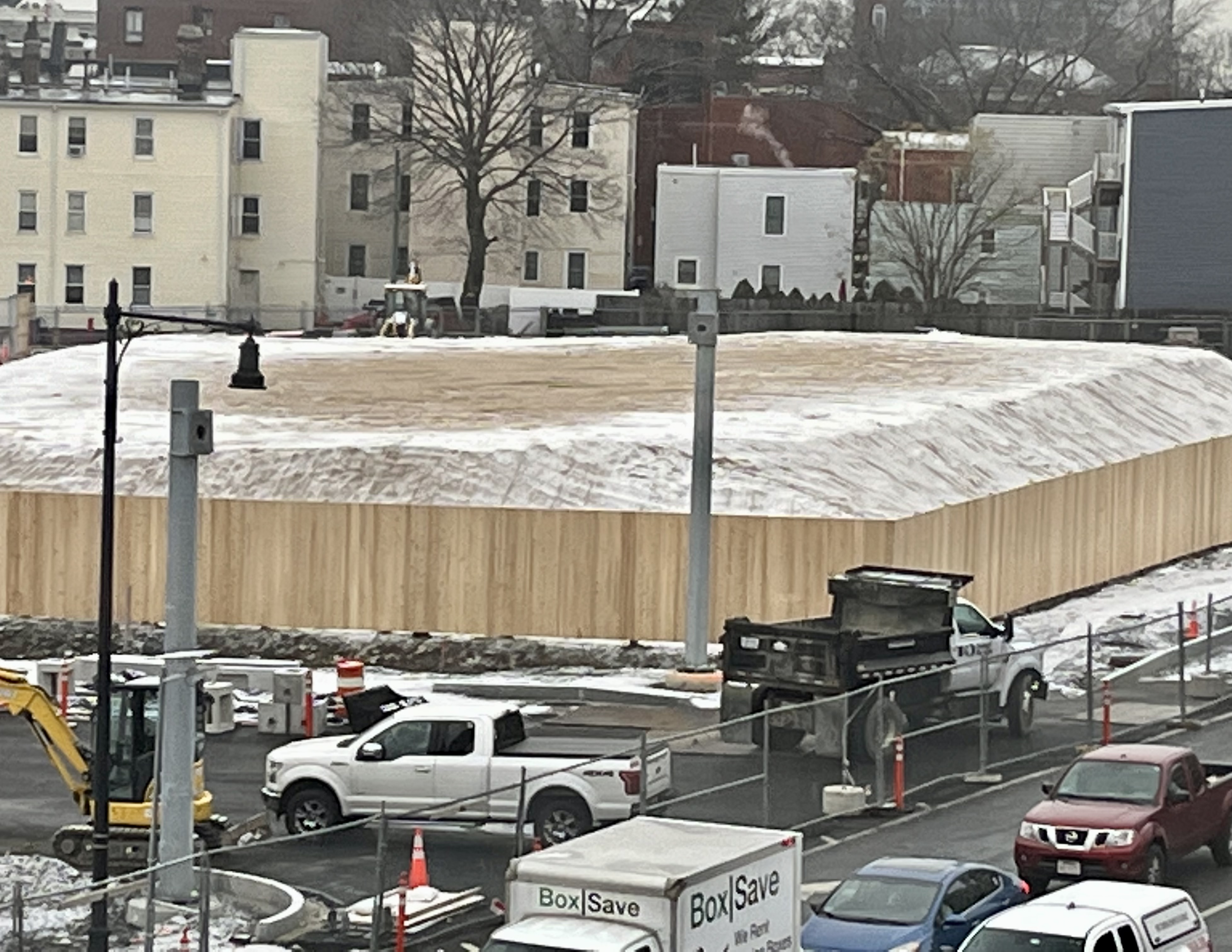

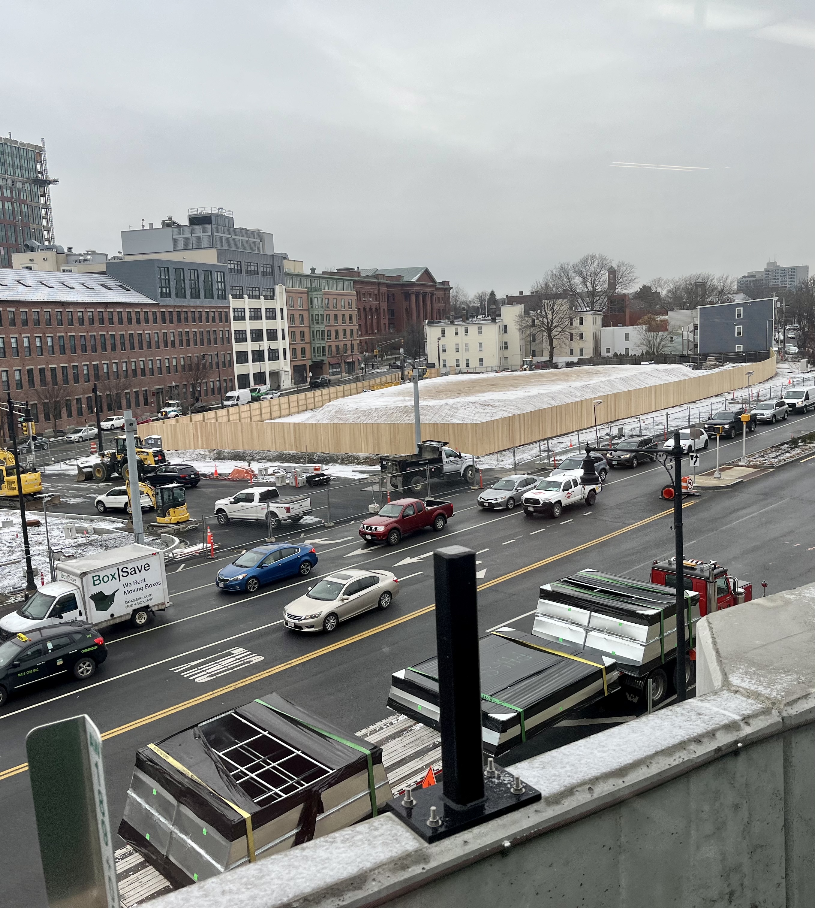

Old Lechmere reinterpreted as abstract land art? Title: Flattened Mound Inside Fence
View attachment 32921View attachment 32922

If the mound of dirt is for soil surcharging (which it appears it is) then they'd be prepping the soil for shallow foundations (footings). Doing so negates the need for deep foundations (piles) which are very costly, as long as the building isn't too tall or heavy. I would say having the ability to build this way makes the lot very attractive for developers and I expect it will not be long before something's getting built there.yup, so nice, I'm expecting that lot to be empty for a long time.

It almost looks like they are surcharging the plot, to consolidate the soil.
Interesting. So the idea is to put a huge amount of weight on the ground to compress the soil, then truck away what isn't needed? The compressed ground then serving as a more stable base?If the mound of dirt is for soil surcharging (which it appears it is) then they'd be prepping the soil for shallow foundations (footings). Doing so negates the need for deep foundations (piles) which are very costly, as long as the building isn't too tall or heavy. I would say having the ability to build this way makes the lot very attractive for developers and I expect it will not be long before something's getting built there.

That’s correct. It’s a more time consuming process than building deep foundations, but results in increased bearing capacity for the soil due to the compaction. DivcoWest/CX probably came to the clever solution of doing this after excavating all the soil from their neighboring properties. Rather than shipping it out for sale, it’s likely they decided to divert it for the surcharge load on this plot. You don’t see it very often around here as developer’s rarely are willing to wait months for the surcharge to compact the foundation to make a meaningful difference. The excess would then be trucked off for other uses leaving a much stronger foundation to build on. Obviously, the conditions have to be right to make this all work. I’m also speaking with no knowledge of the project and it’s possible that it’s just a pile of dirt, but I’m leaning toward this being a soil surcharge effort.Interesting. So the idea is to put a huge amount of weight on the ground to compress the soil, then truck away what isn't needed? The compressed ground then serving as a more stable base?
I believe some of the other photos showed some sort of storm water retention structure going in under the smaller triangle plaza/traffic island, so, seemingly they had a bit more extra soil and fill to work with too.That’s correct. It’s a more time consuming process than building deep foundations, but results in increased bearing capacity for the soil due to the compaction. DivcoWest/CX probably came to the clever solution of doing this after excavating all the soil from their neighboring properties. Rather than shipping it out for sale, it’s likely they decided to divert it for the surcharge load on this plot. You don’t see it very often around here as developer’s rarely are willing to wait months for the surcharge to compact the foundation to make a meaningful difference. The excess would then be trucked off for other uses leaving a much stronger foundation to build on. Obviously, the conditions have to be right to make this all work. I’m also speaking with no knowledge of the project and it’s possible that it’s just a pile of dirt, but I’m leaning toward this being a soil surcharge effort.

That would make sense.I believe some of the other photos showed some sort of storm water retention structure going in under the smaller triangle plaza/traffic island, so, seemingly they had a bit more extra soil and fill to work with too.
I think someone told me that surcharging is fairly common in the Netherlands not just for building foundations but also for infrastructure supports too. Would make sense that with their fairly water logged lands. Wonder why this isn't more popular on our coastal developments though. Other than time is there some other tradeoff in the construction process that makes it less appealing here?
