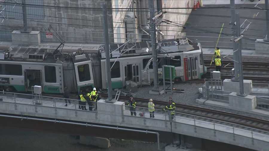

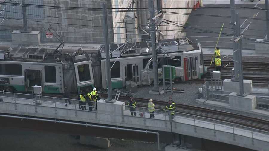

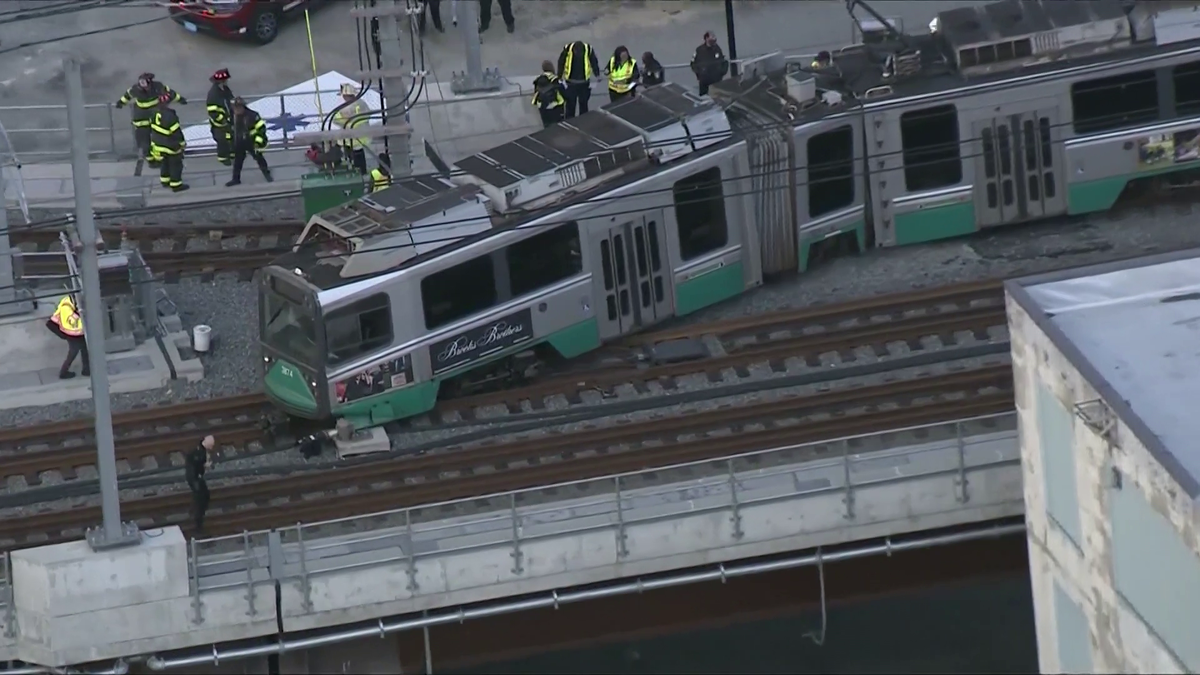

Here's the accident that occurred on the GLX. A derailment! A few months ago, I rode that line & I had three kids with me!! So glad that we weren't on this i'll-fated ride!!!! :eek:
Since this is the correct thread and it was wrong to use the General MBTA thread to begin with, there is a new article from WCVB posted October 11th, 2024.
Expect more (justified) grilling from the Feds about the total lack of ATP.
36 MPH in a 10 MPH zone and blew a double-red (absolute stop at interlocking) signal, which meant the switch didn't have enough time to reset itself before the train was passing over it. Total operator error/indifference.
Yup...we can't go without a speed-and-stop enforcement enforcement system any longer. They better have a very good explanation for how they're going to do better at the GLTPS contract award, Take Two.
