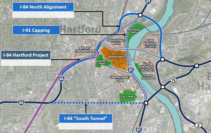

They're sort of thinking of this. There's a separate proposal apart from burying the Viaduct into a cut which would vacate 84 out of dead-center downtown. All of the same Viaduct sinking work would still have to be done between Park St. and Union Station as a prerequisite, but points east you would have:
  1. I-84 realigned in a combo cut with the Springfield Line out to the CSO RR freight yard to roughly where Xfinity Theater is.
  2. A new full interchange with I-91 by the theater (likely displacing the concert venue to more attractive environs elsewhere).
  3. New river crossing just north of the RR bridge. Infilling + partial relocation of the water dept. pump station retaining moat to create ROW.
  4. Slide onto alignment with the state-owned ROW once reserved for never-built I-284 (from your map), going south onto the Governor St. ramps (which are curiously overbuilt because it's the only part of that highway that got done).
  5. Revised CT 2 interchange and curve onto mainline I-84 alignment here.
  6. Demolish all of 84 & ramp sprawl from east end of Bulkeley Bridge to the Governor St. new/old alignment transition, compact CT 2 ramp sprawl, demolish I-91 ramps on Hartford side.
  7. Sink bi-level/quad-carriageway I-91 sprawl on Hartford side of river into unified cut (desired anyway, but removal of 84 greatly simplifies).
  8. Re-route US 44/Connecticut Blvd. over Bulkeley Bridge, connecting to Morgan St. as urban boulevard. This is what the bridge used to carry before 84 was built in the mid-50's. Possible parallel effort to turn Founders Bridge from CT 2 highway stub into similar urban boulevard.
  9. Re-zone all freed land in East Hartford from demolished highway for redevelopment.
  10. Redev demolished elevated or incline highway blocks Church St.-High St.-Walnut St. (2 large city blocks west by Union Station/"new" I-84 cut) and Main St.-Columbus Blvd. (2 city blocks east by river/I-91 cut)
  11. Find re-use for 3 blocks of vacated I-84 canyon cut, High St. to Main St. (Trumbull St. to Main already covered over for air rights park). Makeshift underground parking garage???

The Viaduct replacement is pretty much a no-brainer. But I like the downtown realignment for all the reasons above. Better for both the transpo that actually uses 84/91, better for transpo on city streets, opens up the redev parcels that can really jump-start downtown, showers the East Hartford waterfront with redev riches, accomplishes much the same 'boulevardization' goals around the streets feeding the river crossings without needing to engage the abject fantasy of cutting a major two-digit regional interstate short (which the feds would never allow under any circumstances), and makes an already beautiful waterfront that much moreso and better-utilized to boot. Shitload of money on top of the shitload of money for the Viaduct replacement, but all with a value proposition that has clear signs of a payoff.
EDIT: ConnDOT diagrams:
The "South Tunnel" is U.S. Rep John Larson's acid fever dream of Big Digging his way straight underneath everything. It's patently insane, but he's stanning so hard for it it's actually impeding funding for replacing the damn falling-apart Viaduct with the EIS'ed Preferred Alt. because he wants them to waste money studying his MOAR TUNNEL short-attention span theatre beforehand. You can pretty clearly see what the North Alignment relocation does to heal the fragments of Downtown and East Hartford, as well as simplifying the everloving shit out of 91 and the interchanges. Important to note: because it is just outside the project area for the Viaduct replacement, it doesn't have to be considered in-tandem with the Viaduct. They can sink that into the cut as if it's going to keep feeding the downtown canyon forever, then work the North Alignment funding separately. No Viaduct replacement work ends up wasted if they have to switch gears with a later-breaking go-ahead for the North realignment.
