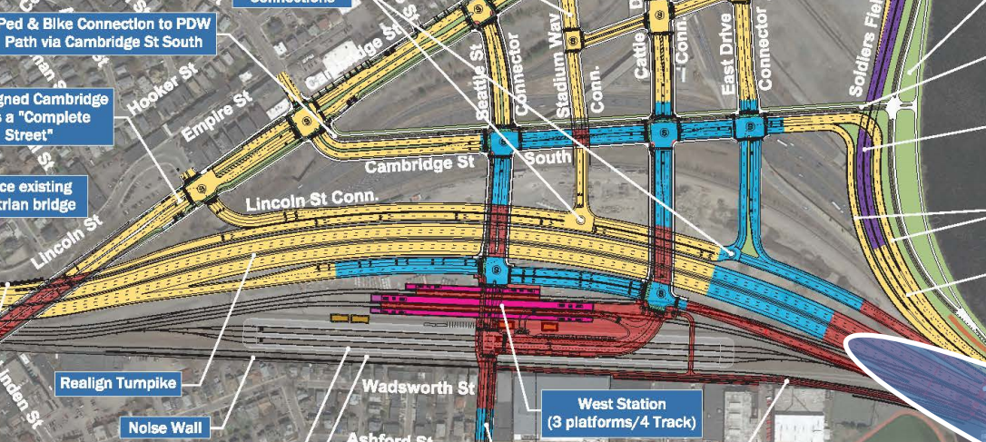

Wow. Not even a token deck park across from W. Station between the two overpasses to link it to the neighborhood. Between the Pike on one side and the layover yard on the other, West Station is going to look like Baltimore Union, minus the Beaux-arts waiting room.

Wow. Not even a token deck park across from W.station between the two overpasses to link it to the neighborhood. Between the pike on one side and the layover yard on the other, West Station is going to be Baltimore Union, minus the Beaux-arts waiting room.

Sadly, the real troubleshooting work with Beacon Park only begins after we fix the 'throat' impasse.
At this rate, by the time the throat design is finalized that image may as well be titled "High Tide in Allston."

By the time the EB SFR lanes transition under the Mass Pike viaduct, and then transition out, the actual length of EB SFR being fully under the Mass Pike viaduct is somewhat short, so it's really not worth it.
What about if SFR was sunk? If you don't move SFR otherwise (ie: no park right at the throat), there would be enough room to have the Pike at grade. The only viaduct you would need is for Grand Junction.
Because near the 'throat' SFR floods like a sonofabitch in heavy rain and when Charles Basin overtops. Sinking the infrastructure physically closest to the water is no-go in this one constrained spot because of the budget bomb the requisite waterproofing would unleash.
Well technically feasible (see Storrow EB by the Hatchshell), due to the tight width to work with, the construction phasing would difficult to pull off unless SFR was outright closed for the duration. Not to mention due to the proximity to the Charles, this would have to be treated as essentially in water construction, driving up the construction (and maintenance) costs up quite a bit. Obviously it would be nice, but the cost benefit isn’t really worth it for an additional 50’ of park.
The difference is that by the Hatch the roadway is 200 ft. from the Lagoon, and 400 ft. from the open basin. Storrow never floods there; the Lagoon causeway absorbs any/all of it before it gets within 200 ft. And that's not a 'good' tunnel by any stretch, either. Its cheap construction methods are a perpetual maint headache for concrete spalling due to groundwater dampness...but at least is 100% inoculated from flowing water. I don't think there's ever been an inundating event in the 80+ year history of the current parks + road layout of the Lagoon area.
BU Boathouse and Magazine Beach diagonal from each other are the most flood-prone parts of the lower basin, influenced by the bend in the river (and which side the wind is blowing through the bend) meeting moderate pinch point in the basin's width. There's simply no way you can inoculate against a 20-year overtopping event there with only the 25-50 ft. of berm to play with + 2-5 ft. riverbank elevation the whole length of the 'throat'. And that's just for the benign soaker events where SFR/Storrow are legitimately closed to traffic for several hours to day or two couple times per decade. Nevermind the 50- and 100-year flood events greater than "Flood of '96"-level that are the pants-shitting scary reality we now have to plan all infrastructure around. Even flipping the Pike side for a cut is going to be a monstrous budget bloater for required drainage above-and-beyonds because any buffer width + width of surface SFR pavement you'd be talking is still not nearly enough to stop an overtop of the low shoreline from sending a linear Niagra Falls over the Pike WB wall. With closer you get to the easterly/BU Bridge project limits the higher the risk soars.
'Throat' resides in the legit toughest stretch of river for flood protection. It isn't for lack of imagination. That bend+pinch in the basin is a physically/hydrologically maximal-difficulty inflection point not found to any halfway comparable degree anywhere upstream or down. Chalk it up to rotten luck that the max-difficulty waterproofing point matches up almost 1:1 with the 'throat' project area.
