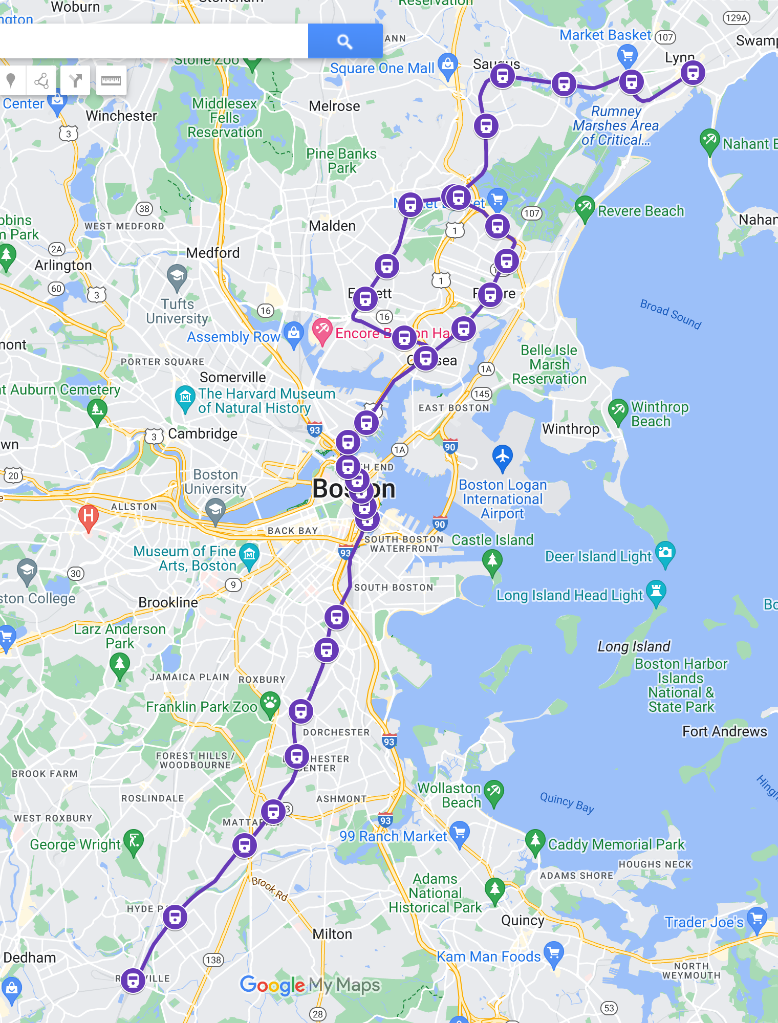

Presenting to you, my take on the Indigo Line:
Google Maps link here.
This proposal has some similarities to Aprehensive_Words's "Blue Bobby Pin" proposal by as well as F-Line's "Red X" proposal, but it was developed independently - I just took a long time to sketch it up.
The motivating question behind it was: Which parts of Greater Boston still needs a rapid transit line?
South
As of today, there are two significant transit deserts to the south: Nubian/Warren St corridor, and the Fairmount ROW. The former is more easily handled with various LRT proposals, so I focused on rapid transit conversion for the Fairmount line.
I know F-Line has explained why Fairmount can't be taken off from the FRA network... So let's just leave it as God Mode handwaving lol. Although you can instead do Red X as per F-Line's proposal for the southern half (converting one of the Red Line's branches into a separate line), and still follow the same route to the north.

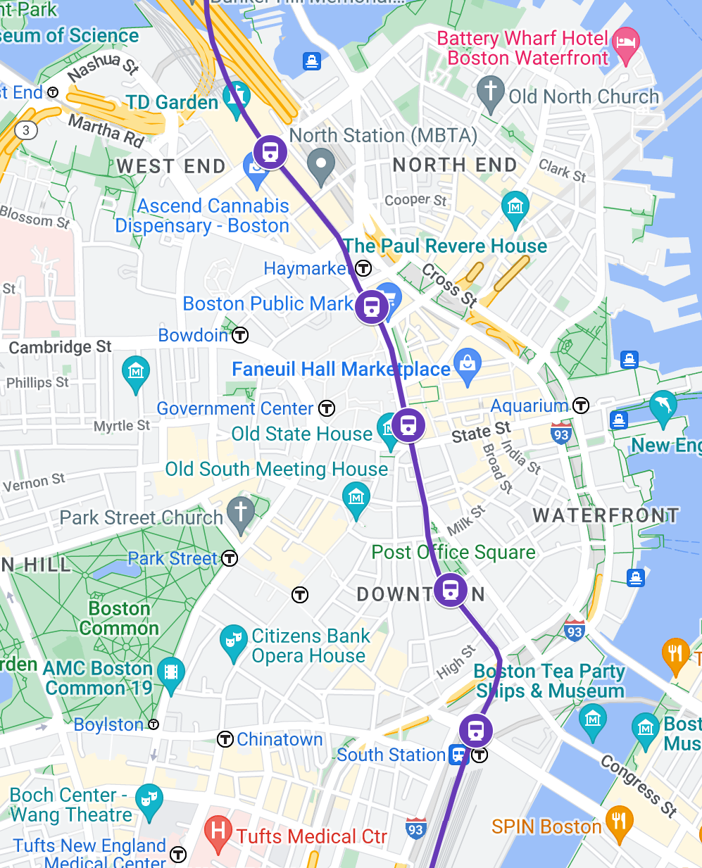

Downtown
The main goal here is to add a station at the heart of the Financial District, right at Post Office Square. Despite the area being surrounded by rapid transit stations at all four corners, many offices are just a bit out of the way. My Indigo Line would immediately offer connections to all other rapid transit lines.
A North Station-South Station subway link is also nice, but not the intention, as this clearly has a smaller chance of happening than NSRL.
An alternative routing I considered was to head into North End via Hanover St and cross into Charlestown from there, but I ultimately felt it wasn't worth it.
North
Assuming no heavy rail conversion for GLX, the transit desert is clearly the vast space between Orange and Blue lines: Charlestown, Chelsea, Everett, Revere. Urban Ring can offer circumferential service, but they do have the density for a radial service.
Charlestown and Chelsea can be easily linked via a God-Mode tunnel in the vicinity of Tobin Bridge. But then you face a choice between Everett and Revere, and both are just a bit too far from Orange and Blue lines. Here, I present both options, and I'd say both have good arguments for them.
Regardless of which city you pick, a tunnel under the respective Broadway will probably work best, though also expensive. Both options rejoin at Linden Square (the Revere alignment has the additional benefit of serving Northgate shopping center while doing so). I did consider following Route 1, but the density and land use along the highway ROW is not great.
Far North
This is more of a "nice to have" situation, but since the old Saugus Branch ROW exists, why not? This brings us to Saugus Center and West Lynn, before joining BLX and Regional Rail at Lynn. Alternatively, you can turn it west from Saugus Center to Square One Mall. Saugus doesn't deserve a heavy rail line today, but hey, we're in God Mode, right?
Everett definitely should be the alternative route selected. Revere already has the Blue Line, but Everett has nothing, and is a very densely populated city.
While Blue Line does enter the City of Revere, most parts of the city are still quite far from the stations.
A bus ride to Everett City Hall takes 7 minutes from Wellington, or 10 minutes from Sullivan. A bus ride to Revere City Hall takes 9 minutes from Wonderland on the shorter 117 bus (10 minutes from Revere Beach factoring in the walking), or 12 minutes on the longer 116. If we're using the city centers as a proxy, I'd say they're about equidistant from existing rapid transit stations, and both are outside the walkshed.

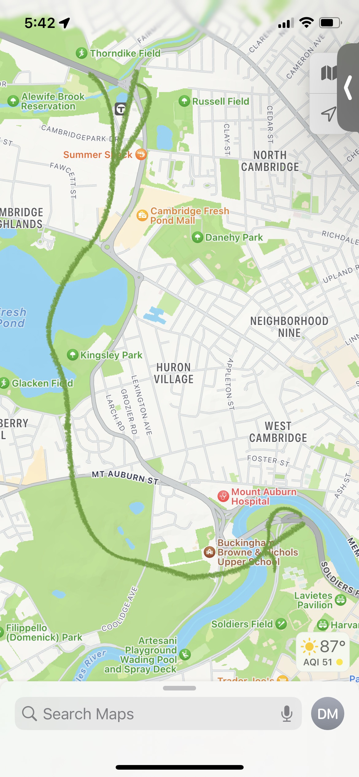

Behold! The Mt. Auburn Tunnel. Knock down the Spiral Alewife Garage Entrance that people rarely use and bury it to Soldiers field Road.
What I experienced today on this road was the result of abject policy failures. In short, I was disgusted at how long it took me. No rhyme or reason either. Maybe too many happy locals crossing the street one after another. What should take forty-minutes TOPS from Lowell area took me 1:15. No rhyme or reason. And this stretch was the culprit.
If I ever get that Elon/Zuck money, one of the first things that I’m doing is I’m building this. Because this can’t keep happening. That stretch of Alewife and Soldiers Field is pitiful. There’s no other nice way of putting it.
If I ever get that Elon/Zuck money, one of the first things that I’m doing is I’m building this. Because this can’t keep happening. That stretch of Alewife and Soldiers Field is pitiful. There’s no other nice way of putting it. View attachment 40170

What if Boston gets a 4th heavy rail line?
This really sparked my imagination. As I think I've said before, crayoning radial service to Chelsea and Everett creates a really interesting challenge -- even in God Mode -- because it's entirely greenfield. No abandoned ROWs for us to stick to; it's entirely open-ended.
Some individual comments:
Yeah, I tend to think of this as the domain of the Red X. The northside corridor I pairmatch Fairmount with on my crayon maps changes every day, which I think reflects the practical reality that there are pros-and-cons to each mainline corridor, and it will just depend on the eccentricities of the moment.
(These days, I tend to sketch Fairmount <> Waltham due to excess capacity on the Fitchburg Line. But in the past I've also favored Fairmount <> Lynn/Peabody, depending on how high the Fairmount frequencies are.)
That being said... particularly in God Mode, there's no reason why your new northeast tunnel couldn't be built to accommodate mainline vehicles. I mean, the main reason, I think, that you couldn't would be that it puts limitations on the grades you can use (and to a lesser extent how tight you can make your curves). But if you're planning to TBM the whole thing and you're willing to live with deeper stations, then I don't see why not?
This is how I crayon a Congress St subway too, though I think it's worth noting that you could potentially get away with a consolidated State + Post Office Square. Some diagrams:
The current situation (platform positions etc are approximate):
A two station alt, with a Post Office Sq station centered on Franklin St with a southern headhouse at or south of High Street:
A one station alt, with a platform spanning Post Office Square and a southern headhouse around Franklin St; the connections to Devonshire and Milk stations are a bit on the longer side, but still in line with the Winter Street Concourse and the Blue <> southbound Orange connection; the connection to northbound Orange would be the longest, but it would be offset by a connection at Haymarket:
In terms of the southern end of the station, the difference between a Franklin St and High St headhouse is not huge in terms of filling the walkshed gap.
The current gap of 5-min walksheds:
A Franklin St headhouse fills most of the gap:
A High St headhouse only shifts the walkshed slightly (layered on top in reddish-pink):
So there's clearly a tradeoff -- the two station alt definitely provides a better transfer to Blue (although honestly the transfer to Orange isn't much better than the one station alt), but the one station alt would be that much less expensive and ultimately provide faster service.
This is probably a scenario where tunnel depth would impact station placement: if the thing's gonna be buried super deep, then I say we leverage long diagonal escalators to spread out the walkshed as much as possible.
Yeah, this is where the fun begins. This is indeed the transit desert, and I think you could argue in favor of multiple radial services through here: from Wellington to Orient Heights is 4 miles; Wellington to Harvard is 3 (which of course is halved by the GLX), while JFK/UMass to Jackson Square is about 2.5. (Even Jackson Square to Harvard -- skipping over multiple radial corridors covered by the Green Line -- is only 3.5 miles.)
Three miles from the system center, the radial corridor spacing is generally about 2 miles, but there are cases where it's closer to 1 mile (depending on where you define your corridors to be):
  • JFK/UMass <> Uphams Corner: >1 mile
  • Jackson Square <> Huntington Ave/Brookline Village: 1 mile
  • Brookline Village <> Packards Corner: 1.5 miles
  • Packards Corner <> Harvard: 1.5 miles
  • Harvard <> Union Sq: 1 mile
  • Harvard <> East Somerville: 1.5 miles
So, yeah: if we use 2 mile spacing, that points to one corridor between Orange and Blue. But if we use 1.5 miles, that points to two corridors if not more.
One thing I'll note from the examples above: the spacing between heavy rail corridors tends to be about 3 miles, with light rail corridors interspersed. So I think the question of how many corridors and where they go is impacted in part by the kind of service that is provided -- which brings me to the next point.
I agree that both Broadways make for strong corridor candidates. But I think you may be too quick to dismiss Route 1.
First, the 111 -- the closest thing to a blueprint for radial service -- actually adheres pretty close to Route 1:
The biggest deviation is to Cary Square, which doesn't get covered well by a Route 1 alignment -- but I'll note also doesn't get served by a Broadway alignment either.
Now, the first thing to point out here is that the northern half of the 111 runs parallel to Route 1, but does so on a proper city street, as opposed to a highway ROW with that much less accessibility. And this is a good point!
But, at the (very reasonable) three-quarter mile stop spacing you are proposing, a Route 1 alignment would probably only have stations at Woodlawn and Revere Beach Parkway-ish -- both locations where a highway station walkshed would overlap pretty well with the bus route's walkshed (particular with concurrent pedestrian access improvements). The local stops along Garfield and Sagamore Aves aren't gonna be replaced by a rapid transit line either way. (What would happen likely is the 111 getting cut back to a transfer station in Chelsea, a la Dudley in the days of old, which would improve reliability on the route as a feeder service.)
And it's a similar story to the south: after Revere Beach Parkway, you probably aren't going to have any intermediate stops until you hit the commuter rail line (at which point the Route 1 alignment probably provides the best access to the current Bellingham Sq station, and affords a slightly long, but still viable, connection to the Chelsea commuter rail station).
So, yes: much of the Route 1 ROW is located away from density and development. But at key locations along the Route 1 corridor -- the places where you'd put a station -- its access is relatively favorable.
And this is where we come back to what kind of service this is: if it's a Cambridge Subway-style route that is designed to link up transfer stations (e.g. to local routes along Park Ave, Revere Beach Parkway, Washington Ave) at high speeds, then I think the Route 1 alignment is a reasonable contender (and potentially one that could move this proposal out of "God Mode" and into "Crazy Transit Pitch" territory).
If, on the other hand, this is meant to be more of a Blue Line/Green Line-style route, where the radial service itself is providing the "local" service -- akin to the Revere section of the Blue, or the Ashmont Branch -- then I think you're looking at closer stop spacing, and the Broadway routes become more favorable.
If we're in true God Mode, though, I'd suggest an HRT line along the Route 1 corridor, with a pair of LRT lines along each of the Broadways. No idea where I'd connect the LRT lines to the south, but that's an exercise for another day.
Finally: you could also reroute the Orange Line through Everett, and use electrified Regional Rail service to keep modest frequencies to Wellington. You can keep service to both Sullivan and Malden Center, and you can even continue the Orange Line north to Reading if you want. If the Chelsea subway is a Red-X extension, express service to Sullivan + Wellington + Malden Center could be the pair-match for high-frequency Fairmount service.

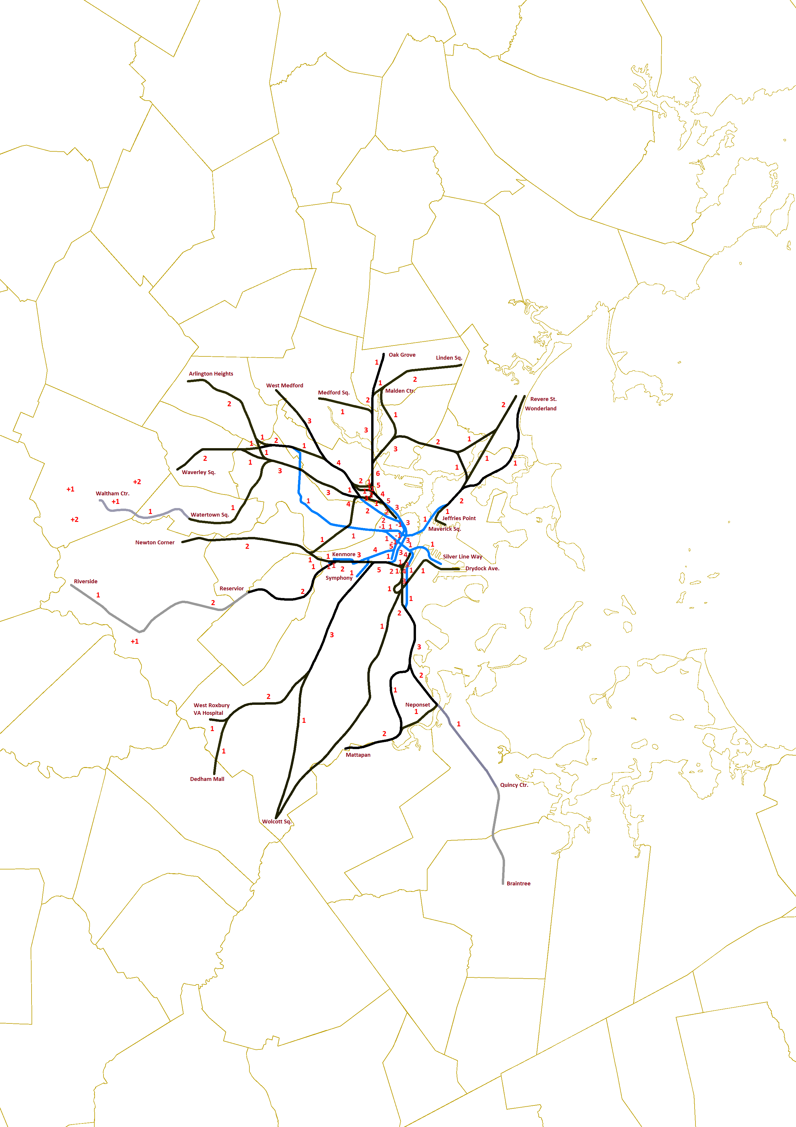

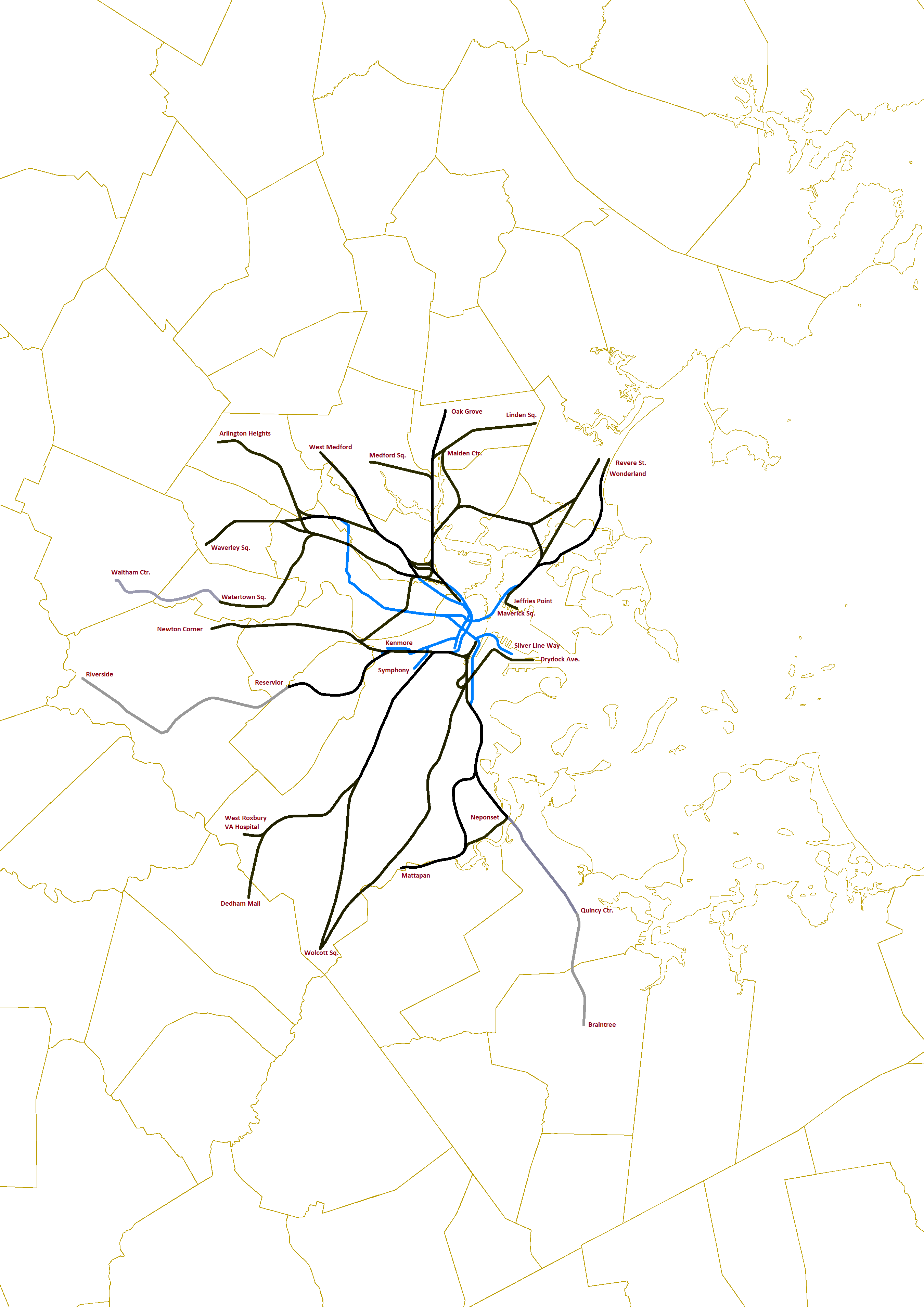

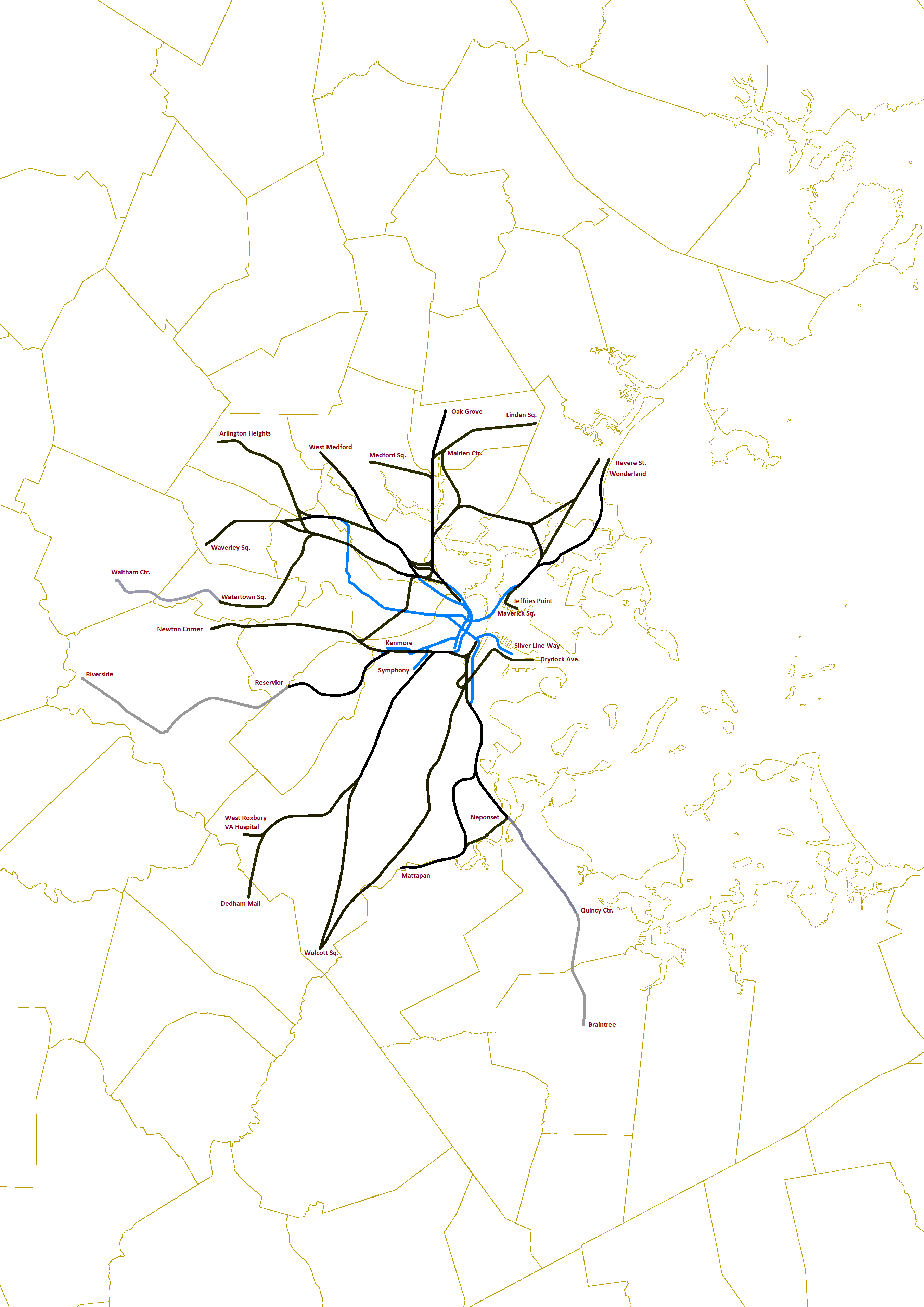

Alright, I went back to this map to try to wrap my head around how to interline these routes. So I came up with this extremely messy map showing the minimum number of branches that form each main trunkline on this map.
-1s appear since I used the Park St, Gov't Ctr, North Station terminals for the GL tunnel, and Charles MGH is set as a terminal with a -1 since the Alewife junction hurts my brain if I sent 2 branches up to Davis (the same goes for the GLX so that's why 3 branches end in W Medford instead of Davis; 4 branches feed into the GLX from East Somerville). Silver Line Way is a dead end at South Station.
This map is mostly for running metro/subway level freqencies in the dense inner core. Intercity rail is irrelevant to this map.
The segment between Assembly and Sullivan has the most lines feeding into it. There are at least 6 different routes that need to feed into the trunk minimum in this location. So headways under 6 min on the branches are <1 min in this trunk, 12 min branches = 2 min in the trunk.
Also fascinating how north of Sullivan divides cleanly into 3 branches to Wellington and 3 branches into Everett. There's a lot of service needed on the east side of I-93 north of downtown, that is sorely lacking.
The segment between Tufts Medical and Back Bay has at least 5 branches feeding into it from the southwest.
Would be nice to see if the routings on this map could be optimized (only note is not to add more lines onto this map, use as many existing lines as possible). Through running hurts my brain since one has to decide who has to transfer and who gets the single seat ride, or add more branches to make service patterns cumbersome). Plus, there's folks who can optimize wayyy better than me. Mostly I just wanna have somewhere to put this down with the number of branches in each trunk. I'm sure there might be some junctions in Alewife, Kenmore, South Station, or Sullivan that are redundent and don't really serve a useful purpose, or a branch line in East Boston or Neponset that aren't that valuable, but I wouldn't know which ones are unneeded.

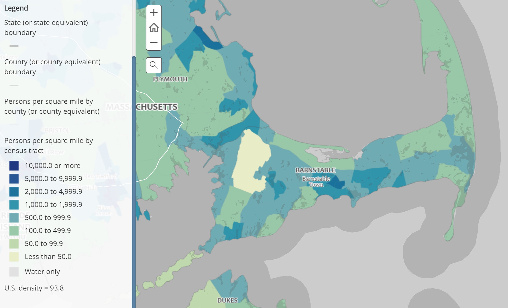

The latest estimates just for the Sagamore Bridge are about $2.15 billion. Both bridges together total $4.5 billion.
The Cape Cod Regional Transit Authority has budget this year of $18 million.
Even if you spread the cost of the Sagamore over a 100 year life span (and assume it will require zero maintenance for the next century) we will be spending more money on one highway bridge than we do on public transportation for the whole of Cape Cod.
I don't really know what to do with this fact. I understand the reasons to rebuild these bridges. Once a place is really car dependent, like much of the cape is, it makes obvious sense to maintain that network. People depend on it. But at the same time these decisions lock us into that car dependency for decades to come. It's frustrating to remember all the other similarly priced public transit projects that are considered "too expensive" and will get repeatedly shelved for decades to come. And I think, jeez, for $4.5 billion you could build out a public transit network so good that cape locals and tourists would hardly need a car at all.

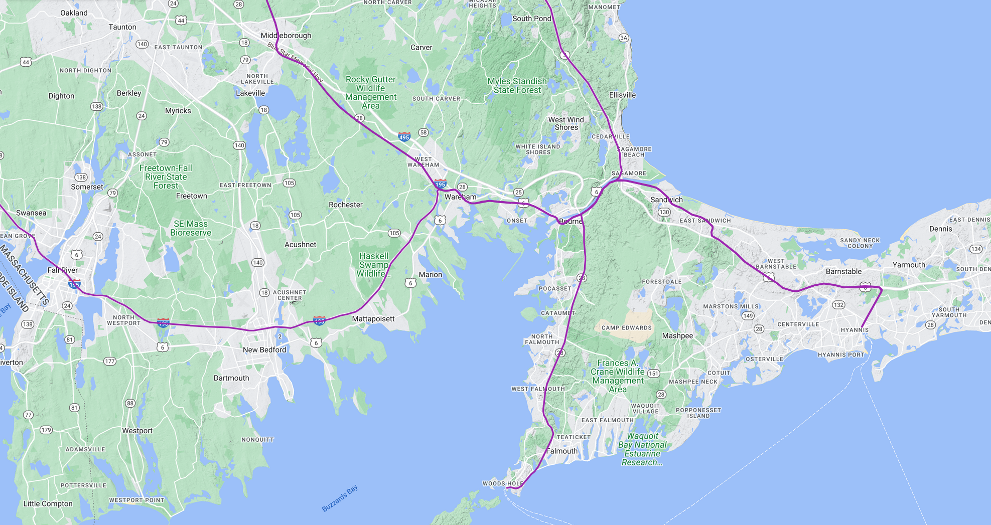

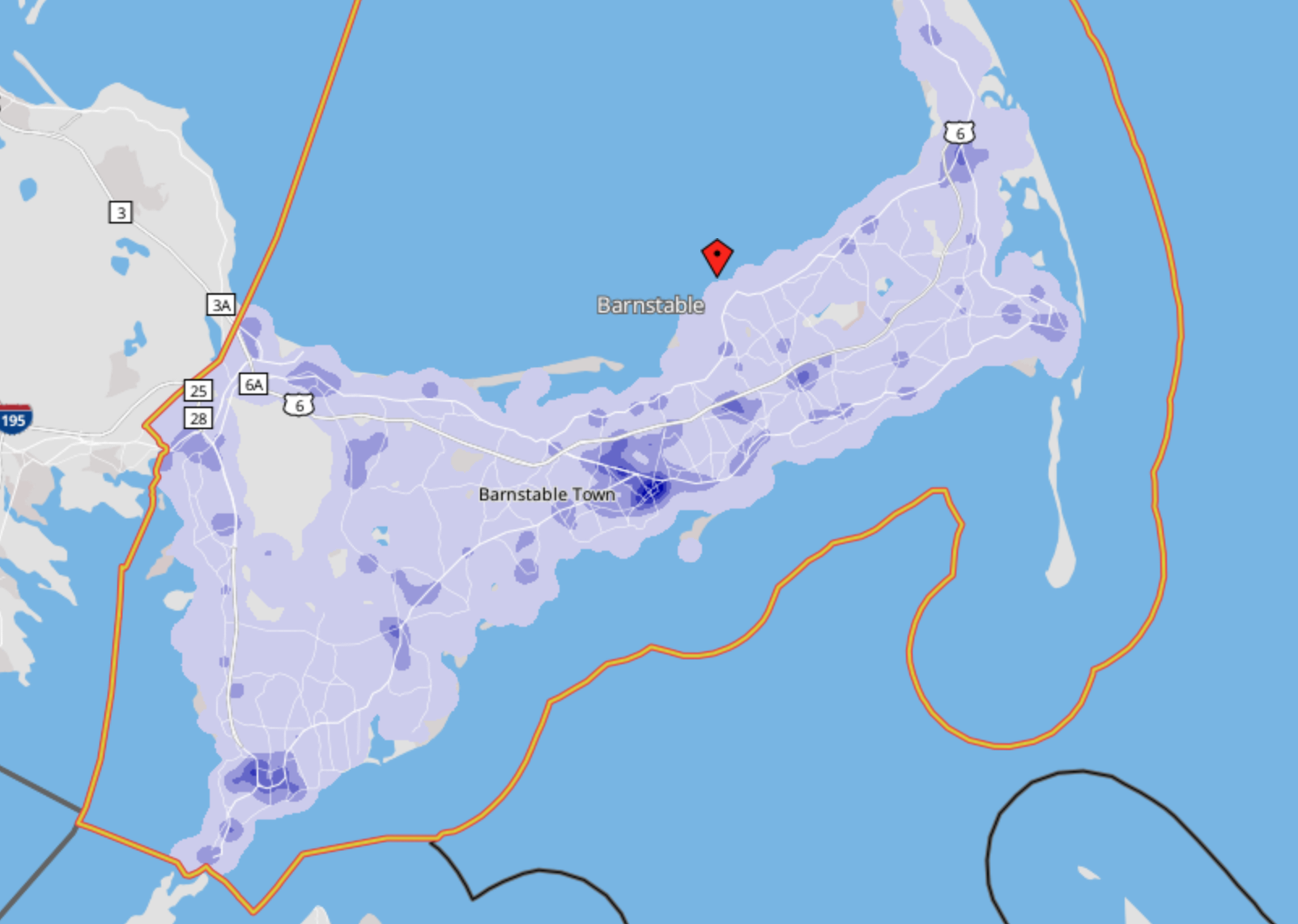

@ritchiew's post about the Cape bridges reminded me of a cross-canal rail scheme I doodled a few years back after a weekend trip left me spending way too much time stuck in bridge traffic. This is more for illustrative purposes (for example, it makes liberal use of highway medians and there are a couple points at which I suggest driving trains through the Back 40 of Richie Rich's property, or on an elevated guideway across a corner of conservation land likely visible from multiple mansions) vs a thoroughly thought-out plan, but it lets me raise a couple ideas that I suggest should inform ideas to improve Cape train travel.
  1. It's not sufficient to think about Hyannis<>Boston. Given the Cape's labor struggles and the seemingly-insatiable appetite to vacation there, we need to think about giving workers car-free mobility options, in addition to tourists.
  2. .This covers folks in places like New Bedford and Fall River, but also people in Plymouth, Middleboro etc. where you're still close enough to the Cape to drive but home prices aren't nearly so awful if you're making Cape Cod money and not Boston money. The Globe highlighted this earlier in the summer, but the region's resistance to housing development and water quality problems from all those septic tanks means it's going to be wicked hard to build the housing needed in Barnstable, Falmouth, etc.
  3. The Cape is big enough and local roads narrow enough that a Hyannis-only focus for rail projects, while a great first step, is limited in its ability to create mode-shift even with a beefed-up Cape RTA.
  4. I don't have a sense of how frequent shipping traffic on the canal is, but IIRC isn't it kept open most the time, only being lowered for scheduled trains? That suggests that it's worth debating the trade-offs between using a Bourne Bridge replacement project to build a combined rail-and-road bridge. Is enabling more frequent and reliable train service on-Cape worth being forced to nuke walk-up stations in downtown Wareham and Bourne, and restrict how you can feed off-Cape train service to Falmouth and Pocasset?
I continue to find this to be a fascinating exercise. I'm reminded of something I thought of when you posted your first version of this map: the subway tunnels are the original North-South Rail Link. The Highland Branch, the BRB&L, the Old Colony branches, the New Haven to Forest Hills, and maybe to a lesser extent the B&M Western Line to Malden, these were all mainline branches that ran modestly high frequencies and terminated at a stub-end terminal before their conversion to rapid transit enabled through-running. But yeah.
Which to me prompts a question about trunks and branches. Kenmore and JFK/UMass are both about 3 miles-ish from the core, so let's assume for a minute we want dedicated trunklines within that radius to avoid branching. The circumference of a 3-mile radius circle is just under 19 miles. Corridor spacing varies; building a radial route every 3 miles, you get six trunklines, which is similar to what we have today (where the Green and Blue form a pair of "half"-trunk lines, GLX notwithstanding), while at 2 miles you get either nine or ten trunklines, which would require five crosstown subways to pair-match.
Maybe more ramblings on this topic later, but those are some initial thoughts I had.

I feel like there are two distinct but interrelated problems at play here:
  1. Getting people across the canal
  2. Getting people around the Cape
I really do wonder about a park-n-ride in either Wareham or Buzzards Bay, connected to a bus transfer hub in Bourne via a high frequency shuttle pinging back and forth across the bridge (idk what "high freq" means in this context, but either way). Not that there would be ridership for it, but a train can cram the better part of 1000 people onboard, which would remove a lot of cars from the bridge.
But that brings us to the second problem. It's true that there are job concentrations in both Hyannis and Falmouth, but that still leaves a lot of jobs that are heavily dispersed, which makes transit planning that much harder:
This again makes me think about the niche for "suburban light rail", where you can use rail vehicles to get higher capacity and utilize the rail bridge, while still being able to more closely interact with cars and pedestrians for, e.g., limited street-running to provide better access to destinations, and more permissive curve radii.
But that in turn means that you can't reuse the existing rail ROWs (unless you are willing to completely forgo the OSR to Boston as well as any freight access, or unless you manage to do a River Line-style timeshare), at which point we're just talking about building a greenfield light rail network for a region where the density barely exceeds 1,000 people/sq. mi. in all but its densest regions:
Which is what brings me back to an off-Cape PnR + rail shuttle + transfer hub in Bourne. (Could be a good use case for pulse scheduling too.) I like the idea of the shuttle being supplemented by an OSR from Boston via the Cape Flyer, and I think some sort of Cape Codder v2 originating in Taunton or Providence (if not beyond) could be a good thing to add to the mix.
Reminder, your population per square mile does not reflect tourist density in summer months (as far as I know). That would present a very different picture, I suspect.
