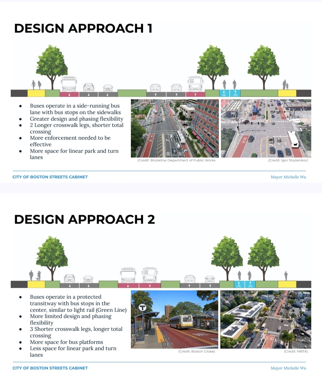

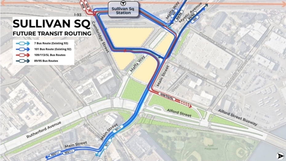

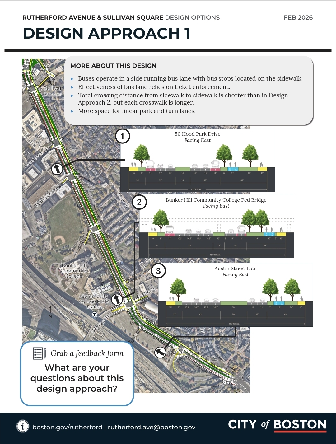

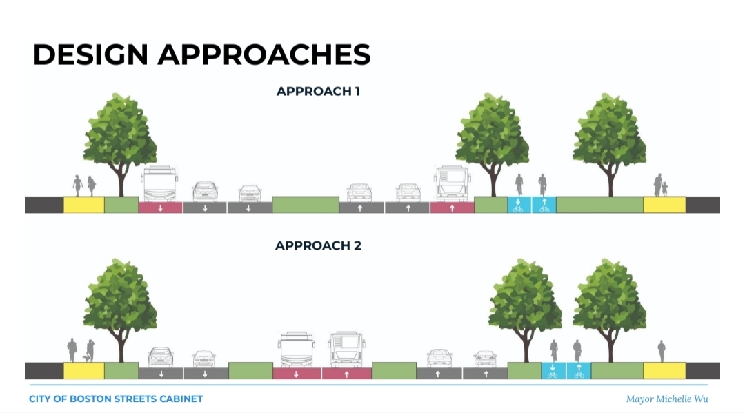

Keeping in mind the underpass is going away, it looks like the draft plan (as of April 2025) was to have a separated transitway on the western side of the alignment once off the bridge, with the bus lanes transitioning to the bridge north of Arlington Ave - based on how the bus lanes are laid out in this draft, it would appear to be more compatible with side running lanes than not.
Also, apropos of everything else, I just happened across the following: Apparently the City of Boston will be doing the first public presentation on its plans for Rutherford Ave/ Sullivan Sq in 3 years - this appears nowhere on the city website, and doesn't appear to have a webcast available, so hopefully someone will be able to attend and post slides.
I would expect that it's because the station is on the west/north side of the underpass so it might tie in better on that side of the street? I don't see how the work the northern end of things tho.
If you check the Locally Preferred Alternative part of the SLX study, it seems like they landed on the side-running busway configuration as a part of that process. Probably side compared to center for a few factors (fewer intersections to deal with on the Casino side of the corridor, better for an uninterrupted busway facility - I’m sure it’s better for the bridge crossing too if the Sullivan Square underpass is gonna be removed).
Didn't see that they had specified the busway like that. I breezed through reviewing that document again - but - did they specify why? I don't see much of any discussion on benefits or drawbacks of the northern side being that, at least in the T's words.
