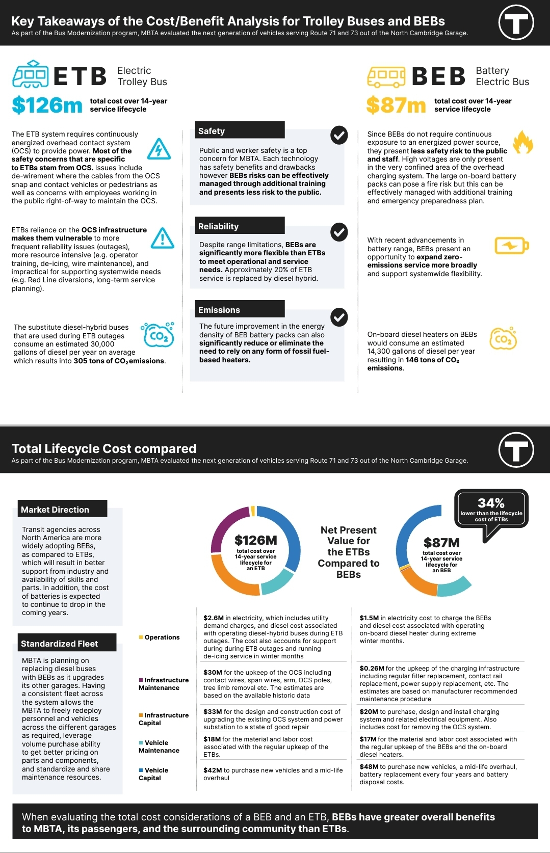

The MBTA recently posted a short "Key Takeaways" about the life cycle cost differentials between maintaining trolleybus service and switching to BEB for the 71 and the 73. It's only 2 pages, so it's all below. I'm not qualified in the least to vet these numbers, but it seems to justify the MBTAs desire to pull down the wires, even if keeping the wires makes sense for enroute charging.
Transit Matters ripped the hell out of this document on their Twitter account a while back. The T's math is still funny.
Seriously, I get the T's reluctance to keep maintaining a fleet of busses that lengthen operator training by weeks, can only be used on two routes, and require specialized maintenance personnel to run. Instead of getting rid of the wires, though, the T should be expanding the system-which would make sense from an environmental, economic, political and social perspective. Replacing the TT's with diesel busses will result in more operator and equipment hours being needed to provide worse service.
This feels like the T cutting of its nose to spite its face. Even back to the MTA days, trackless trolleys were always seen as stopgaps in Boston, and only a lack of money prevented us from becoming one of the many cities that ripped out their trolleybus wires in the 50's.
Kinda touches on something in that MBTA slide that bothered me; the apparent (presumably intentional) decision to omit any discussion of benefits to upgrading (and expanding) the wires and use of them. I mean, obviously it's going to look horrible on a cost-comparison basis if you're talking about just the Cambridge service, wired or battery, but there's absolutely nothing there about the fact that if you keep the wires you can use battery-ETB hybrids to run and charge under the wires then run full-electric the rest of their routes (completely removing the diesel hybrids from the 77 seems like low-hanging fruit). Add that to the part they don't bother mentioning at all, which is their own plans don't call for enough BEBs to cover the service without either cuts or diesel backfilling, and it's patently obvious that this isn't about what's best from a system perspective or environmental standpoint, it's about them not wanting to maintain the wires. (Sadly in character for them, though I'd be surprised if Cambridge doesn't put up one hell of a fight.)
This is all about the Ts irrational dislike of catenary maintenance. The present wires(N Cambridge, Seaport Transitway, B Branch and E Branch) could support 12-4% of the present fleet, and just wiring Blue Hill Ave would get it closer to 17-9%. Instead we will continue to kill people with diesel heaters. Because MBTA convenience is more important than kids lungs

The simple fact remains that the T shouldn't be replacing the ETBs with inferior replacements. BEBs (especially in the numbers they earmarked for ETB replacement) don't have the capacity to replace the Neoplans without service cuts or diesel hybrid backfilling for however long it takes the fleet to more fully turn over (and the former, cuts, are already acknowledged as part of the plan for the North Cambridge-based routes, which already saw reductions from the T not buying enough of the Neoplans to cover the old Flyer fleet).
It really does seem like it's all about them hating the wires (especially that they've repeatedly proposed converting the Blue Line to full third-rail, including recently). Even looking past the benefits that could be gained right now from bootstrapping the wires to extend electric service to places currently served by diesels, the actual plans screw over Cambridge with BEBs (with diesel heaters) that also can't cover the pre-pandemic electric services (because they're not buying enough). It seems like they reached a point where they could just about make the math work to make it look like the BEBs were better on paper (though TransitMatters - and F-Line, as usual - eviscerated the fuzzy math pretty quickly) even though in reality there's still a ways to go before the technology is mature enough for a city with this nasty a winter climate (time that could be well spent on a BEB/ETB hybrid that actually improved service).
