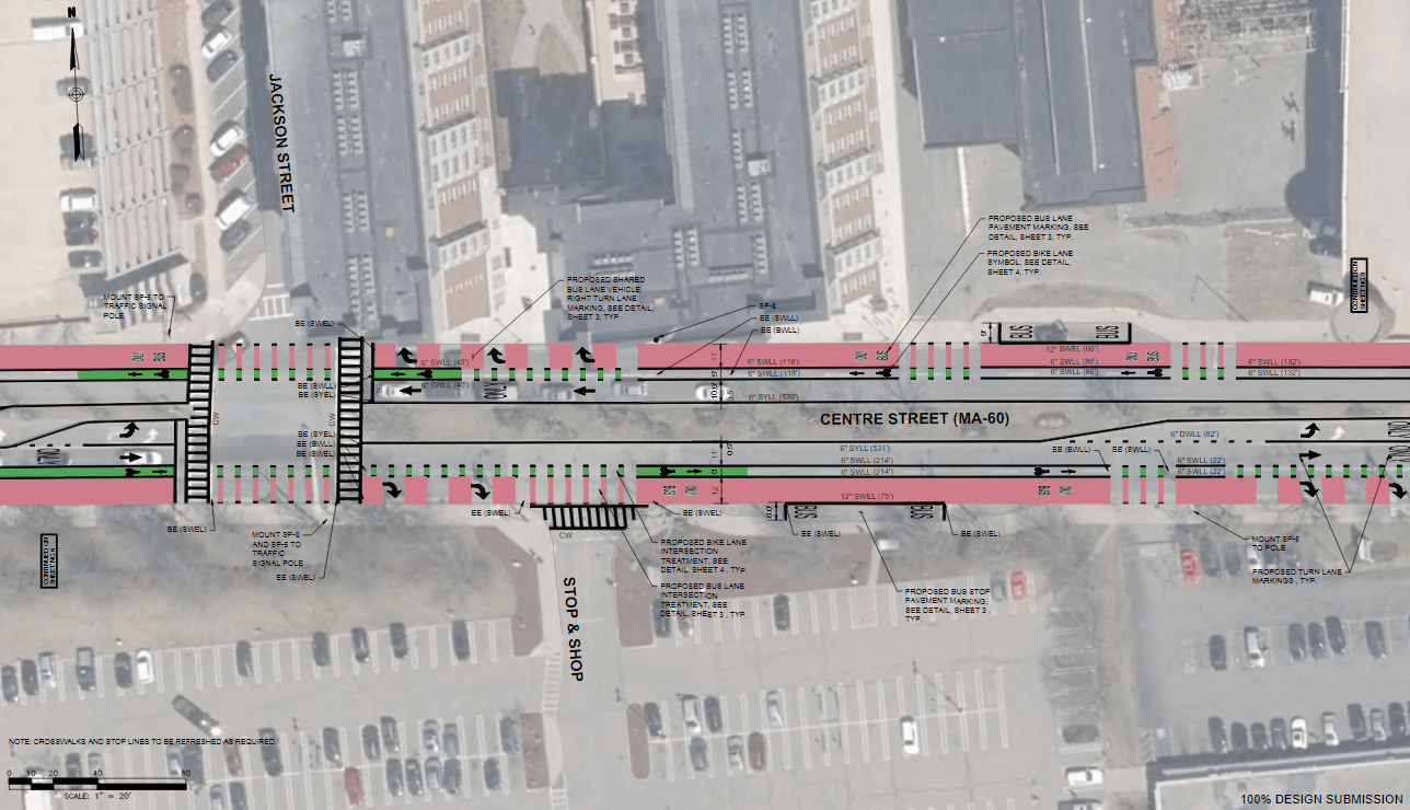

MBTA bike and bus lanes have been striped on Centre St in downtown Malden, with more markings going down. Here's a page showing the final layout with the grants they received: https://www.cityofmalden.org/853/Lane-Changes-and-Signal-Improvements-on-
Hopefully this paint-only project will be successful enough that the whole street can someday be fully rebuild with center-running bus lanes and above-the-curb cycletracks.
Here's one segment (follow the link above for more)...
Center-running bus lanes should have been painted. The curbside bus lanes will be used as parking by delivery trucks and people "temporarily" parking.
I'm not sure if you're familiar with Centre St in Malden, but it doesn't really make sense for people to park in the Centre St bus lanes. Most of the road is lined with strip malls set way back from the street. I don't think it will be much of an issue. A grant that only provides enough for paint isn't going to be enough to rip out the median, build new bus stops, change the drainage, rearrange the stoplight setups, etc.
This looks like it will be quite good for bikes, as riders will presumably ride in the bus lane most of the time, rather than the car traffic adjacent green lanes. Really, the green paint is more of a buffer than a usable lane, but as I said, the bus lanes will work well for bike riders.
Agreed that it should be center-running for sure, but that's really hard to do with a quick-build pilot in a smaller city. Infrastructure along that road is rough, so hopefully a successful pilot sets them up for a center-running project like Columbus Ave down the line.
I find the bike lanes sandwiched between the travel lane and the bus lane to be very peculiar. That can't be very comfortable from an all ages and abilities standpoint. I would much rather worry about an occasional bus merging into a bus stop than to have vehicles passing on both sides of me for the entire corridor.
I just worry about a precedent and political inertia setting in when a phase one is painted with curbside bus lanes. Washington Street in the South End has had curbside bus lanes for several decades with apparently no movement happening to switch them over to center bus lanes. The political thinking seems to be that if a street already has bus lanes, let's spend scarce transit funds on establishing new bus lanes elsewhere, rather than redo ones that already exist. But I also understand the need to get a phase one painted in now rather than wait years ahead for the full build.
