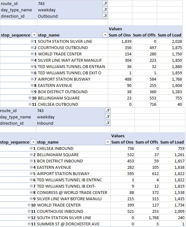

Ridership question about the SL3 today (if anyone knows).
Do people really sit on the SL3 all the way to South Station downtown, or do they hop off at Airport and take the much faster Blue Line route into downtown?
It probably depends on final destination, but the Ted Williams - transit way combo is really slow.
It looks like about 2/3rds of riders who board north of Airport continue through the Ted. If you look at Peak only it's closer to 1/2.
However, the people who exit at Airport are replaced by a roughly equal load of people who board at Airport and use SL3 to get from Airport to SLW/South Station/Red Line. If you want to get from Orient Heights to Seaport or Quincy Center, SL3 is a reasonable choice.

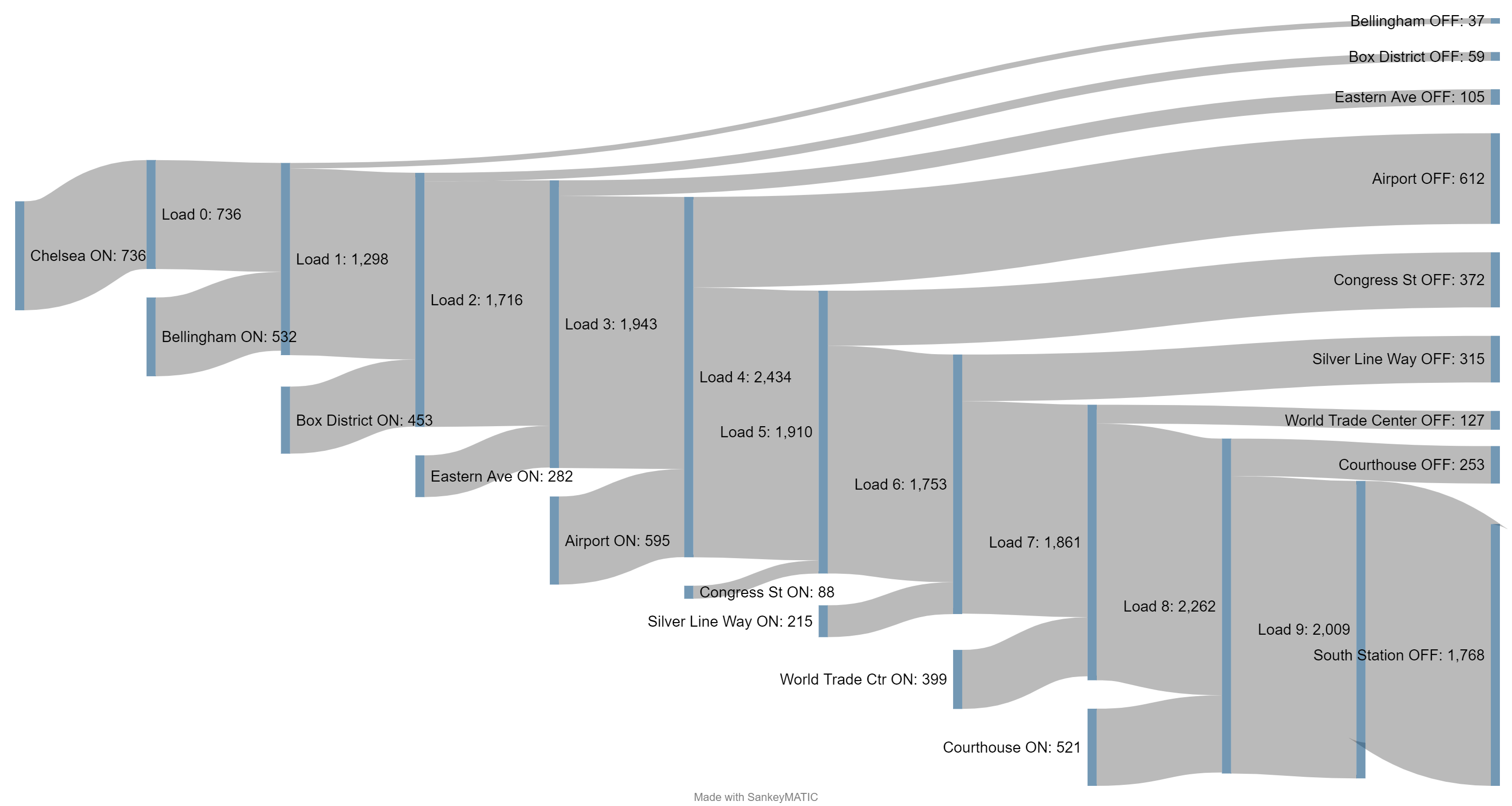

Thanks for pulling those numbers, you beat me to it.
I made a couple of Sankey diagrams (using sankeymatic.com, which was the first thing that showed up when I googled; code in spoiler box below).
(Note that the "Load" numbers were automatically calculated by the diagram tool and basically represent a hypothetical number -- specifically, the load on the bus after everyone has boarded at a stop and before anyone has disembarked at a stop -- i.e. a sort of max load that never occurs in the real world. So ignore those numbers, and instead pay attention to the width of the bars on each side of the markers.)
The first goes stop by stop:
From here, we can see that the lion's share of SL3 riders -- whether originating at the Airport or in Chelsea -- disembark at South Station. We can also see that no particular station in the Seaport is higher ridership than the others, though if we combine the on-street World Trade Center stop with the tunnel stop, then we do see a stand-out destination, with just under 500 alightings -- on par with Airport as a destination.

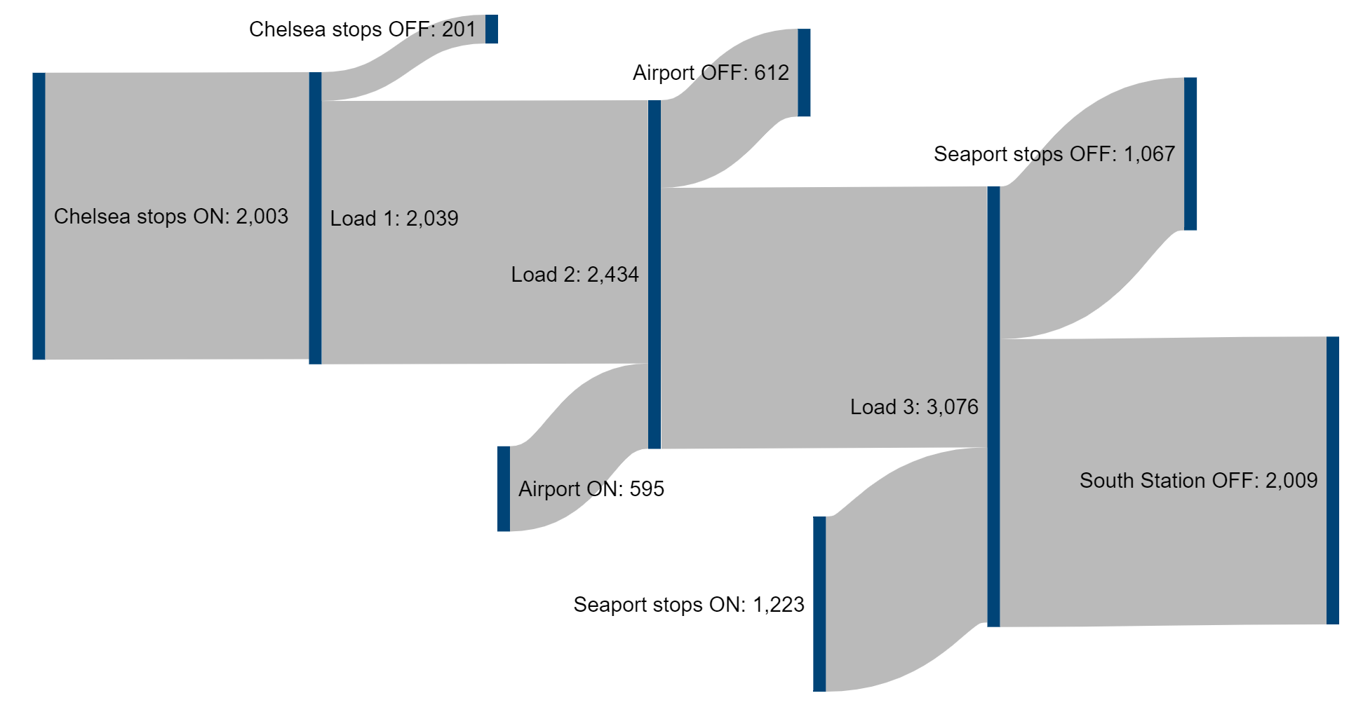

To simplify things, I made a second diagram that groups stations together by segment:
About 2,000 riders board at stops in Chelsea. About a third disembark at Airport, who are then replaced nearly one-to-one, as @737900er points out, with new passengers.
So about 2,000 riders head through the Ted Williams Tunnel. In the Seaport, about 1,000 riders disembark and about 1,200 riders board. We can probably assume that everyone boarding in the Seaport is traveling on to South Station -- at most, perhaps the 215 riders boarding at Silver Line Way are traveling to Courthouse, but that seems unlikely.
South Station sees 1,700-2,000 passengers disembarking (the T's numbers are weird here, but oh well). If roughly 1,000 of those come from the Seaport, that leaves 700-1,000 passengers who must come from Airport or Chelsea. That matches up with 2,000 passengers leaving from Airport, about 1,000 of whom disembark in the Seaport.
Of those 2,000 riders coming to the Seaport and South Station from the Airport, 1,400 must be coming from Chelsea. If 1,000 people are disembarking at the Seaport and only 600 board at Airport, then there must be at least 400 Chelsea-Seaport riders (probably more, since at least some of Airport's 600 riders will instead go to South Station).
I think the breakdown looks like this:
  • Airport-Seaport: no more than 600
  • Airport-South Station: no more than 600
  • Chelsea-Airport: about 600 (we know this number for sure)
  • Chelsea-Seaport: at least 400, maybe as high as 700-800 depending on Airport's South Station/Seaport split above
  • Chelsea-South Station: at least 400, maybe as high as 700-800 depending on Airport's South Station/Seaport split above
  • Chelsea-South Station or Seaport: 1,400 total
So, yes, there definitely are folks who are riding all the way from Chelsea through the Ted Williams Tunnel -- about 2,000 inbound each day. To me, the question remains: for Chelsea riders, what's the breakdown in Seaport vs South Station journeys? And likewise for Airport riders? Seaport-destined journeys probably end in the Seaport, but South Station-destined journeys may carry on further.
In the context of the Everett proposals, this matters: if most Chelsea SL3 riders are in fact going to South Station, then faster service via Sullivan would be an improvement, all the moreso because of the better transfers and access to downtown. If many Chelsea SL3 riders are instead going to the Seaport, then the story is a bit more complicated.

Detailed diagram:
Chelsea ON [736] Load 0
Load 0 [736] Load 1
Bellingham ON [532] Load 1
Load 1 [37] Bellingham OFF
Load 1 [1261] Load 2
Box District ON [453] Load 2
Load 2 [59] Box District OFF
Load 2 [1657] Load 3
Eastern Ave ON [282] Load 3
Load 3 [105] Eastern Ave OFF
Load 3 [1838] Load 4
Airport ON [595] Load 4
Load 4 [612] Airport OFF
Load 4 [1822] Load 5
Congress St ON [88] Load 5
Load 5 [372] Congress St OFF
Load 5 [1538] Load 6
Silver Line Way ON [215] Load 6
Load 6 [315] Silver Line Way OFF
Load 6 [1435] Load 7
World Trade Ctr ON [399] Load 7
Load 7 [127] World Trade Center OFF
Load 7 [1734] Load 8
Courthouse ON [521] Load 8
Load 8 [253] Courthouse OFF
Load 8 [2009] Load 9
Load 9 [1768] South Station OFF
Simple diagrams:
Chelsea stops ON [2003] Load 1
Load 1 [201] Chelsea stops OFF
Load 1 [1838] Load 2
Airport ON [595] Load 2
Load 2 [612] Airport OFF
Load 2 [1822] Load 3
Seaport stops ON [1223] Load 3
Load 3 [1067] Seaport stops OFF
Load 3 [2009] South Station OFF
