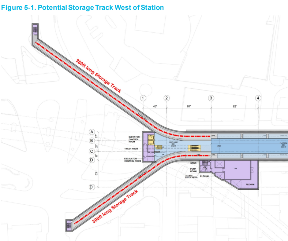

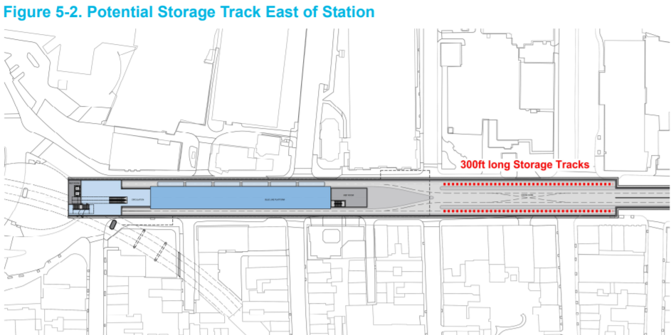

According to the design report, they're considering (and favoring) storage tracks to the east of the station, as opposed to the previously proposed storage tracks to the west of the station.
The 2010 DEIR and concept design included two tail tracks for train storage, which extended west beyond the station (Figure 5-1). The storage tracks would provide train storage of two 6-car consist trains. No trains could be stored on the tracks during revenue service - for safe braking reasons. Construction of such storage tracks west of the station are problematic from a construction cost and impact perspective, and from a tunnel ventilation and emergency egress perspective.
Potential Storage Track East of Station (Figure 5-2) provides less construction impact and greater operational flexibility.

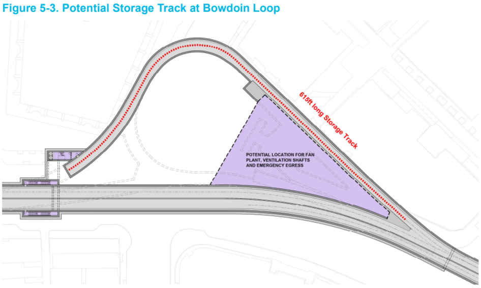

They also interestingly considered using soon to be retired Bowdoin loop for storage tracks.
Potential Storage Track at Bowdoin Loop (Figure 5-3) is problematic from operations perspective.

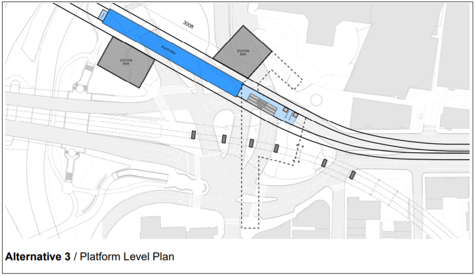

In the seemingly preferred alternative, an elevator looks like it is partially obstructing one of the tracks.
