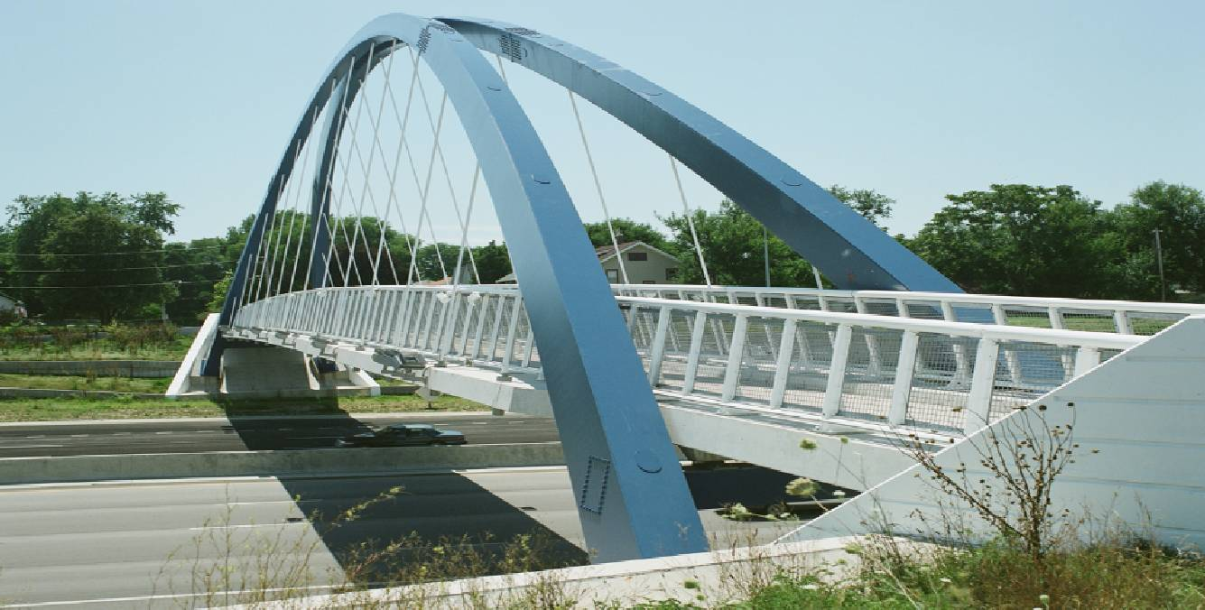

I visited Des Moines Iowa, and, I gotta say, their ability to build dramatic,functional bike-ped-only bridges seems several levels above Boston's game.
Downtown Rehabbing a rail bridge into bike/ped:
Des Moines Union Railway Bridge (south crossing for the downtown riverwalk)
Pedestrian Bridge HDR - Des Moines, Iowa (Project 50/50 - Week 16) by Jason Mrachina, on Flickr
Iowa Women of Achievement Bridge: single-arch, double-bikeway bridge (north crossing for the downtown riverwalk)
The Iowa Women of Achievement Bridge lit with Musco color-changing LED lights reflected in the Des Moines River
44th Street bridge (two arch, single ROW) (over interstate on its approach to downtown)
How does Des Moines pull this off and not Boston?
I'd be thrilled to get off-the-shelf derivatives of either of these arch bridges.

You said why in your first sentence. They went pure bike/ped. Low cost and focused. They cut down the number of cooks in the kitchen. We try for bike/ped/bus/emergency vehicle/park, scenic overlook, historic recreation.... We end up with a Frankenstein's monster of a design.
