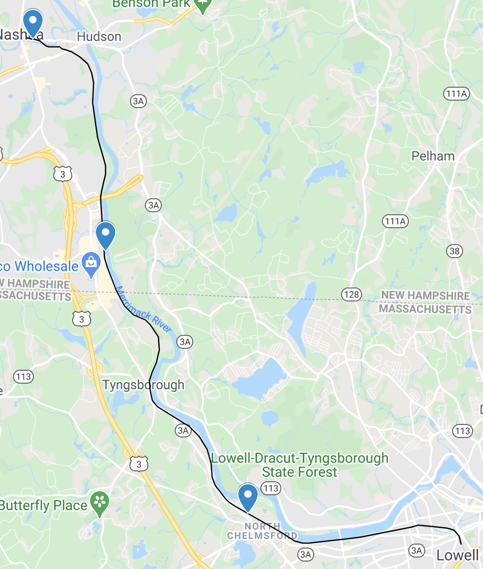

2) New Hampshire Rail - Nashua
Extension of Lowell Line to New Hampshire. Entirely dependent upon the state getting out of its own way, so God knows when/if it can happen. I'm aware of freight on this route, but I'm unsure of the impacts that it would have on scheduling. Note that the Nashua station is not the ideal location for an extension up towards Manchester. I feel like this location is more suitable suitable for a temporary terminus. And given that it can be built as nothing but a concrete slab I don't feel too bad about potentially abandoning it down the line.
Stations:
  1. North Chelmsford - TOD at a few industrial sites nearby, also not terrible population density.
  2. Spit Brook Road/Mall - Basically a Park&Ride for 3, maybe some possibilities for TOD on some parking lots.
  3. Nashua - Downtown station, not suitable as a terminus for any real extensions.
Further developments would involve an extension possibly out to Milford, but more likely either a branch or a complete replacement of the station on the ROW towards Merrimack and Manchester. An infill at Tyngsboro might be called for at some point, but I left it out due to the low density and the travel time impacts.

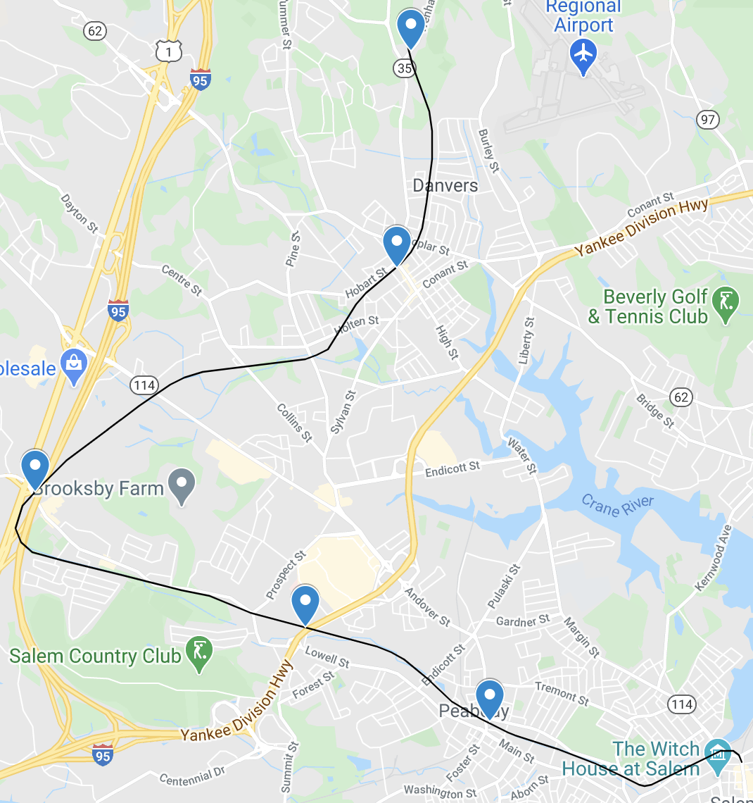

4) Peabody Line
A branch of the Newburyport/Rockport Line. Splits off at Salem station right outside the station to a new platform before following the ROW up through Peabody. The exact path it follows from here is open to discussion, but I have a sample one marked out here. Stations at:
  1. Peabody
  2. North Shore Mall/128
  3. West Peabody
  4. Danvers
  5. North Danvers - Extension to a spot suitable for a layover.

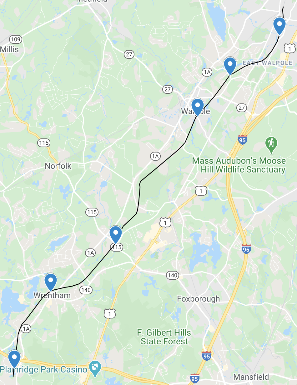

6) Extension of East Walpole Industrial Track
This one has always been a pet project of mine. It makes almost no sense, so it's included here at the end for chuckles more than anything. The ROW is almost not entirely gone. Large sections are intact, but there are private residences in the way. A few choice diversions (near Cedar Hill swamp, for example) allows most dynamiting to be avoided, but there would inevitably be some. I think there is real potential for such a branch in all honesty. The station parking lots in this area are full most of the time, and the existing stations miss a lot of potential catchments. Stations at:
  1. South Norwood - This station is the closest the tracks come to 1 for a while, and it's a bit close to Windsor Gardens, but that station is special for a variety of reasons.
  2. Plimptonville South - The demand from Plimptonville probably merits another station nearby.
  3. Walpole - The second weakest station on this line. Close to the existing Walpole section. Not downtown. No room for a parking lot. Residential nearby.
  4. Pondville - Nearby to a number of large lots ripe for TOD. Not too far from 1 and Patriots Place either.
  5. Wrentham - Downtown station.
  6. Wrentham Outlets - Potentially an anchor point at the end of the line. A huge amount of demand, with a good bit of that demand coming from city tourists.
The line is pretty heavily weighted towards the end of the line out towards 495. It think that's fine, though. The primary motivating factor would almost certainly be parking lot overflow for this region of the Commuter Rail system anyway. The inner stations wouldn't be complete losses, but they're definitely weaker and maybe even just skip them (especially Plimptonville South). The rest of this line is relatively straight, which would let trains reach reasonable speeds on their way in from the outskirts. Obviously a reach for other reasons, though. None of these stations is a need to build right now. The ROW is salvageable, which isn't the word you want to be using when talking about something that's not absolutely needed. The outer weighting of the demand would almost certainly be partially cancelled out by the longer trip times. Like I said, pet project, not really something that's going to get built anytime soon, but I wanted to include it here.

Don't forget Umass-Lowell!
For freight, the 3 miles between Lowell Station and North Chelmsford Jct. are the Pan Am Freight Main overlap, and a future double-stack route. ROW here used to be way wider, so around the UMass stop you'd be looking at 3-4 tracks for traffic separation much like by Lowell Station where the passenger NH Main and freight-only Lowell Branch are largely separate. Over the course of that 3-mile overlap pax & freight trains have to flip positions...freights enter the overlap from the northerly side at Lowell Station off the Lowell Branch but exit the southerly side at North Chelmsford Jct. onto the Stony Brook Branch...while passenger trains make the exact opposite move, south-to-north. So...probably 4 tracks mashing down to 3 past UMass station, then a staggered set of crossovers so the directional flip happens fluidly. Not a big deal. For electrification the 6 overpasses from MA 110 to Pawtucket St. are going to be moderately costly affairs needing double-stack under wires height. Feasible...just a lot of bridge touches in a short area.
N. Chelmsford to Nashua has a pair of daily Nashua Yard feeder trains...high-and-wide clearance route, but otherwise nothing to write home about. North Chelmsford Station is specced to be built full-high with a freight passing track. Expect ditto at South Nashua. Downtown Nashua station property that City of Nashua purchased @ Crown St. already is within yard limits. All points north to Concord it's just the incredible shrinking NA-1 local, and increasingly infrequent monthly coal trains to Bow power plant until it inevitably closes. Pan Am's ultimate buyers can probably shoot some free throws for more business on this industrial-heavy stretch, but it would still cram neatly on that single NA-1 round-trip so is neglible concern for Cap Corridor passenger.
NOTE: The T does not have trackage rights on the Hillsborough Branch like they do perpetually/irrevocably to Concord, so passenger service squared-up with Main St. in downtown is not in the cards. They don't have any interest in running there because it's double-dip negotiations with Pan Am, not in their in-district constituency like serving to the border and terminating at a convenient rail yard, and will not make them money running NHDOT mercenary service like the Boston-Concord express layer. Traditionally Main St. has never been Nashua's primary train station because it only featured light service on the branch to Keene; Hollis St. one block up from Crown was Nashua Union Station at what formerly was the junction of 4 RR's where intercity New York-Portland and Boston-Montreal service criscrossed each other on separate platforms as well as all the primary local service patterns.
If NHDOT really wanted to study to Wilton badly enough, that's all on them. So far they've had zero interest whatsoever. And the T would be much harder to deal with if they were fileting in that direction vs. concentrating all energy on Concord, so it's vanishingly unlikely a passenger train is ever going to trawl the "Hillbilly Branch", off-center downtown be damned. Probably because the local mindshare has always centered on Hollis/Crown as 'the' train depot the off-centeredness isn't as big a deal to local psychology as it looks to a 2D map, so I'd be wary of overestimating the interest in studying a Main St. station at all. They've had more local meetings than you can count about this damn extension, and questions about a Main re-siting have never carried much mindshare.

Danvers is out. They already signed the 99-year trail lease, so the ROW north from Peabody Sq. is now blocked. The only Peabody ROW left reserved for commuter rail is the ex- Salem & Lowell ROW owned by Peabody Municipal Light as a power line ROW. The city-owned utility long ago gave the T its audible that it would be perfectly happy to run track on the power ROW out to North Shore Mall, while also saying it would never allow a trail next to those trunklines.
Therefore you're looking at the straight-ahead continuation from Peabody Sq. station on Railroad Ave. & associated parking lots crossing Crowninshield St. Stop at North Shore Mall next to Lahey Clinic. And Essex Green Ln. + Essex Center Dr. perimeter access roads being conjoined in a loop next to the station, with shuttle buses fanning out from there. Layover would be on the current Independence Greenway (to-be-shifted) footprint to former Prospect/Lowell St. grade crossing. Easily possible when remanicuring the trail to build a trailhead bridge deck over 128 + Northshore Rd. to connect the east side.
Ending the primary extension here leaves future flex to continue +1 more stops to West Peabody @ 95/128/1 rail-with-trail along the ROW and plunk another stop right off Route 1...but that's surplus-to-requirement for today.

See here for past discussion on the Wrentham Branch and what's salvageable for commuter rail. Basically, the split from Norwood Central is so heavily blocked that it's of no use. It's the 3-day-a-week CSX local to the Certain Teed plant by the city line, and no more. You simply aren't getting through the encroaching housing developments in East Walpole. Give 'em better buses out of Norwood and Walpole with RUR frequencies, and any demand in this problem area probably gets satiated quickly.
The former diamond crossing + junction with the Framingham Secondary (Cedar Jct.) in Walpole, on the other hand, is completely fungible, with no truly problematic encroachments before Wrentham and only a couple mild-difficulty solves between Wrenthan and North Attleboro. Most of this part of the route passed into utility ROW hands. So it is build-feasible as a branch from Walpole that diverges from the Foxboro route and hits stops at South Norfolk (MA 115), Wrentham Common (Depot St. @ MA 1A/140), Wrentham Outlets/495, Plainville (W. Bacon St. @ 1A, downtown), and North Attleborough (downtown). The only functional encroachments are very easy to stitch together.
The main issue with this one, and why it kicks to dead-last on the (southside, at least) priority pile is the property acquisition. Eversource is the largest single owner of this 1976 Conrail abandonment, but there's lots of smaller property owners to contend with as well and that's just going to bureaucratically chew paper for years on end. Not wanting to think about how headache-inducing that would be is probably why the MPO has never taken a gander at studying it. As you can see from the stop roster it would be pretty buff ridership in an under-served 'tweener area between the Franklin Line and Providence Line. But no one's going to rate this one all that high while the labor in paper chew rates as excessive, no matter how relatively intact it is (and figures to stay).
I think a formal study is in-order one of these days to quantify it, but practically speaking this one has to stay in the file cabinet until we've closed out most of the most-wanted landbanked service restorations that don't have to deal with patchwork property ownership.
