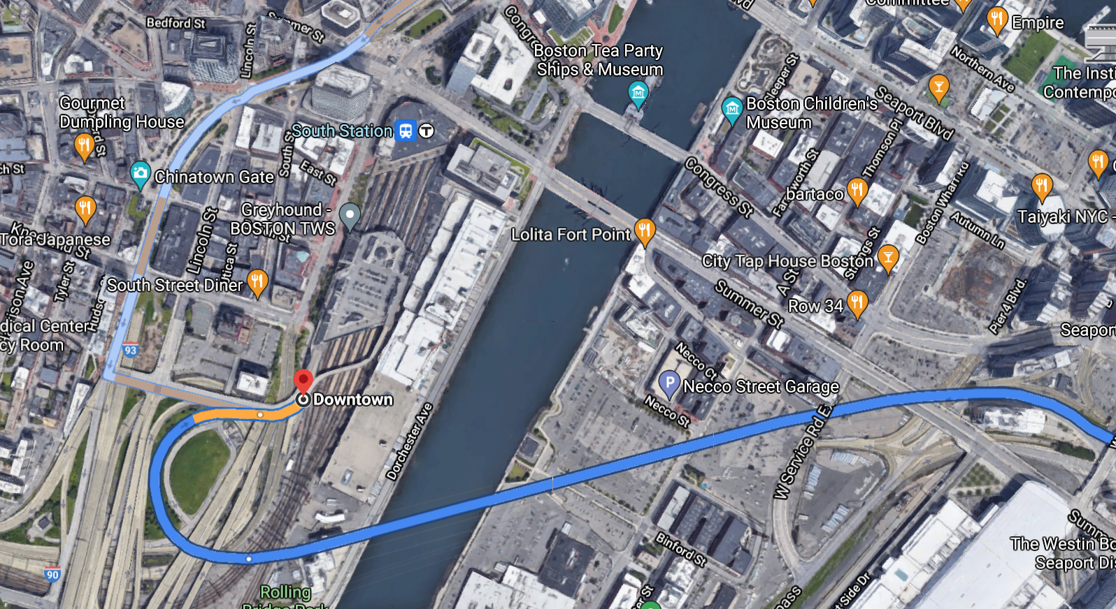

Oh do you mean like this?
That's an interesting idea I hadn't considered before. I feel like the bus platforms are too far away from the subway platforms for this to be useful? Though it would be interesting to see the breakdown of SL1 passengers alighting at South Station -- how many are...
