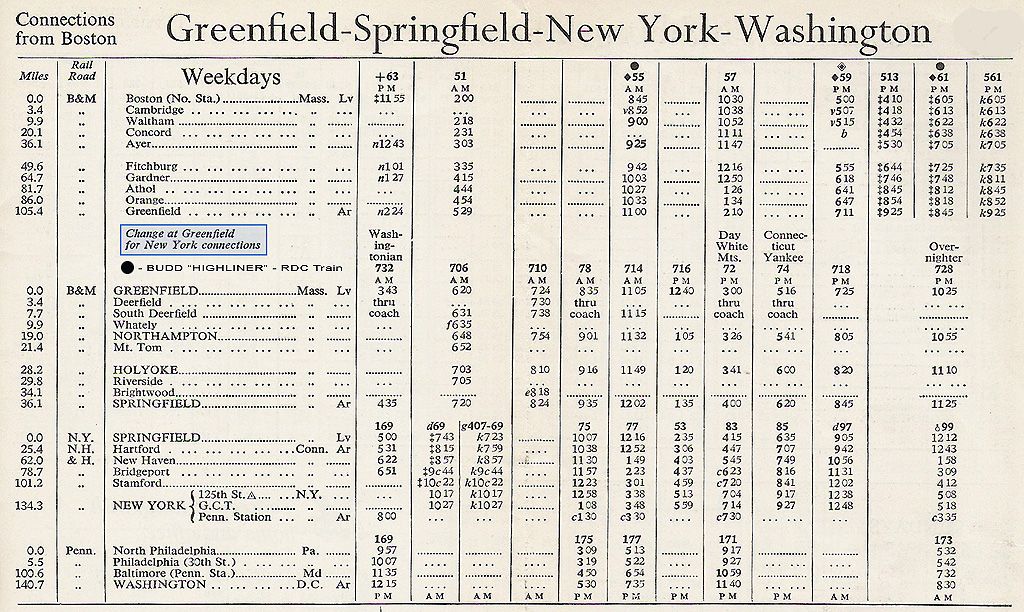

June 1956 B&M timetable. Yes, there was North Station-Greenfield commuter rail service in addition to Springfield-Greenfield commuter rail service on the Conn River Line.
A Fitchburg all-stops local today runs about 1:30; super-expresses running non-stop Porter-South Acton do Fitchburg in 7 stops at ~1:10. Slightly faster than the limited-stop schedule in '56, thanks to the total absence of freights inbound of Ayer. The daytime slots in '56 did the 4 extra stops past Fitchburg to Greenfield in +1:18-1:45. In all likelihood freights were the source of such extreme variability.
Springfield-Greenfield '56 is about 5-8 minutes faster than the Vermonter 2016 schedule despite making more local stops. Curse the excessive padding in the Vermonter schedule for all the ongoing Springfield Line and New Haven Line heavy construction, but that should snap back to roughly par within 18-24 months.
Now compare schedules with the Boston-Montreal Amtrak study benchmarks for Boston-Greenfield schedule on the L-shaped B&A + Conn River routing via Worcester and Springfield. This is the 'middle'-build Alternative with no segments of track upgraded to any greater than 79 MPH.
  • North Station-Fitchburg-Greenfield (Fitchburg '16 super-express + Fitchburg-Greenfield '56 local): ~2:20-2:45 for 11 stops. No layovers.
  • South Station-Springfield-Greenfield (2035): ~3:15-3:25 for 10 stops. ~15-25 min. layovers in Springfield for connecting Springfield Line trains.
Apples-oranges because the connections layover @ Springfield is a feature not a bug. But if you're going on raw transit time it's all of 15-40 minute advantage for the Fitchburg Line to Greenfield vs. the L-shape. Start subtracting from there if the B&A and Conn River got their max-build "Alternative 3" speed increases to 90 MPH Palmer-Springfield and Hatfield-Deerfield. If that doesn't knock it to outright par and you're hankering for a fight with basic geography, the B&A can knock many more degrees off many more curves than the Fitchburg which never lets the twisting banks of the Millers River out of its sight between Gardner and Greenfield.
The "Big L" on the B&A will always...always...be the fastest route to any point in Western MA in terms of absolute performance ceiling. That's true even before you get to the little matter of population densities outside of Route 128: Worcester (pop. 183K) + Springfield (pop. 153K) + Framingham (68K) >>> Fitchburg (40K) + Leominster (40K) + Acton (22K). Fitchburg's a great freight mainline, and Norfolk Southern's got 9 figures worth of investment plans for it. But that's its only practical use out in the Route 2 hinterlands: move shitloads of freight though the sticks so it's not clogging up the passenger lines that hit the cities.
