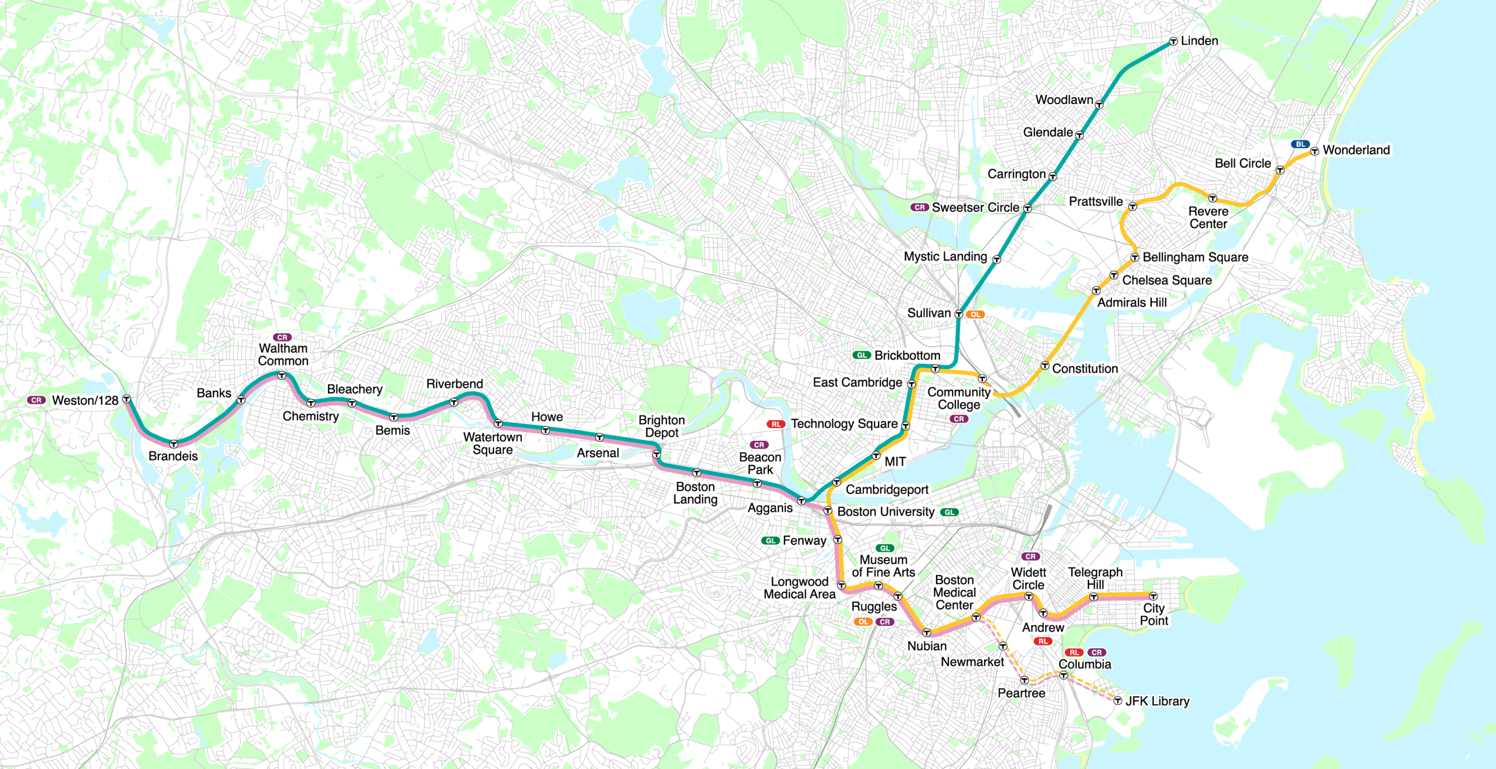

The real Urban Ring Major Investment Study (BRT version) proposed a branch to JFK.I think after Boston Medical it should not go to Widdet Cir but go south on Mass Ave where it meets the Fairmount at Mass Ave, then to JFK/ UMASS and the commuter rail south, and then follow Columbia Road to City Point. It would serve thousands more people
In my mind, JFK/Umass is very important for the Urban ring and definitely better than Andrew.I think after Boston Medical it should not go to Widdet Cir but go south on Mass Ave where it meets the Fairmount at Mass Ave, then to JFK/ UMASS and the commuter rail south, and then follow Columbia Road to City Point. It would serve thousands more people

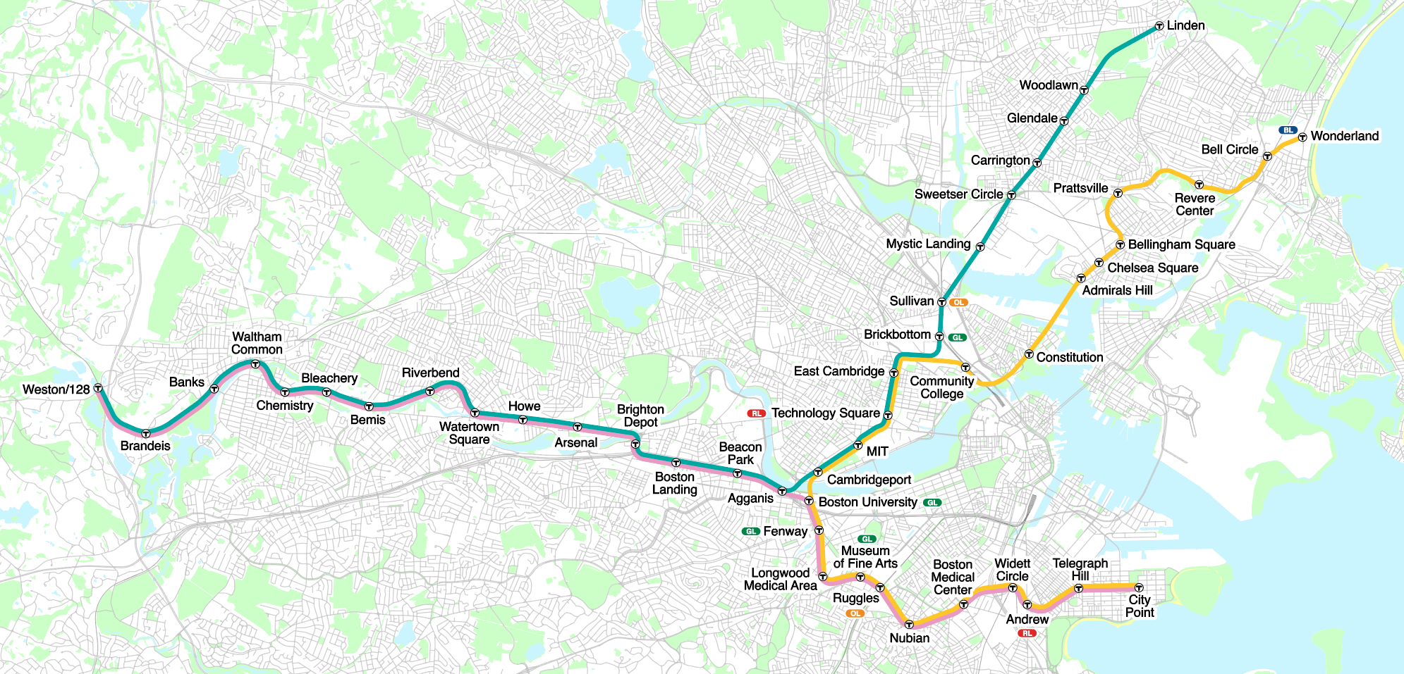

The base map is imported into Illustrator from QGIS and then I adjusted the colors on each layer to make it look just right. There's still a little more I want to do with it but it's pretty good. And as you can probably imagine the lines and stations themselves are not complicated.Regardless, the map just looks really nice! How are you making this?
Here's the basic theory in short form:I'm thinking over how well this really works. I'm starting to come around, but I'm working on questions.
I don't know what mode or method was being imagined here, but I'd guess a subway. First St is nowhere near wide enough for an elevated.I like the idea shown on the first graphic of the Urban Ring on an easterly alignment along First Street, lining it up directly with the Kendall, Lechmere and Community College stations. My preference for this portion of the route would be elevated LRV.
Yeah that's something I clearly missed, I also only put Brickbottom on one Northern branch when it should be on both.And I think it would be a little clearer if you label which stations would have transfers to Commuter Rail. Some I think you're implying would be infills, but I'm not sure all.

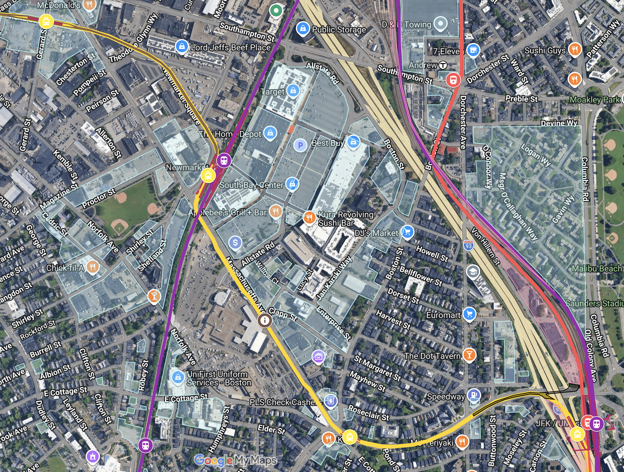

| JFK+Newmarket Alt | Andrew+Widett Alt | |
| Developable Land | Columbia Point, South Bay Mall, Newmarket Sq area | Andrew, Widett (Expensive air rights), Smaller portion of the Newmarket Sq area |
| Existing Density | Everett Sq (not that one), apartments around JFK | None |
| CR Transfers | Existing stations at Newmarket/JFK | New infill at Widett Circle needed, JFK CR likely closes |
| Travel time from Mass Ave @ Melnea Cass to Broadway @ Dorchester St at 20MPH average speed | ~8.5-9 Minutes | ~4.5-5 minutes |
| Construction cost assuming an El to just short of Everett Sq/Andrew, then tunneled. $1bn/mi for tunnel and $600mn/mi for Elevated | $2.3bn | $1.4bn+$200mn for CR infill |

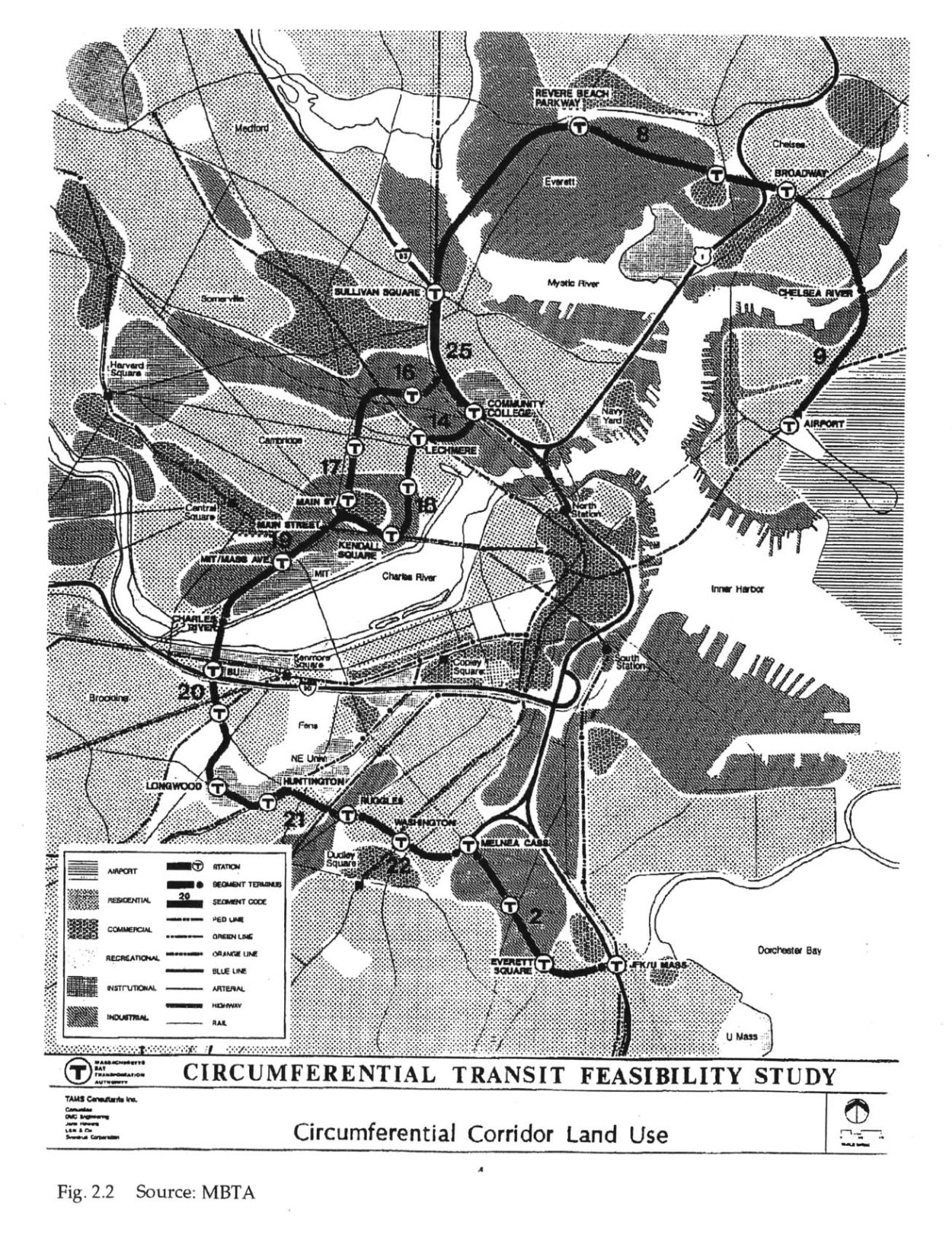

I followed transit developments like a hawk when I was a kid and a teenager in the 1950s and 60s, and I don't recall seeing any proposals or ideas floated publicly regarding circumferential transit. Also, I'm thinking there probably weren't any in the 1930s because of the Great Depression, and in the 1940s because of WW II.I'm trying to trace back the history of the Urban Ring. The earliest I can find is the Circumferential Transit Report from 1972, which is claimed to be the first full study. Wikipedia and a couple other articles make reference to a 1923 proposal but nobody seems to have a record of what this proposal actually looked like, or if there were any other proposals between 1923 and 1972. (My guess is no given that in later years the BERy and later the MTA were focused on suburban extensions and the GL subway but I could be wrong).
I was wondering if anyone here has been able to find these resources in the past or knows if they even exist at all. The City of Boston Archive has some (undigitized) documents but:
- Those are not particularly accessible to me at the moment
- They seem to be missing material from 1923, when the proposal was (allegedly) made
You're right in that the service pattern here leaves a lot to be desired for Everett, a revision to that is definitely needed. A BL extension would absolutely help with that but I've been trying to keep this scheme independent-yet-complimentary of other projects. I don't want this to be a whole fantasy map, I want a simple, relatively standalone idea, and I don't think it's possible to hit everything while maintaining that focus. You'll need complimentary schemes like the Green Line Reconfig, Mass Ave LRT, 'SL Phase 3 but Green Line', and a new downtown subway to accomplish everything, but even without those I think the map shown achieves most of its goals by itself.Ultimately, I'm not sure that the radial-circumferential combo works well here. A circumferential line is primarily for short-distance trips and connecting places to the radial lines; if you're going far around (such as Chelsea-LMA) it'll be faster to go through the core. Everett riders have to transfer to hit any major employment center aside from Kendall, and everybody has to transfer to hit downtown, Back Bay, and the Seaport. I'm personally a fan of routing Chelsea+Everett through Kendall/Back Bay/Nubian and having Watertown/Waltham be a Blue Line extension.

My personal preference is to have a BLX via the Esplanade and Kenmore to Waltham on the alignment you show. It would tie the ends of the metro area and Logan together well.You're right in that the service pattern here leaves a lot to be desired for Everett, a revision to that is definitely needed. A BL extension would absolutely help with that but I've been trying to keep this scheme independent-yet-complimentary of other projects. I don't want this to be a whole fantasy map, I want a simple, relatively standalone idea, and I don't think it's possible to hit everything while maintaining that focus. You'll need complimentary schemes like the Green Line Reconfig, Mass Ave LRT, 'SL Phase 3 but Green Line', and a new downtown subway to accomplish everything, but even without those I think the map shown achieves most of its goals by itself.
I think you're probably right though that the value a BL extension adds by 'solving' the western branch is too much to ignore.

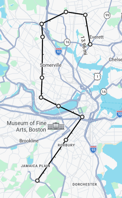

Slight correction to this: In 1946, the legislature directed the Coolidge Commission to consider a "a subway loop from Boston through Everett, Maiden, Medford, Somerville and Cambridge to Boston and to Forest Hills in the West Roxbury district". That would have been a rather ungainly route:The next major regional transit plans were the Coolidge Commission (1945-47) and the Program for Mass Transportation (1966), which were focused on radial suburban routes, so it does appear that the 1972 study was the next time a circumferential line was seriously discussed.
