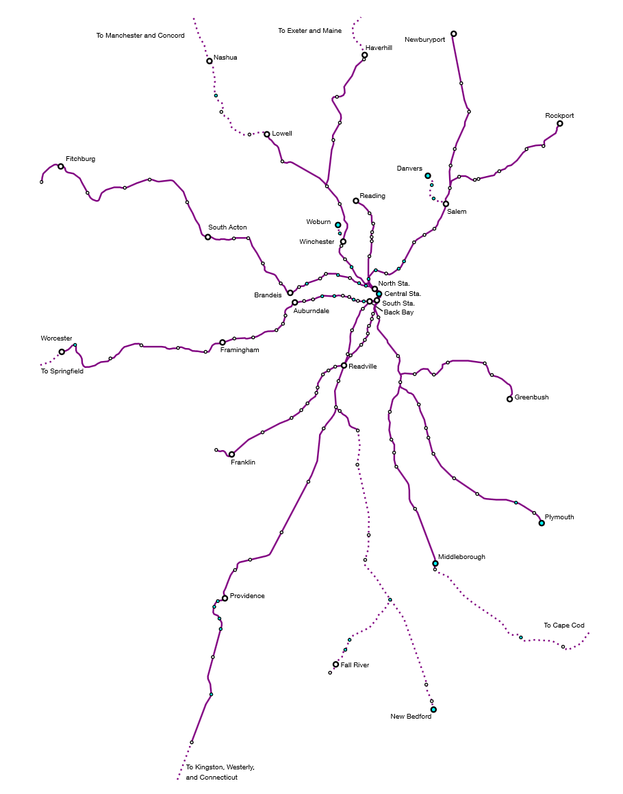

Our original Regional Rail report had a throwaway image in the back on page 35 which had a potential expanded network with extensions (dotted) and infill (blue circle) but it was totally unexplained, done by one of our technical committee members and put there (by me) to fill a blank page:
In our line-by-line appendices, we are also explaining infill and expansions. We'll be rolling out those as a package probably early next year.

Where it says to Exeter and Maine, that's already served by Amtrak.
Also where it says to Kingston, Westerly, and Connecticut is served by the Northeast Corridor. It makes no sense to expand the MBTA further that way, as Kingston is already too far for large quantities of ridership.
