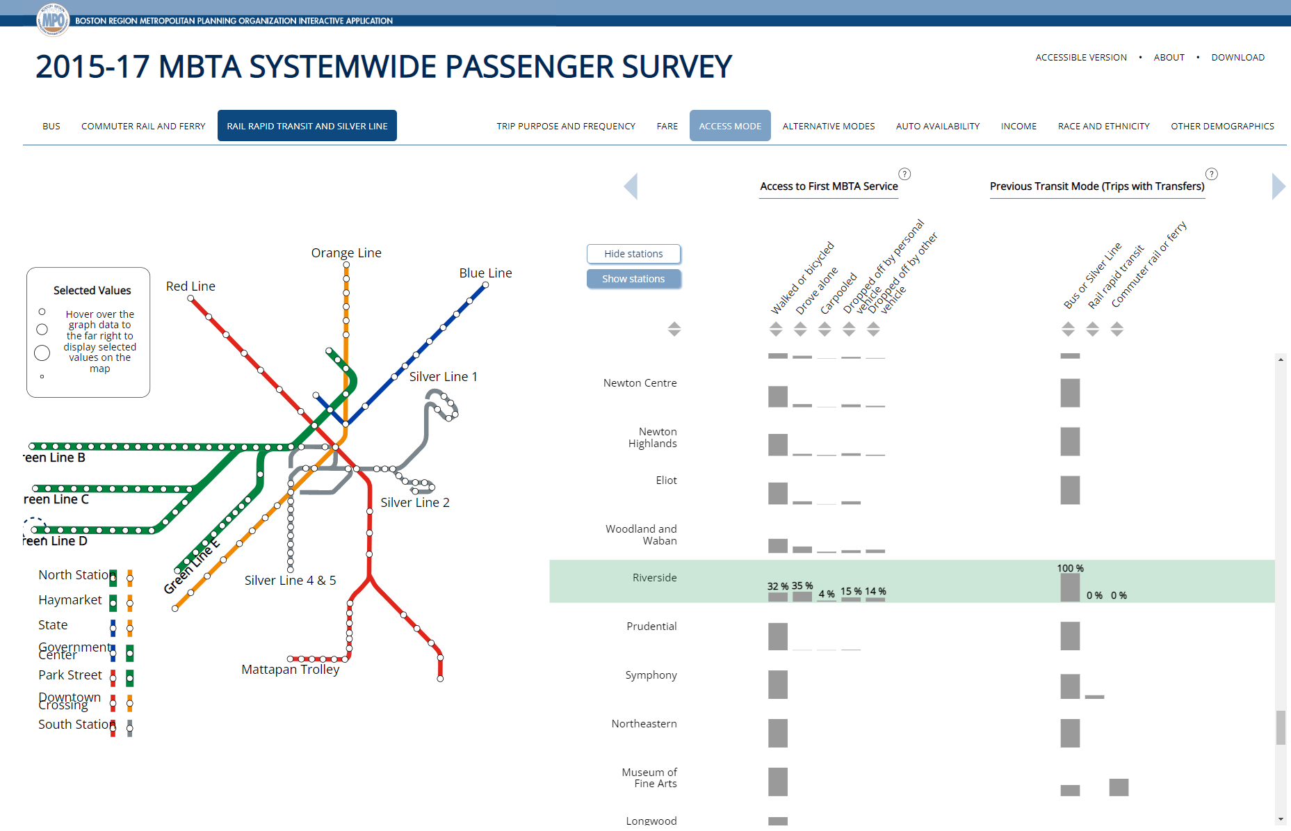

This prompted a memory of a dashboard, so I went hunting. The 2015-2017 Passenger Survey asked how passengers arrived at the station they started their journey at. https://www.ctps.org/dv/mbtasurvey2018/#
According to this, only 35% drove alone to the station -- about a third. Another third walked, and about another third were dropped off.
If 650 of the Park-n-Ride's reported cars are from commuters, than 650 should equal 35% of the inbound ridership. That would put inbound ridership at ~1800, which is much closer to the 2200 figure from the 2014 Blue Book than the 400-500 figures from the 2017-19 numbers.
So. Idk.
If we assume that the Passenger Survey numbers are accurate, that suggests approximately 600 folks walk to Riverside, while about 1200 might potentially drive elsewhere if something better were available.

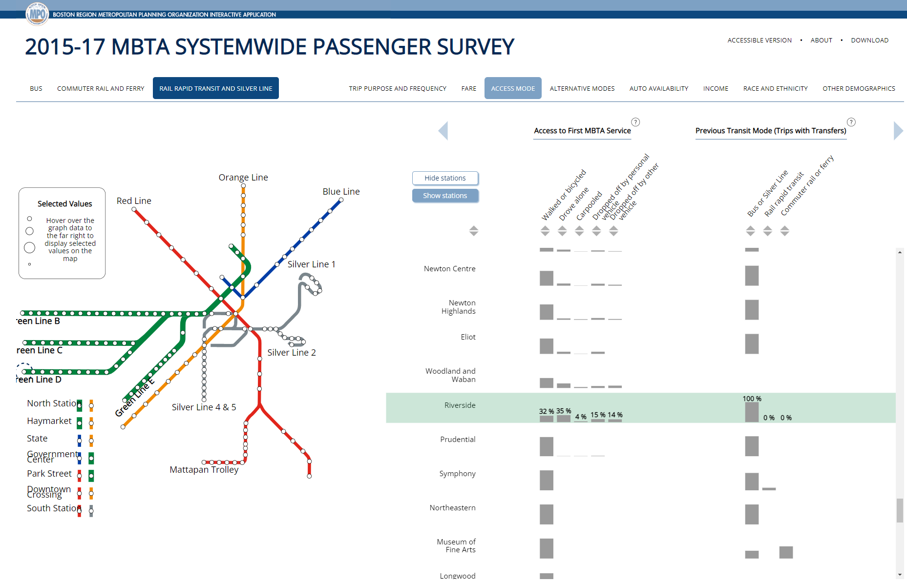

^ Good point. Still, for the numbers to line up, we'd have to assume that every rider arrived by car, and that there are 300 cars parked overnight on a typical night.
So. Idk.
The dashboard actually has raw data for each station and bus route, instead of just percentages, if you click "download":
The spreadsheet gives the following for Riverside:
  • Walked or bicycled: 752
  • Drove alone: 804
  • Carpool and dropoff: 761
  • Bus: 187
The spreadsheet did not indicate units for the data, but I suppose they're riders per day.
As for alternate service for Riverside riders:
  • Use alternate modes - yes: 1173
  • Use alternate modes - no: 1324
  • Alternate modes - walk or bicycle: 47
  • Alternate modes - drive alone: 516
  • Alternate modes - carpool, taxi, shuttle, private transit, etc: 537
  • Alternate modes - different MBTA service: 506
(Note that alternate modes options are "check all that apply", so they add up greater than 1173.)
Also, here's data for Worcester Line from Wellesley Square to Wellesley Farms:
  • Walked or bicycled: 516
  • Drove alone: 516
  • Carpool and dropoff: 269
  • Use alternate modes - yes: 657
  • Use alternate modes - no: 633
  • Alternate modes - walk or bicycle: 23
  • Alternate modes - drive alone: 363
  • Alternate modes - carpool, taxi, shuttle, private transit, etc: 210
  • Alternate modes - different MBTA service: 188
Considering that more than half of Riverside riders indicated no alternate modes, and that relatively fewer Wellesley riders indicated "different MBTA service" as an alternate mode, this raises doubts about the hypothesis that most Riverside riders, or even Riverside P&R riders, use it as an alternative to CR or a backup in case they miss CR. On the other hand, slightly less than half of Riverside riders who do have alternate modes indicated "different MBTA service" as an option, so there's still a significant amount or them who see CR as viable.
