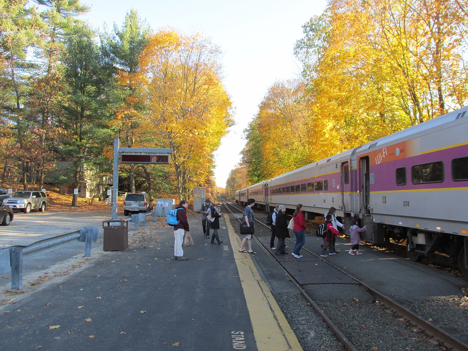

Lincoln's not hard at all. Take the outbound side platform north of Lincoln Rd. and raise it to a full-high 800-footer, and slap a new inbound platform opposite it on same side of Lincoln Rd. Discontinue the kooky "inbound" platform that requires walking across the tracks, and be left with just a prefab station north of the crossing. It would be the single cheapest upgraded station to do on the whole Fitchburg Line because of its layout simplicity.
For the other stops, you definitely need 100% high-level boarding inside 128 to activate the automatic doors on all coaches and speed boarding/alighting for the :15 service. That requires:
  • Porter - Extend platform +100 ft., widen south end to MAAB-regulation 12 ft. width for islands (there's plenty of side room to re-space the tracks), and raise.
  • Belmont Center - 800 ft. full-high side platforms east of the station building, change rump-of-platform in front of building into egress, ADA the egresses, snake Fitchburg Cutoff path extension behind outbound platform on ex- Track 3 & 4 berths.
  • Waverley - Elevators and upgraded stairs, raise in-place, extend to both directions to net 800 ft. (possible retaining wall work).
  • Waltham Center - Abandon the Moody-Elm block platform, double-track, lengthen and raise the outbound platform west of Moody (change parking row from angled to parallel for the double-track infill tie-in), put new inbound platform opposite the outbound likewise west of Moody, DTMF switch so the engineer can raise the gates while the train is at a stop, queue-dumping signal upgrades to Moody-Carter and Elm-Carter lights. Consider upgrading this alley as a south-of-crossing spanning street between Moody-Elm. It's already used unofficially for that purpose, so might as well double-up Carter and make it official. One-way in the prevailing-load or most 'difficult' direction if it's too narrow.
  • Brandeis - Raise in-place. It's already 800 ft. on both sides.
  • Weston/128 - The all-important Weston-consolidation, highway Pn'R, and terminating stop for :15 service. Near the Biogen campus at Route 20 where it's been studied.
