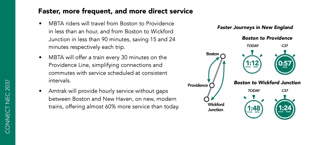

So the NEC recently-ish NEC Commission Connect 2037 report (pdf warning) in November. Specifically relating to regional rail, they've included the following blurb.
Their benchmarked Wickford/PVD-BOS travel times, which I assume came from MassDOT or the T itself, is exactly 10 minutes slower than transit matters estimate. I know that TM report was questionable as being overly rosy in its assumptions, but does 57 and 84 min sound realistic to folks as a target speed? Being in PVD in under an hour would definitely make it feel substantially closer.

TMs numbers presume EMU service, not conventional push-pull

Realistically, given acceleration limits and speed limits, what’s a good target future RR travel time from South Station to Providence and to Wickford?
I think what the NEC Commission slide says--57 minutes for Providence and 1:24 for Wickford--is realistic with the kind of EMU's the T was bid, because that's most likely sourced from data the T's own Rail Vision was working with on it's full-blown Regional Rail Alts. TransitMatters specced 46 minutes to PVD, but that was contingent on vehicle acceleration profiles that simply aren't available for import here and would cost more than the T could bear to pay. And it was also contingent on making the terminal district a 40-60 MPH sprint to the bumper post to slash down the SS-BBY trip times to a fraction. Those speeds are never ever happening under FRA auspices. 30 MPH might be doable through the South Station interlockings at 3x better than today's excruciating 10 MPH crawl, but faster than that through yard limits is not realistic.
It'll be several minutes slower if they end up adopting BEMU's, because most makes on the market de-power a set of bogies to fit in the bulky batteries resulting in much worse acceleration. So the difference between a straight-EMU and a battery-EMU adoption probably is the difference between making it to Providence in slightly under an hour vs. slightly over an hour. Hopefully they'll come to their senses there.
I really hope this means either the T has given up on the idea of BEMUs, or that the NEC Commission will force them to. But this may be wishful thinking.
