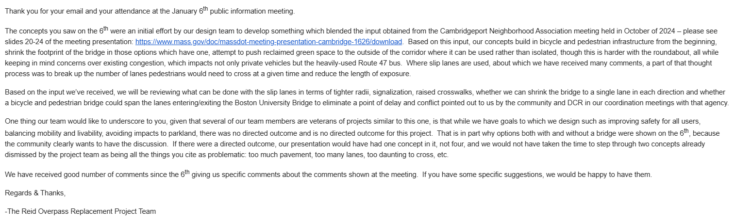

Just got a long email from the project team, reads a lot like the one I got from the I-90 project team except this one I think I managed to elicit more of an emotional reaction beyond "we need the space". What did it? Well, I said that they "didn't try very hard" and were "wreaking havoc" and "playing Sim City" and accused them of working backwards from a solution. My fault for that one. However, these emails, while they have no effect on the outcome of the design, are actually read by a human, so definitely send them if you want to shout into the void.
The "Reid Overpass Replacement Team"?
Showing their bias in their title.

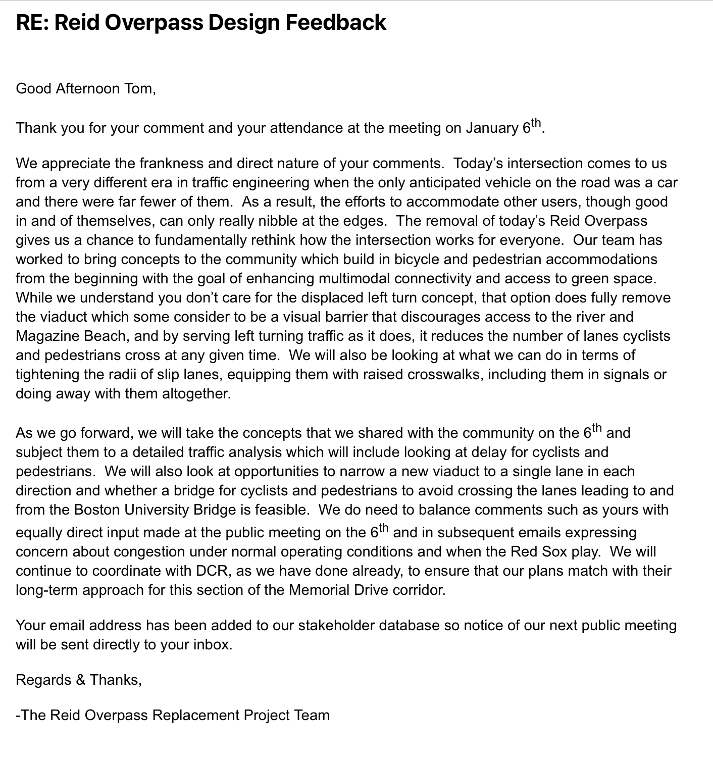

Hmm sounds familiar to the email I got today
Idk, replacement does not have to mean a replacement of existing conditions. If they remove the overpass and fulfill all our wildest dreams they're still replacing it with something. I don't think we need to read that much into it.
