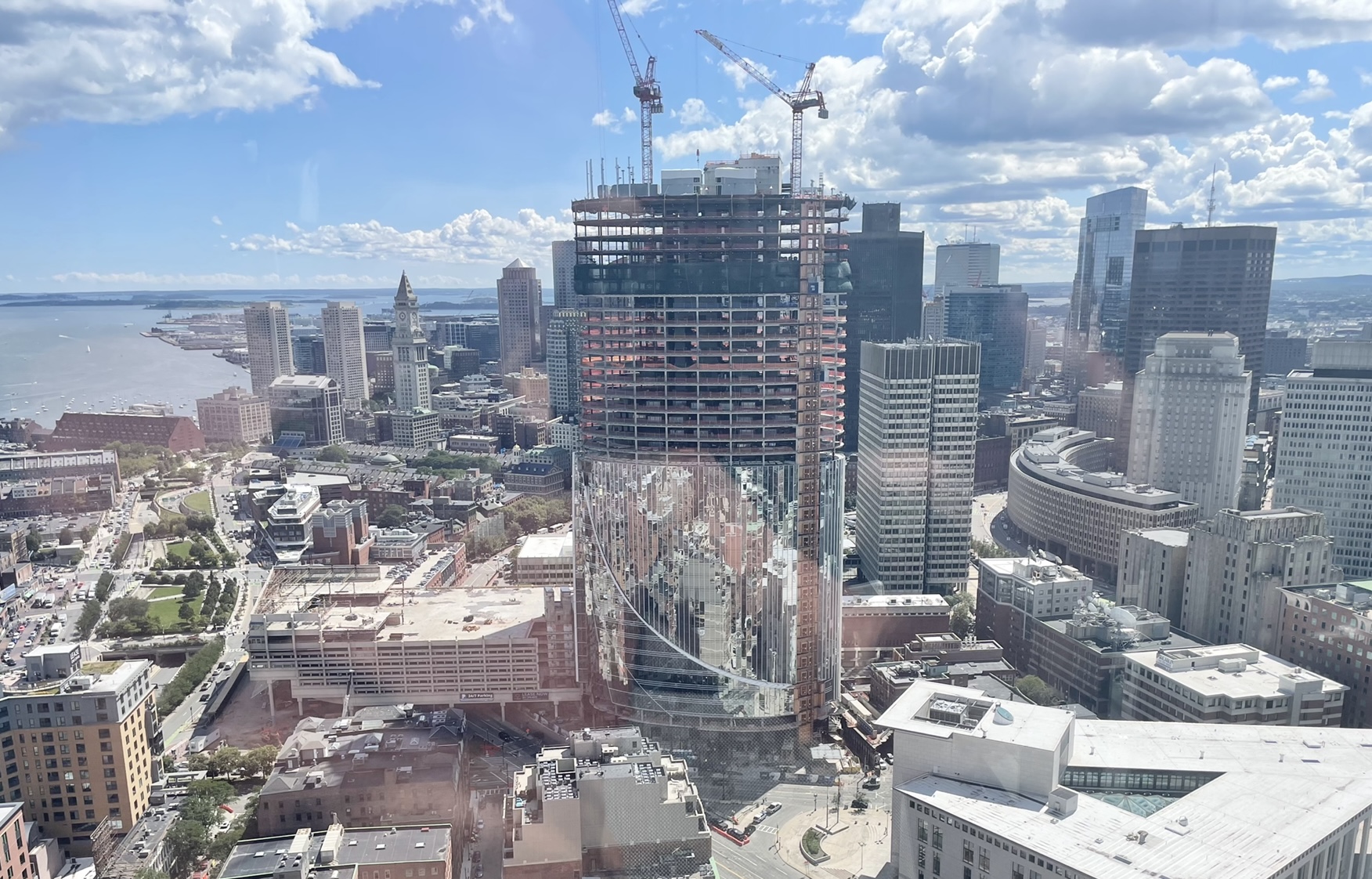

^ I really like looks of 1 Congress tower from this vantage point ("skinny side")
Hell, I really like the looks of 1Congress St from every vantage point!
