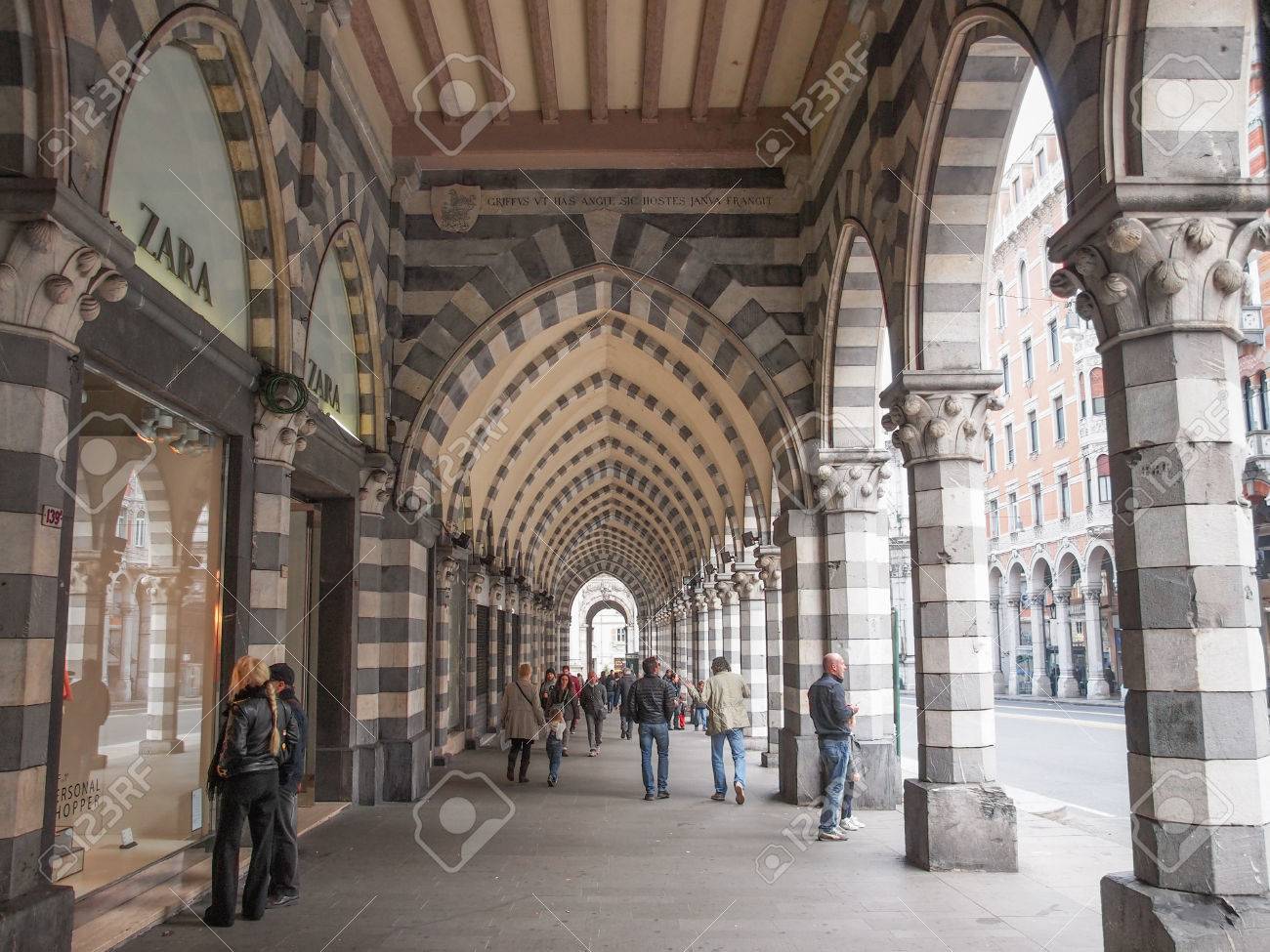

I'd love to see or hear of some effective urban colonnades if you can think of any off the top of your head (this is not a challenge but genuine interest and curiosity). Thanks in advance.
Italy would be my go-to choice for finding examples of well-done colonnades over the centuries, though other places have them too. Here's some I did a quick search to find:
Genova:
27000450-GENOA-ITALY-MARCH-16-2014-Tourists-in-Via-XX-Settembre-high-street-colonnade-Stock-Photo.jpg
