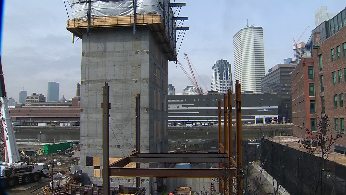

According to the announcement, Eli Lilly plans to lease space in a new 12-story building being developed by Alexandria Real Estate Equities, Inc. that's expected to be ready for occupancy starting in 2024. That developer's only project under construction in the Seaport is the 12-story building at 15 Necco Street, which was originally expected to house a new headquarters for General Electric.
