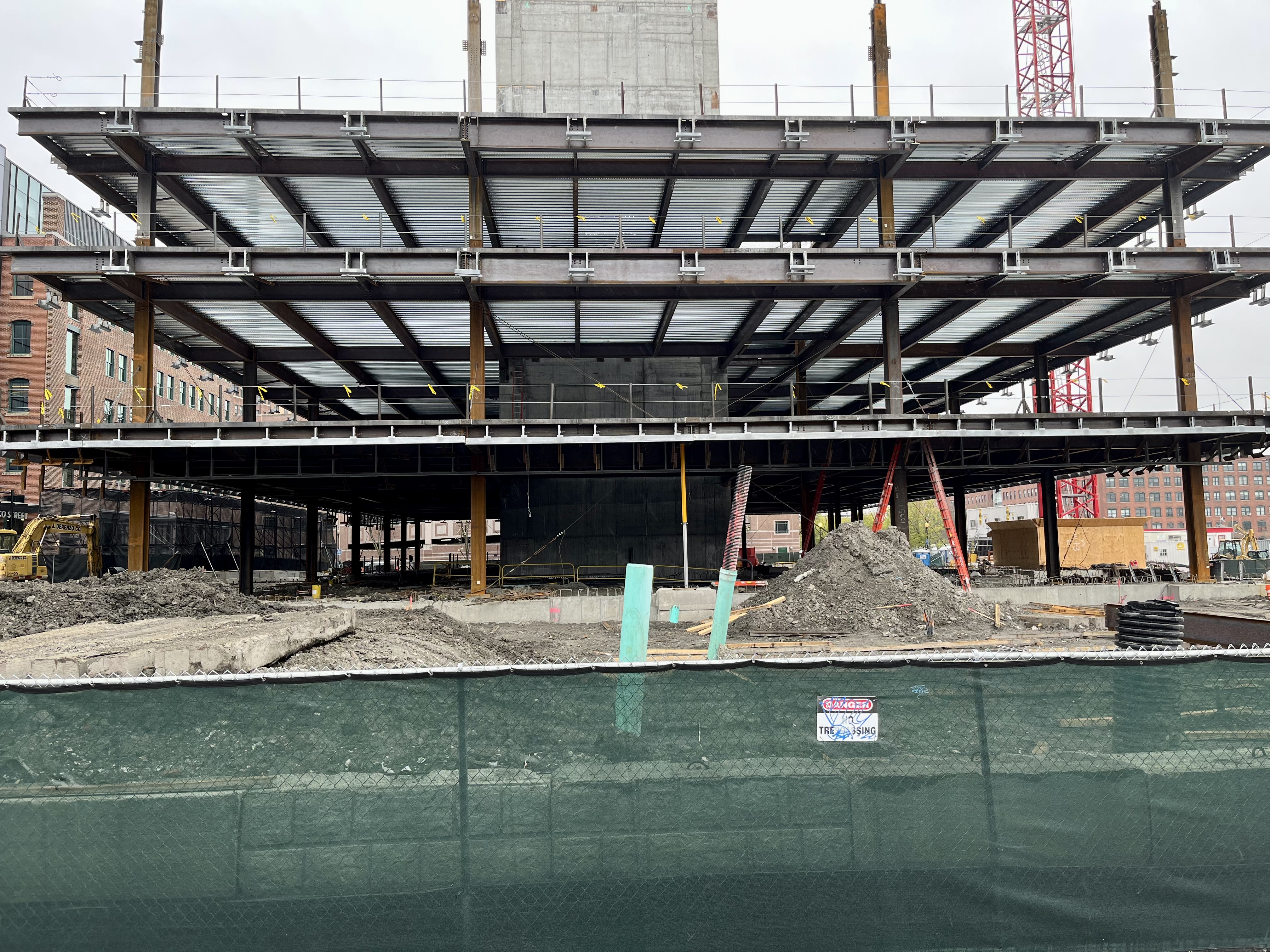

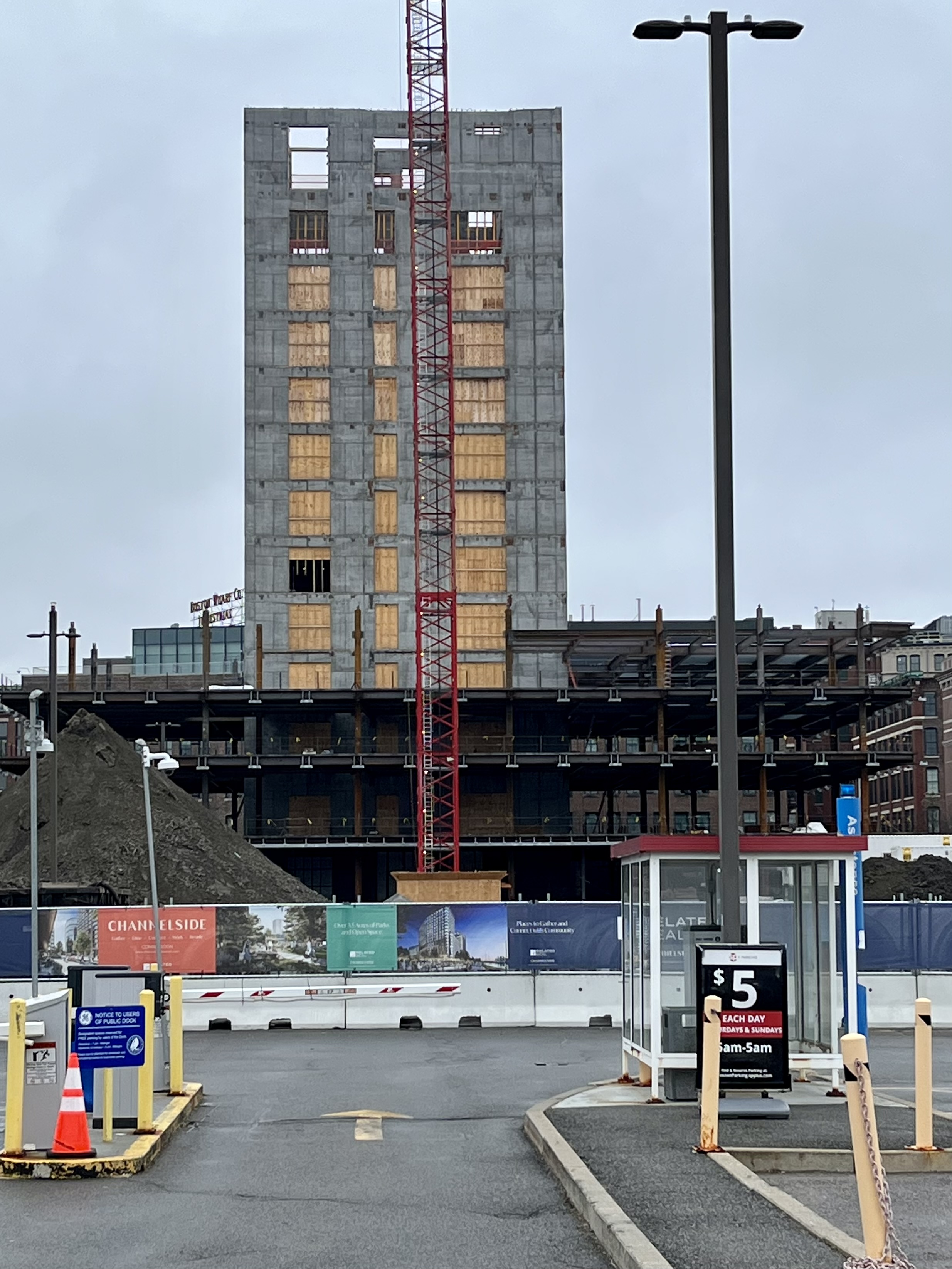

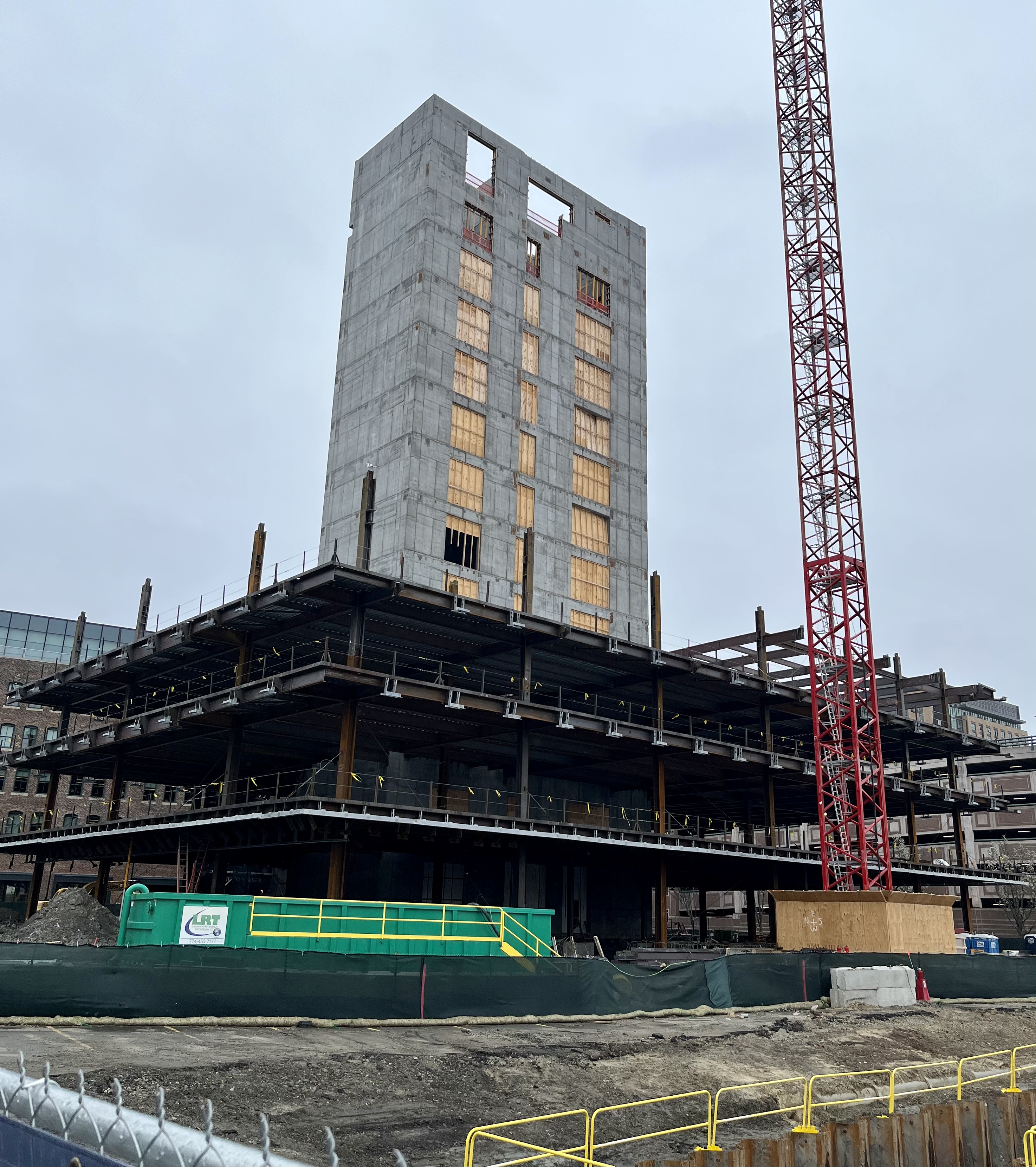

I’m still hung up with how thick this elevator core is. It takes up almost … 1/9th (if you divide the floor plate into a 3x3 sq grid) of the floor plate area. Seems like a lot, especially for a 12 story bldg. Or is that typical?

I would imagine it's due to the large cantilever and also the fact that this site probably has high wind loads - cores provide significant lateral support for the rest of the structure. Just a guess though

It looks like both egress stairs are included in between the two elevators which takes a lot of floor space. This combined core allows for an open floor plate and a 360 degree view. I'm assuming, I have not seen the plans.

Welcome to lab buildings. The cores are enormous for all of the elevators (tenants want private service elevators to protect intellectual property) and for the amazing amount of duct work they need--so the core will be even larger than this structure.
