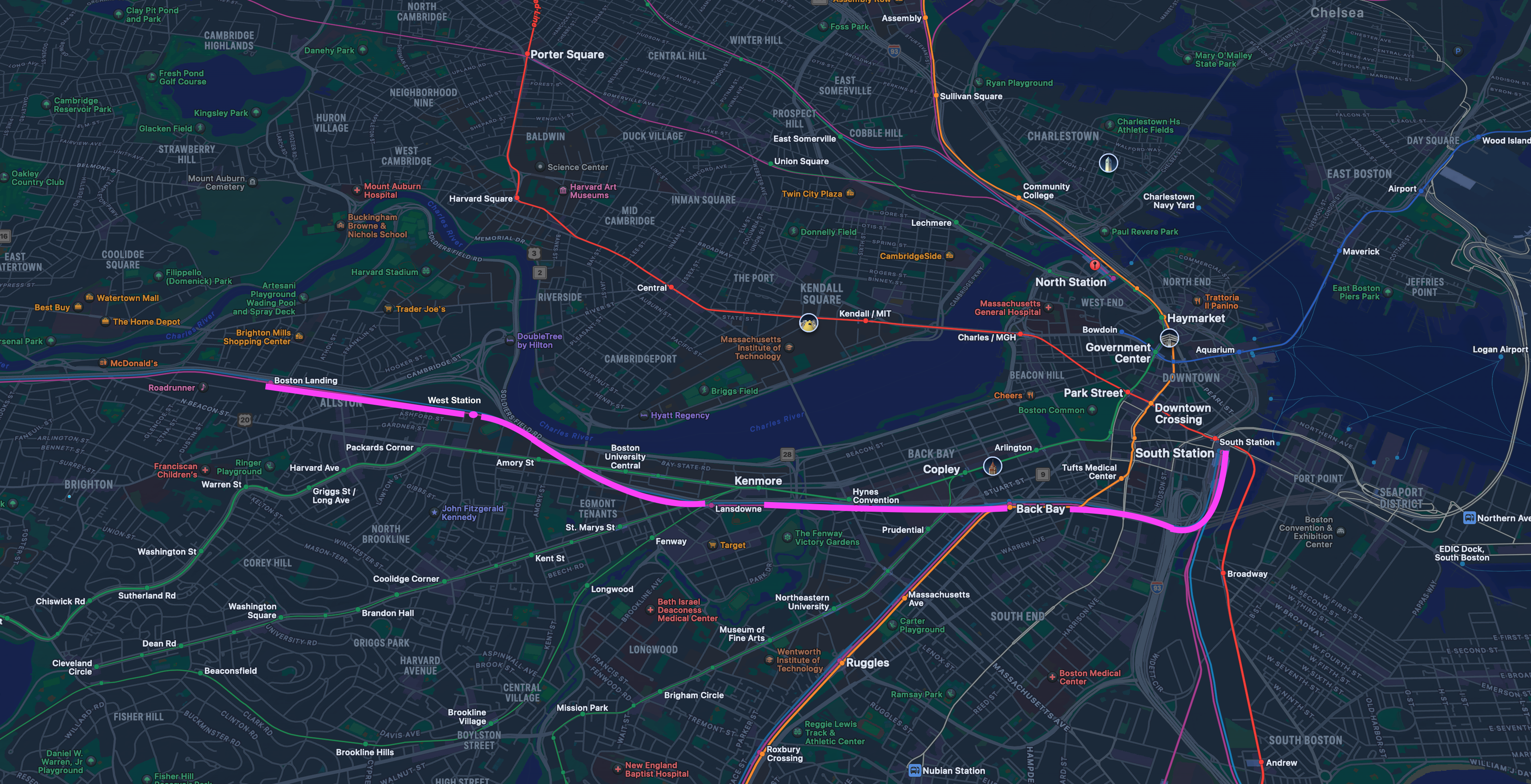

Allston-Brighton already has a corridor that can be used for rapid rail transit. It's along the Boston & Albany right of way (ROW) along the I-90 Mass Pike.

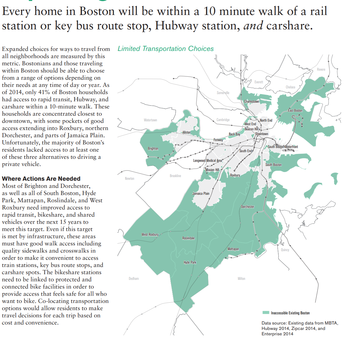

I'd be VERY interested in an updated version of this map, and hopefully we get something like it with the upcoming GoBoston 2030 update. Bluebikes has so much more reach than Hubway did a decade ago, and with Turo and GetAround coming on the scene I don't think there is an inch of Boston that isn't within a 10 minute walk of carshare.
It's kind of limiting that there isn't an updated version of the map.
The transit coverage would be smaller for the KBRs since some of the KBRs currently fail to meet KBR standards. (requirements for KBR is 10 minute headways rush hour and 20 minutes off peak). The 57 is only running 11 - 13 minutes at rush hour and the 39 runs every 23 minutes on Saturdays, failing the KBR standards.
I'd also be interested to see the map covering the entire BERy service area + Lynn/Quincy/Waltham. I'd imagine Medford/Malden/Everett would appear as one giant desert except for Malden Center.

If we're talking about burying the A branch in the tunnel and building a new subway through Back Bay, at that point, one may as well just send rail transit down the B & A railroad along the Pike.
Washington St. already has dozens of unknown street utilities beneath the ground, so tunneling beneath the A branch is going to be extremely problematic with cut and cover or TBM. Plus the hilly terrain, plus sharp curves to get in and out of either side of Cambridge St and around Lake St. and Oak Sq. in particular.
Tunneling beneath the B & A is a lot more straightforward. Just take a single lane of the Mass Pike, tempoarily single track the B & A between each pair of switches, and do a capped cut for each pair of track and between each pair of switches. It's highly unlikely there would be that many utilities beneath a pre-existing railroad. After that, reconfigure the entire bus system, reroute the 64 to Brighton Center from Allston Depot and eat away at the original A alignment with added frequency, for a new OSR crosstown connection to Cambridge to eliminate the route duplication along Boston Landing.
