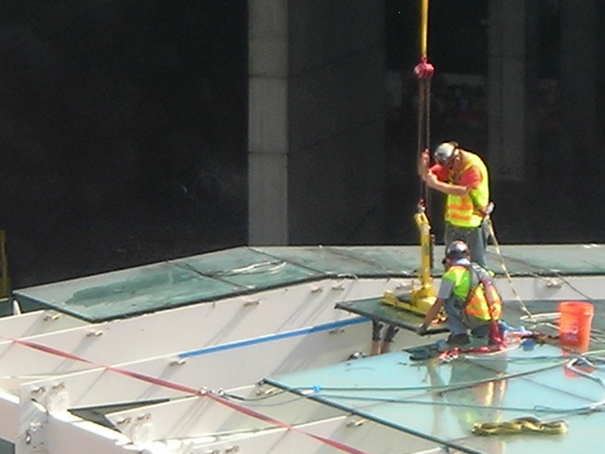

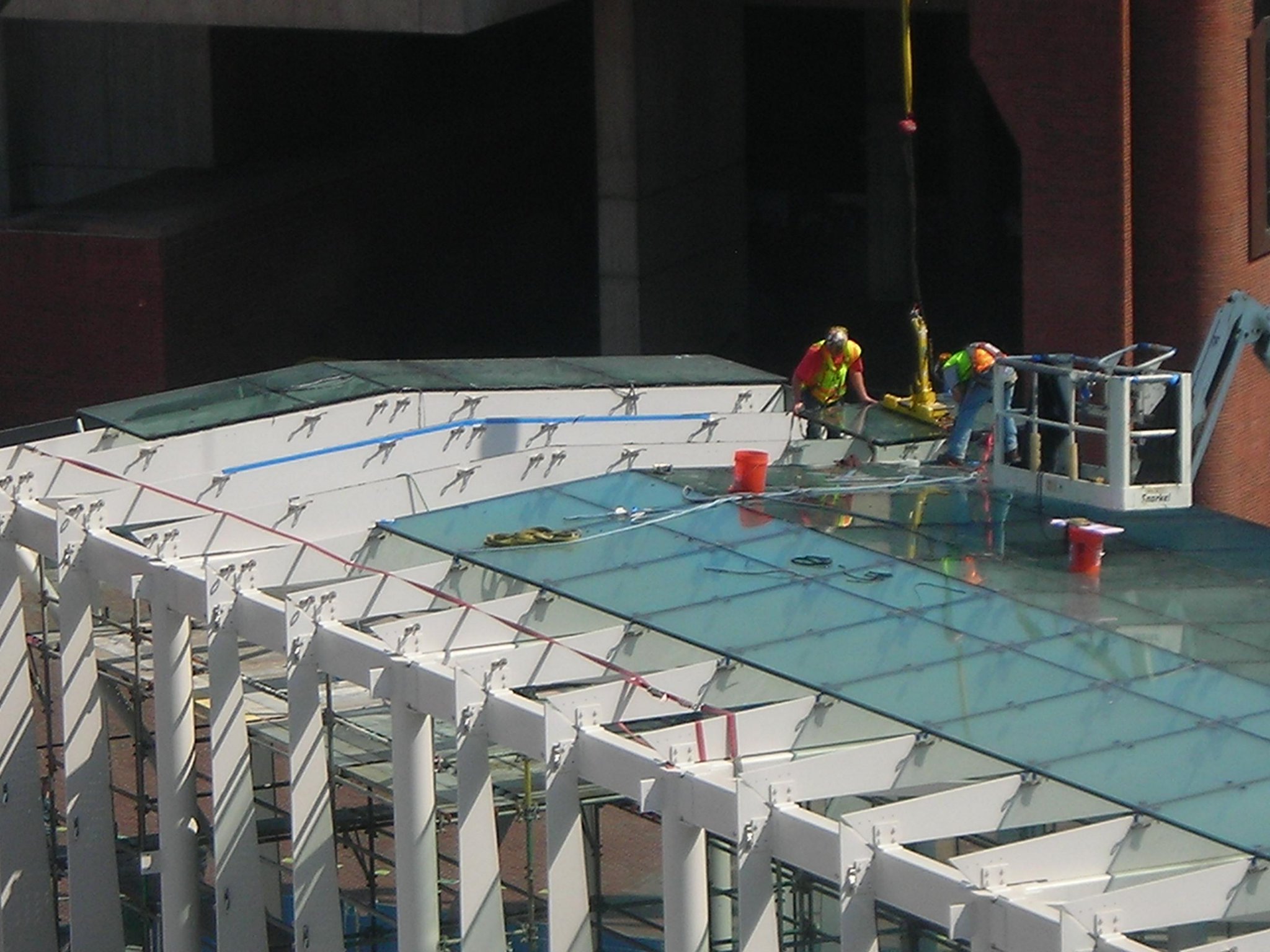

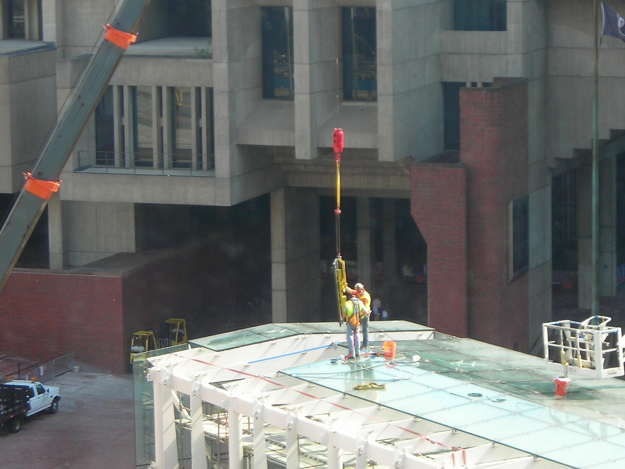

Glass replacement has begun:
https://twitter.com/mike_kix/status/641256442553569280
