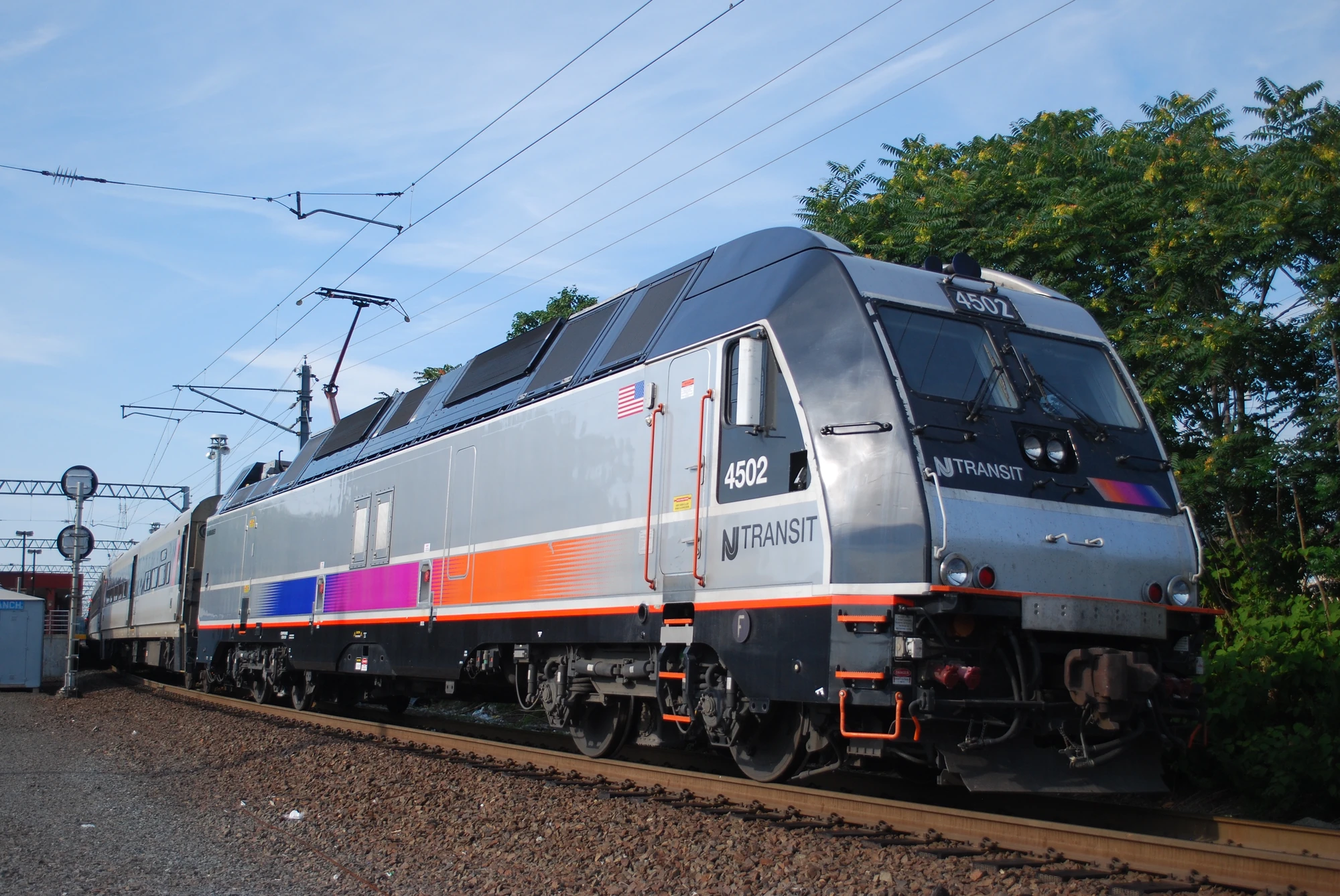

NJ Transit uses dual mode loco's on lines where they run on overhead catenary on their "main" lines, and switch to diesel power when they get to the branch lines where the catenary lines don't exist. It would solve the problem of not having to electrify the entire commuter rail network quite nicely, or at least provide a solution to buy the commuter rail network the years needed to electrify everything.
That said, these dual modes cost more than your typical diesel powered or catenary powered locomotive, so it might be better just to bite the bullet and start a full changeover.
