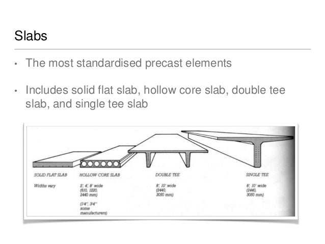

Not sure if it's double-T construction or not, but garages are typically lots of pre-cast panels and pieces that arrive and are assembled quickly on site.
The double-t's have all penetrations pre-cored.
Garage construction is down to a science pretty much. Which makes sense since they are done at minimal cost.
It's double-tee.

But for those actually interested in the double-tee, it's called such because it quite literally looks like two T's put together:
a-study-on-the-construction-process-precast-concrete-insitu-cast-concrete-shoring-underpinning-7-638.jpg
^ Double tees are used over single tees because the web can be considerably shallower in double tees, which is crucial for maximizing floors of parking. On a single tee precast beam, the web needs to be deeper in order to achieve the same structural strength.
