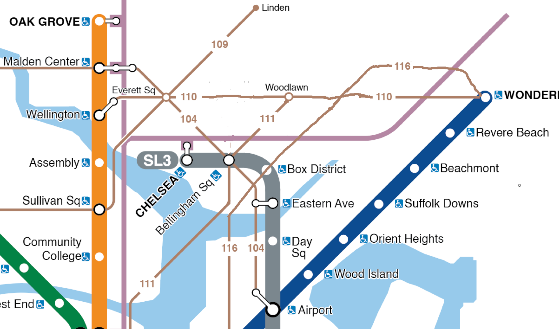

I don't know how you feel about compound curves, but You may be able to create some more space in that gap if you bend Green and Orange together to the West, shifting N. Station westward, having Orange bend back to the north to create separation for Community College. You could also repeat that - bend the OL back westward such that CC parallels Lechmere, and bending it back northward for Sullivan and beyond.

Also, while I'm looking at this bit of the map, maybe move the Union Sq branch further down the line? Where it is now feels too close to the Charles yet too far from Harvard.
I have moved the Union Sq branch up a lot since that revision to (try to) make the 47, 96, and 109 all work out. I think (🤞) I have all the bus routes worked out nicely now so hopefully that should speed up progress quite a bit.

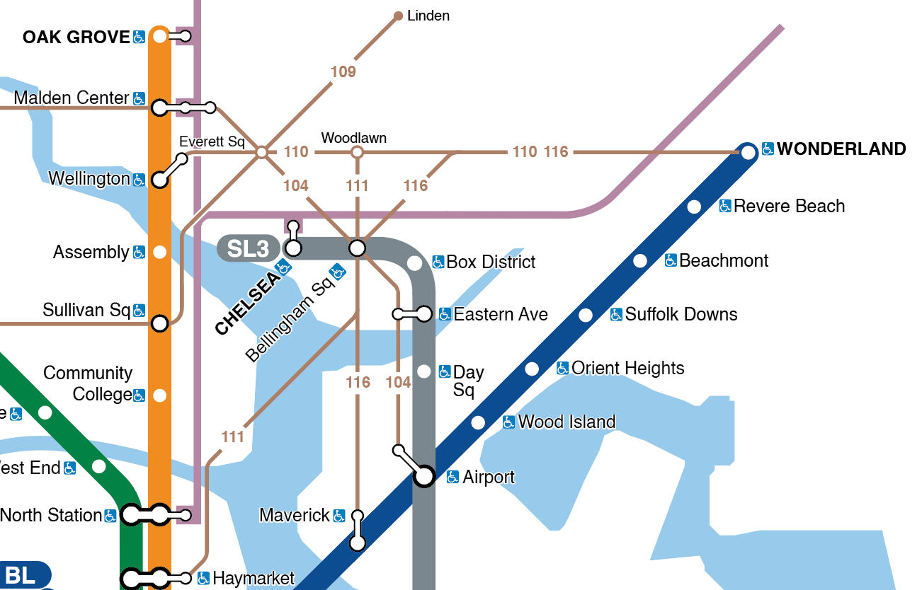

I'd be lying if I said I wasn't regretting trying to get all the BNRD key bus routes on here. If anyone has any suggestions for making this look less awful I'm all ears.
To be honest, I actually don't think this looks that bad, at least if you are intent on reusing the existing map's visual language (which I think has fundamental flaws, but I see the appeal of.)
In general, I think you could stretch things upward into the whitespace. I was gonna try to write out suggestions, but realized it might just be faster to draw with a stylus (forgive the messiness):
(Yes, I know the 116 is slightly closer to Box District, that was a compromise needed to make the bus transfer hub at Bellingham Sq/Chelsea City Hall work. It's close enough that I don't consider it a major inaccuracy.)
Actually pretty strongly disagree with you on this one. The 116 is an easy 2-minute walk to Box District; it's a much more annoying-looking 7-minute walk to Bellingham Sq station. I think they need to be shown separately.
It's about 3 minutes walking, about the same, maybe slightly further, than the walk from the next stop up to Box District. (Although if anything I think the main point this brings up is how bad the transfers are to the SL3)

I suppose a bit more geographic accuracy here is probably warranted, and that makes the node at Revere Center clearer.
Oops, you're totally right -- I didn't think to measure from the City Hall stop, only from the Greenway. I think the line-of-sight transfer at Box District is still probably friendlier, but you're absolutely right.

Looking at your previews it seems like you've gone with a parallel lines approach which seems like it makes congested areas like Longwood more clear at the expense thinner lines that are less clear everywhere else, I might try either adopting or adapting that approach. Different colors for the bus routes would also help a lot but I'm not really sure how to color code that in a way that makes any sense.
I've been cagey about showing full previews because of how experimental (and currently unsatisfying) my efforts are, but yes, my current attempt uses one line per service (mostly -- 71/73 are almost certainly going to be consolidated, as will the cumulative corridors in Quincy, Point-of-Pines, and Roslindale). Originally I actually went with relatively thick lines for all key BNRD routes, which certainly made for a very busy Dorchester, but worked better than I expected in a lot of ways. (There are lots of small details not yet included here, including transfer bars, some more careful details at line-ends, and bus route labels.)
However, on the northern end of the map, this approach just gets too crowded. So now I am experimenting with thinning most of the routes, but keeping the highest frequency routes in this thicker style.
I had been using a thin white line down the middle of the bus route (the way TfL shows its mainline routes), but it's possible that I can get away without it in this "thick + thin" framework -- I'm not sure.
My gut says that the no-line version ultimately won't be distinct enough; on the other hand, I want to make sure I don't make it look like there are, e.g. two parallel thin routes that both just happen to go from Ruggles to Ashmont on the same route. I think I may be able to use the stop indicators to resolve the ambiguity; I haven't gotten to it yet, but my plan is for the thick routes to have the white line down the middle with white circles for stops (as in the first example above), and the thin routes to have colored circles for stops.
To your question about color-coding, I am continuing to experiment with coloring routes based primarily on the hub they terminate at -- Ruggles routes are orange, Kenmore + LMA + Copley routes are green, Harvard + Kendall routes are red, etc. I think this has proven the most helpful in Dorchester, but again struggles a bit in the northern half of the map, where there are more criss-crossing orange routes and red routes.
But, to your last point about finding an approach that makes sense, the official bus map uses a random (pseudo-random) coloring for its bus routes, which... I dunno, maybe is worth trying? (I also wonder if there is anything to draw from the four-color theorem here.)
This speaks to something I realized late last year when working on my previous redesign: sometimes the physical geography of the network actually provides the most parsimonious solution for creating a simplified diagram. Like, yeah... sometimes you need a line that hits 3 different points while avoiding 3 other points, and sometimes the real-world geographic version of that line is actually the simplest way to draw it (even if you aren't actually aiming for geographic fidelity).

Shouldn't the 110 be aligned directly at Revere Beach Station of the Blue Line? Also the 116 in the north should be 1 stop further north than Wonderland (but 1 stop south of Oak Island if BLX ever comes). Wonderland is in the middle of the pit between Revere St. and Beach St and doesn't hit either street.
That's a good point -- the BNRD system map makes it look like there isn't a good transfer, but it definitely would be reasonable enough to show.
Fair enough, but I personally think that's the sort of thing that can be simplified out of a diagram like this, if needed for simplicity.

I had to completely rework my northeast quadrant this morning to get the 110 to connect to both Revere Beach and Wonderland. On the plus side, though, I think it does actually look better now, so at least there's that!

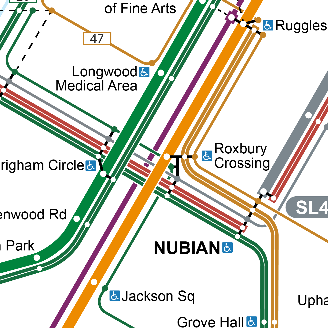

Obviously a ton of work's gone into this, so I'm a touch hesitant to immediately dump a bucket of cold water, but I'm getting major NYC Subway map vibes, and not in a good way.
The double-thickness bus routes concept is, I think, quite a good way of visually indicating something that's more than standard bus service, but not officially rapid transit. But I'm struggling with that concept mixed with the decision to color the bus routes by hub. It makes it easy to get confused and think that those are some kind of transit lines, especially if you're looking at a smaller version of the map, or are unfamiliar with the system. I get for wayfinding purposes it's better that the bus routes aren't all the same color, but I wonder if there's a solution that doesn't so closely resemble the colors of the transit lines.
I think you did a really good job, especially with how nightmarishly difficult it is to try and deal with both the Green Line branches and the northeast quadrant of that map in a (partly) geographic map, but it kind of reinforces the comparison to the New York map (which distorts the shape of the city pretty good). You've done an excellent job trying to force-fit the lines into the geography, but it's still kind of a visual mess, because the geography is so messy. To me at least part of why the original spider map worked so well was that it was really mainly just a schematic map that didn't much care about the geographic particulars, which made it a lot more straightforward to use and understand. I get you're trying to include a lot more information, and you've done it well, but the impression I get at first glance is a bit of 'information overload' - but considering your project objectives, I think it's really cool.
(And if we're nitpicking, are the bus route numbers meant to be in a different font? It's obviously not Helvetica in a way that is absolutely meaningless from a functional standpoint but that immediately stands out to me, so I kinda have to ask.)
You're very considerate, and I appreciate it! The comparison to NYC seems apt, for better and worse, in part because of this:
I am also a huge fan of the original spider map. I'm sure it will always be among my top favorites. But... the spider map omitted a huge quantity of information. Just straight up removed it from scope, most notably almost all of the stations on the D Branch (along with the surface stops on the B/C/E plus Mattapan which today's map opts to show). The spider map also was not designed to accommodate a "branching" of its central orange line (i.e. into the SW Corridor + Silver Line), nor transportation in the Seaport. It does not accommodate the Fairmount Line.
If you start to exclude as much as the spider map did, you get something that looks more like this (really rough sketch, just for the purposes of conversation):
In some ways, the potential for mistaking the bus lines as branches of the rapid transit lines was not totally unintentional. I'm tacitly arguing that, e.g. the 1 should get just as much publicity as the Red Line.
Adjusting the colors of the bus lines is an interesting idea though. I've been hewing to the official diagram colors for the most part, but it would be interesting to see what kind of difference that might make. Were you thinking slight adjustments like Red -> Pink, or more extreme like Red -> Lime?
Not intentional. Hopefully something I would have picked up eventually in proofing!
I like the double-line effect giving, effectively, greater presence to the bus lines, and thus more emphasis than the decidedly secondary treatment they get from the official map, and I get the intention of having them get put on a similar plane. That said, because of that plus the colors, I think there's a significant prospect of confusion, particularly because the buses generally don't share the same parts of the stations.
I'm not entirely sure how to solve it, because there's only so many colors. I wonder if something like a desaturated color variant would work. So, orange-bronze for the orange-hub buses, a more muted red, a greyer green, that sort of thing. Maybe lighter silver for the silver line (sort of like the difference between the shuttles and the L train in New York)?

I've made some more (slow) progress on my map as well, and I think the thinner lines have worked wonders to making bits like Dorchester and Chelsea more legible:
That is also a damn fine map, nice! I particularly appreciate the consolidation of lines/curves/angles -- it makes the system "feel" simple, in a way that reminds me (positively) of the WMATA map. I think the northeast looks solid (small quibble in that the E in Everett is hard to read against the purple). I think Dorchester is looking good, but is revealing some of the fundamental limitations created by not having Orange and Silver be parallel; Nubian and Roxbury X'ing are very close together IRL, and moving them apart in turn limits the available space in Dorchester for the more complicated bus network.
On a different note, I made a proof-of-concept of my map with thinner bus lines. Loses some of that political statement, but undeniably looks cleaner.
I wouldn't say that's clean. It still looks like someone spilled a bowl of spaghetti on the map. The edges of the map feel very cramped, especially the top right. If you must have all this information on the map, then at least enlarge the canvas and give this information room to breath.
Getting Everett Sq to work out at all was a miracle, whenever 3 lines meet it's always a nightmare getting the spacing to work, so that is a sacrifice I'm willing to make.
It's a blessing and a curse. The Silver Line doesn't have that neat 'every other parallel stop' symmetry that the GL-E does with the OL, so pushing them closer makes things... difficult. Plus it would require making the SL extra bendy and as you have indeed figured out, that's exactly what I'm trying to avoid.

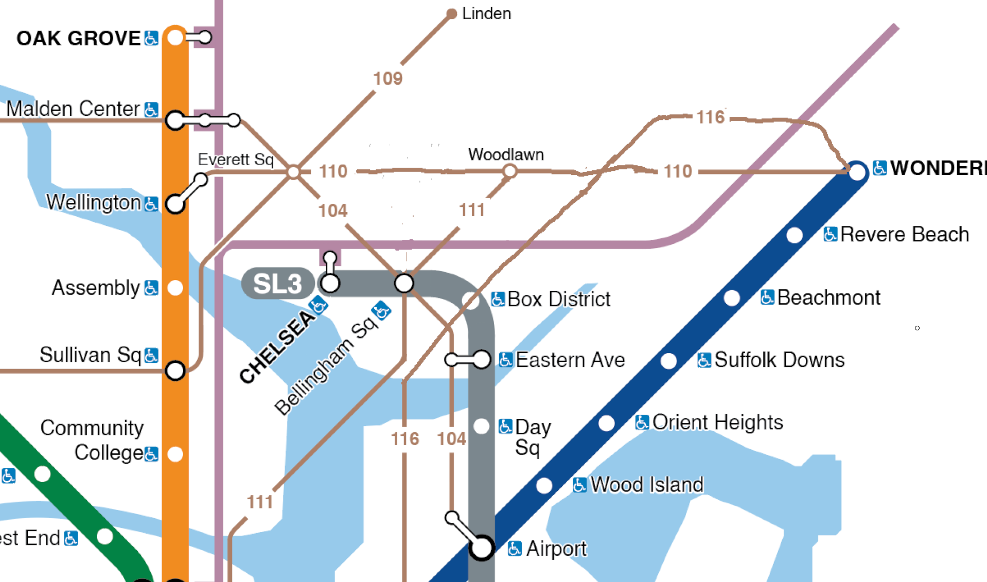

The 111 is incorrectly drawn is going via Charlestown even though the 111 has ZERO stops in Charlestown.
It is extremely misleading for riders, especially newcomers. Imagine if someone wanted to get to the USS Constitution or the Bunker Hill Monument, only to be taken across the highway to the other side of the Mystic with no way back to Charlestown without going all the way to Encore Casino or to Downtown Boston.
I need to repeat this again, the 111 makes ZERO STOPS in Charlestown. This is the only FBR bus route to have an "express" portion.
The 111 is technically an "express bus" since it makes stops in suburbs outside of Boston and then proceeds to drive directly to downtown Boston. As quoted from the MBTA bus guide:
Local Buses only travel within Boston and the communities in the immediate area. Express buses make stops in suburbs and communities outside the city and then drive directly to downtown Boston.
Read that carefully. Doesn't the 111 fit this description of "express"? I think it does. The first stop off the 111 inbound past the highway is just across the street from North Station. In the outbound direction, the last chance top get on or off the 111 is also, just across the street from North Station. After that, the 111 expresses directly to Chelsea.
The MBTA system map is notorious for it's inaccuracy of the 111, but it's a slap in the face that almost NONE of the user fan made maps ever fix this horrible inaccuracy. This inaccuracy even extends to analysis of frequent transit coverage; including from the MBTA itself. Charlestown is incorrectly shown as having frequent service in the MBTA's state of the bus system, even though it doesn't.
The correct way to display the 111 is either to:
A) cut the 111 route in half (i.e. cut off the 111 at the Tobin on ramps, and the North Washington Street Bridge). This is best suited for frequency coverage maps
For spider maps and subway diagrams, other ways to display the 111 could be:
B) Draw the 111 as cutting across Boston Harbor instead of Charlestown
This has a benefit of allowing the line to simply use existing lines, as it is only merely rerouting the line to run across the harbor. It also better reflects the 111 running express to Chelsea
C) Use a dashed line for the 111 between Chelsea and North Station
This allows the existing 111 route to display in it's existing route through Charlestown, but indicates it is an express bus. This requires a footnote somewhere explaining why the line is partially dashed, though; unlike every other bus line.
