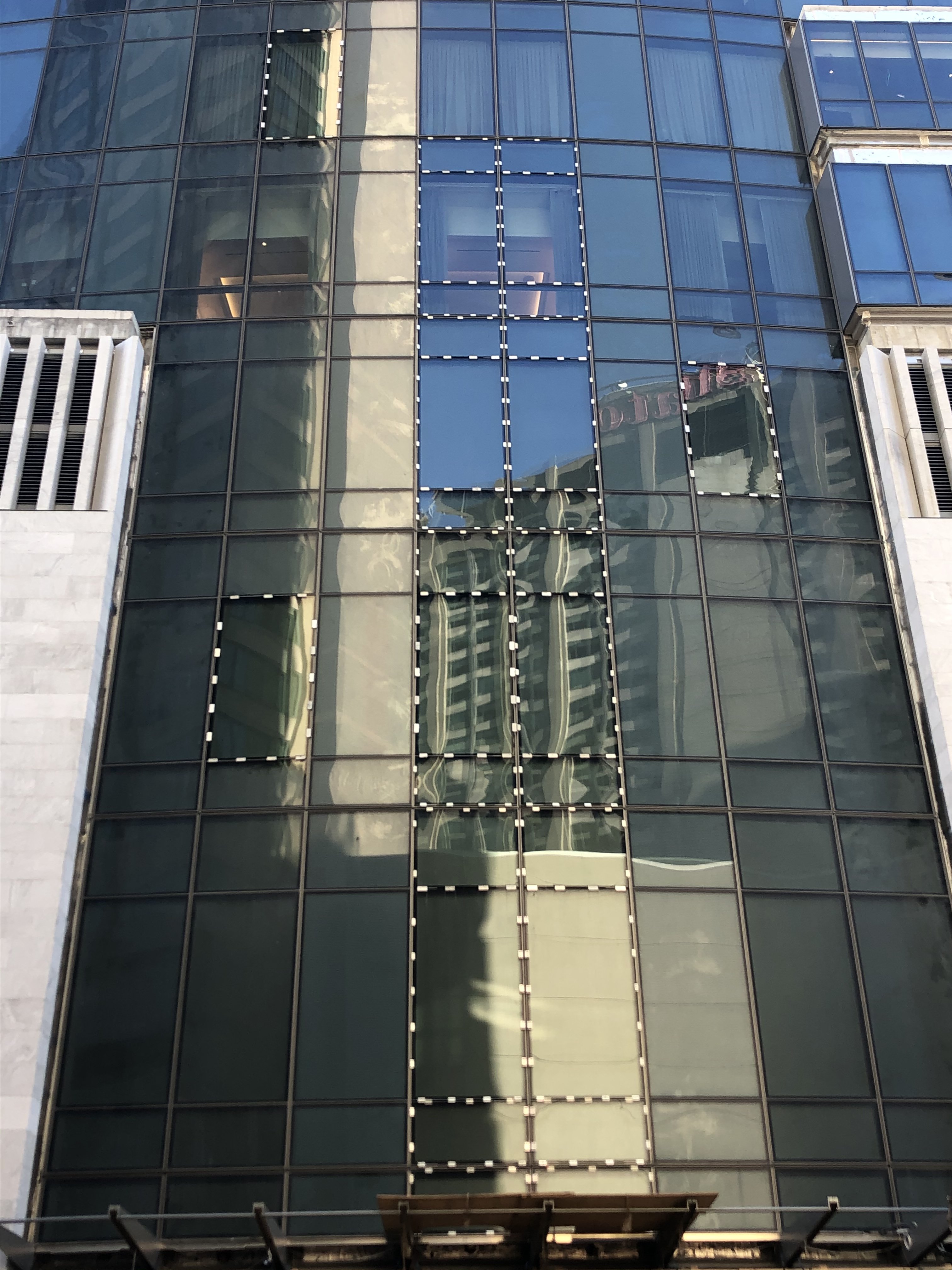

More glass went in yesterday. One panel goes in per day when the weather cooperates. Caulk takes 21 days to settle which is why you see the silver clamps for an extended period after the install. Hoist takes 45 mins-1 hr. to lower from the roof and then re-raise which makes the process take forever.
Could be another month and a half or so to finish the glass if weather cooperates.
I took this close up of this caulking/clamping [ process on February 21st.

This is awesome info and the kinda stuff I don't think is easily found anywhere other than AB. Here's my follow-up quetion, though: While I don't doubt any of your explanation (thanks again), I'm confused as to the "One panel goes in per day when the weather cooperates" comment. If that holds true for the whole building, wouldn't more than half of the tower's "windows" still be plywood (or nothing at all) at this point? I haven't gone and counted each window on 1 dalton, but it looks like roughly 18 windows per side x 3 sides x 61 floors which would = 3294 windows. If only one window can go in per day (when the weather is being cooperative) wouldn't it have taken 8ish years to clad the whole thing?
Chrisbrat -- I think the 1 window per day only applies to the current situation when the proper tools to do the job en masse have been put away.
No crane on top, not even a construction elevator on the outside. You have to get the huge glass panels up by means of a service elevator inside the building.

That was my best guess, but thanks for confirming (or at least agreeing). Much appreciate cjbski's info, regardless.
